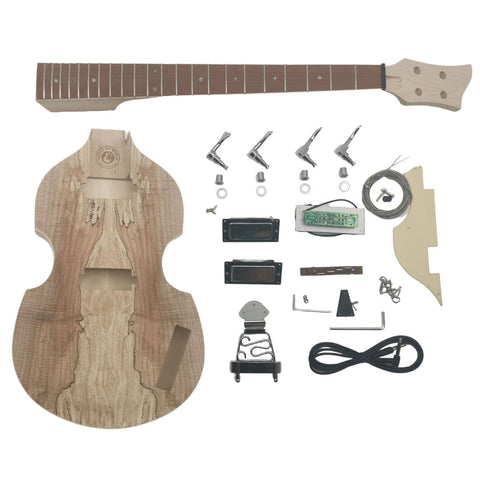

Parts List
Below are the parts you will find included in your packaging to complete a Violin Bass.
  • Prepped DIY Bass
  • Completed neck
  • 2 x Strap buttons
  • 4 tuners (4 string bass)
  • Floating Bridge with Trapeze
  • 2 x mini humbuckers
  • Control board with 2 Volume, Bass, Rhythm, Treble
  • Truss rod cover and pick guard
  • Guitar Cable Cord
  • Hex wrench (for adjusting truss rod)
  • Assorted screws and washers

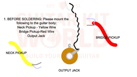

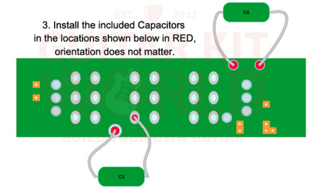

3. Connecting the electronics
Connecting the pickups to the input jack, and incorporating a pickup selector and volume and tone potentiometers.

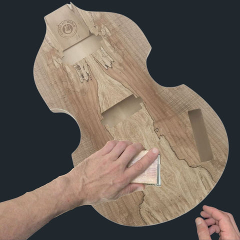

1. Preparation and finishing
Inspecting the body
Once unboxed, carefully inspect the guitar body and neck under decent light.
Identify problem areas, as these should be addressed early on before commencing the project.
This includes large dents that require filling, deep scratches that require sanding and glue residue on the surface of the guitar that will prevent your finish from being absorbed evenly.
Glue stains will only be a potential issue for guitars with binding, and/or a veneer top.

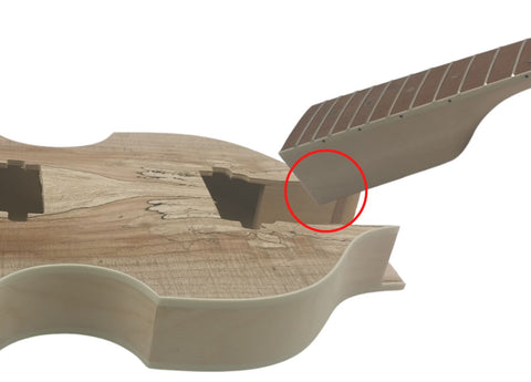

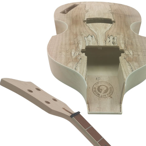

Dry fitting the neck
Insert the Neck
First push the heel gently into the back of the neck pocket, then push the neck
down flat.
This reduces the risk of chipping the thin edges of the neck pocket before the neck has been installed.

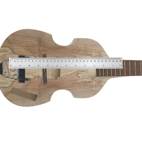

Check the scale length
You can check the location of your bridge post holes with regard to scale length by measuring the distance from the edge of the nut closest to the fretboard and the middle of the 12th fret and then doubling that number.
If your scale length appears out by a few mm, keep in mind the position of the bridge is angled to compensate for the additional mass of the thicker bass strings and the saddles can be adjusted forward or back via the intonation adjustment screws.
Check the neck alignment
The neck, once inserted into the neck pocket, should have very little sideways movement. If it does, mark the center on the neck heel and align this with the center of your neck and bridge pickup cavities.
If this results in a gap on either side of the neck, you may need to shim the neck by cutting small sections of scrap wood with a craft knife and gluing these to the sides of the neck pocket.
Otherwise smaller gaps can be filled prior to finishing using a filler.
Check the neck angle
Keeping the bridge and steel ruler in place after checking your neck alignment, run the steel ruler along the fretboard and over the bridge. The steel ruler should sit just above the saddles on the bridge when the bridge is sitting flat against the body.

Setting the Neck
You can install the neck once you have completed the finishing stage, but construct a handle from a section of scrap wood. This will allow you to handle the guitar when finishing.
  1. Clean out the neck pocket and heel of the neck. Remove any dust using a brush and ensure the neck cavity is clean.
  2. Using a paint brush apply PVA or similar product evenly on the bottom of the neck pocket and the neck heel. Ensure you have an even coating on both surfaces.
  3. Clamp the neck to the body of the guitar. You can use one, but two clamps is recommended. Ensure you have scrap wood on hand to protect the surface of the guitar when clamping and clamp firmly.
  4. Follow the product recommendations with regard to when you can safely remove the clamps and handle the guitar. In most cases leaving the guitar overnight will suffice.
Prepping the body
Check the body carefully again for glue stains. In most cases glue stains can be sanded out but if you notice stains on a veneer top, keep in mind the veneer is quite thin and you should first try to remove with a small amount of warm water and a clean rag.
Next we’ll move onto prep sanding the body and neck.
  1. Start by sanding the entire body using 180 grit sandpaper
  2. Follow that up with 240 grit paper. If you are applying a stain directly to the raw wood sand up to 400 grit, but sanding any smoother than this may begin to affect how well the stain is absorbed.
  3. Once you have completed sanding up to 240 grit, wipe a small amount of moisture on the surface of the guitar. Using denatured alcohol is a good option here as it evaporates before it is absorbed into the timber, but water will also suffice. This will raise the grain of the timber which can then be sanded flat.
Generally grain will only raise once, so you can be confident you won’t have any problems during the finishing process.

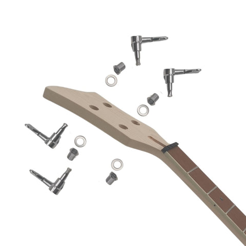

Installing the Tuners
Depending on the headstock type and configuration of the tuners, you will need to first separate your tuners into left and right.
  1. Start by inserting the tuner in the back of the headstock with the mounting hole facing back toward the body.
  2. Place the washers over the tuning posts, then place the bushings and install the tuners by hand tightening.
  3. Align the tuners using a steel rule (see image below).
  4. Mark the location of the mounting screws, drill your pilot holes and install the small screws.
  5. Remove the protective covering by firmly pressing masking tape onto the back of each tuner and removing both the covering and masking tape in one action.
Align tuners using a steel ruler. You can also install the first and last tuner, and
using a steel rule mark a straight line between them on masking tape to mark
out the location of the pilot holes.

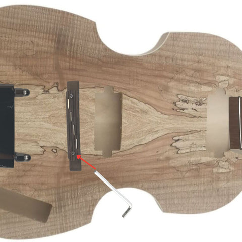

  6. Screw the bridge posts to the bridge bushings and the tailpiece posts to the tailpiece bushings.
  7. You can then fit the bridge over the bridge posts, but leave the tail piece for now as it will not remain in place until the strings are installed.

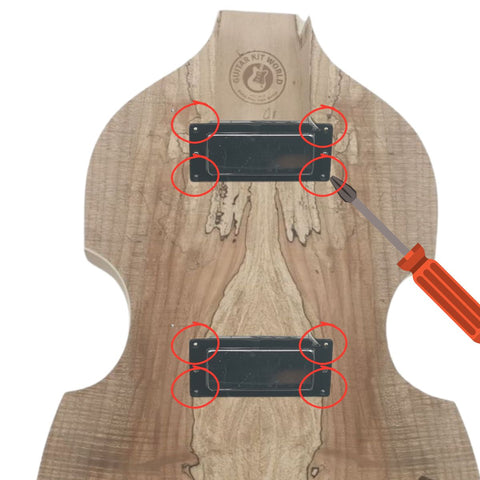

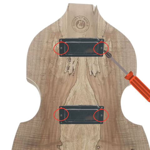

First, identify the neck and bridge pickup. You can easily tell them apart by the profile of the pickup surround.
The pickup with the deeper pickup surround is the bridge.
  1. Taking either pickup to begin, position the pickup so the pickup wires are adjacent to the top right corner of the pickup cavity.
  2. Thread the pickup wires through the channel below the pickup cavities until the wire can be seen through the lower F hole.
  3. Using a pair of needle nose pliers grab the protruding wires through the F hole. (You can then mask them to the side of the body if you like)
  4. Install the strings (both the low E and high E string will suffice).
  5. Position the pickups at the very front of the pickup cavity and then align them horizontally to the individual pole pieces corresponding to the low E and high E. (you can also use a square to check the alignment relative to the edge of the fretboard).
  6. Mark your pilot holes as done previously, remove the pickups from the cavity, and drill the pilot holes.
Soldering
If you haven’t soldered before you’re going to need a soldering iron, solder, and a damp sponge to clean the tip of your iron. I’d also recommend practicing before committing solder to your electrical components.
Most entry level soldering irons will do the job, and your kit will come with more than enough solder.
Be careful when soldering. Solder won’t melt until it reaches 185°C (365°F) and soldering irons get very hot, up to 392°-896° F in some cases.
1. Tinning
Tin your soldering iron and the components you are connecting to. Tinning refers to maintaining a light coating of solder over the tip of your soldering iron and prevents the iron tip from oxidizing.
2. Preheating
Soldering is really about transferring heat. The lug or component you are connecting to should be preheated so the solder is drawn to it rather than staying on the already hot iron.

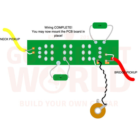

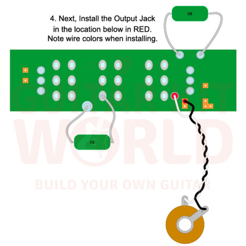

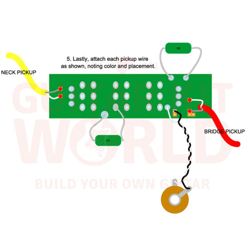

Wiring
Most of the electronics for kit guitars come pre-soldered, with the exception of the wiring that needs to pass through the cavities within the body of the guitar.
When soldering, remember to keep your soldering iron tinned, along with the components you are connecting to. Apply heat directly to the lug you are connecting the wire to until you have transferred sufficient heat to the lug, then feed some solder onto the joint.
Remove the iron, allow the solder to cool and then test the connections you have just made by gently pulling on the wires.
The connections will need to be strong to facilitate dragging into place through the interior of the body.

Adjusting neck relief
The ideal guitar neck is one that has a small amount of inward bow or relief to provide clearance for the strings when vibrating. A neck that is too straight will very likely run into problems with fret buzz.
You can measure the straightness of the neck using a steel ruler. I prefer to hold down the first and last fret and then tap the 12th fret lightly of the low E string. If the string is already sitting hard against the fret more relief is required. If sitting well above the fret, the amount of relief can be reduced.
To adjust the amount of relief, adjust the truss rod using the hey key included in your packaging. Turn counter clockwise to loosen the truss rod which will introduce more relief. Turn clockwise to flatten the neck further.
Remember to only make incremental changes of ⅛th to a ¼ turn each time and make sure the guitar is tuned to concert pitch so the correct amount of tension from the strings is placed on the neck.
Be sure to continue to check your tuning through the entire setup process.

Action is adjusted at the bridge. Loosen the bridge posts to raise the action, tighten the bridge posts to lower the action.
