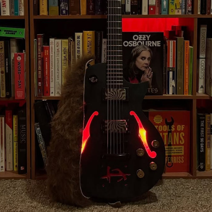

Bill Antonitis had never carved wood when he bought a chisel set from Home Depot, printed a stencil, and cut a rune into the top of his first guitar kit. He also turned spent shotgun shells into control knobs, dropped magnet-mounted LEDs into the f-holes, and found out mid-build that a semi-hollow has no control cavity.Read now -

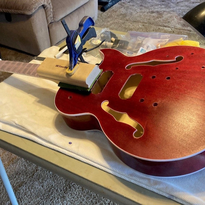

"It Breathes": Why This 80-Year-Old Leaves a New Kit Boxed for a Week
Byron Stafford is 80, lives in the mountains of northeastern Arizona, and has been building guitars since 1956. He wrote us this piece on wood, patience and abrasives, illustrated with photographs of his own builds from 1958 to this year.Read now -

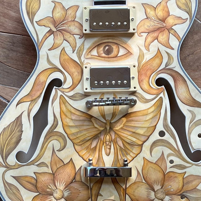

Colored Pencil, No Stain: Drawing a Guitar Top on Bare Flame Maple
Most builders finish a flame maple top with stain or nitro. Peter-John de Villiers drew on his instead, in colored pencil, straight onto the bare veneer of our semi-hollow double-cutaway kit.Read now
