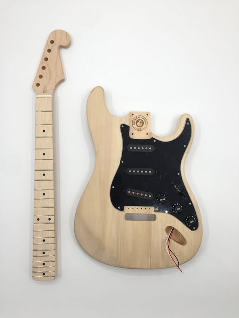

Just like the TE kit above, the ST-style guitar kit is one of the simplest kits to assemble.
Featuring a pre-loaded scratchplate, most of the soldering work is already completed leaving you just the input jack wiring to complete.
Recommended: How to Wire a Stratocaster® Guitar Kit
While the body does include a small amount of contouring, much of the body is flat and simple to sand and prep for painting or staining.
