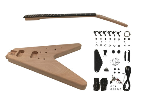

Below are the parts you will find included in your packaging to complete a Hollow Body Guitar.

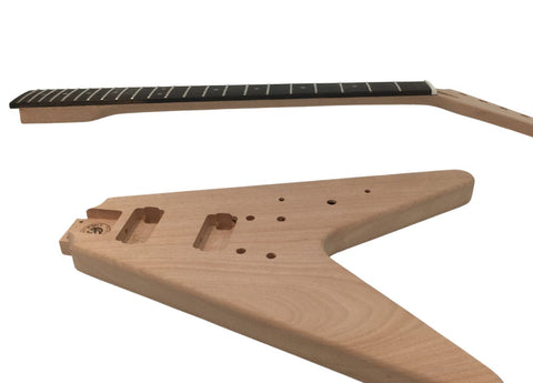

OnceĀ unboxed, carefully inspectĀ the bodyĀ and neck under goodĀ light.Ā Ā
Ā
Ā Identify problem areas, as these should be addressed early on before commencing theĀ project.
This includesĀ large dentsĀ that require filling, deep scratches thatĀ require sandingĀ andĀ glue residueĀ on the surface of the guitar that will prevent your finish from being absorbedĀ evenly.Ā
Glue stains are only a potential issue for guitars with binding, and/or a veneer top.Ā
Once you have identified problem areasĀ you can begin prepĀ sanding the guitar.Ā

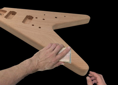

Start by sanding the entire body usingĀ 180 grit sandpaperĀ
Follow that up with 240 grit paper. IfĀ you areĀ applying a stainĀ directly to theĀ raw wood sand up to 400 grit, butĀ sanding any smoother than this mayĀ begin to affect how well the stain is absorbed.Ā
Once you have completed sanding up to 240 grit, wipe a small amount of moisture on theĀ surface of the guitar. Using denatured alcohol is a good option here as it evaporates before itĀ is absorbed into the timber, but water will also raise the grain of the timber which can thenĀ be sanded flat. Generally grain will only raise once, so you can be confident by taking care ofĀ it now, you won’t have any problems during the finishing process.Ā Ā

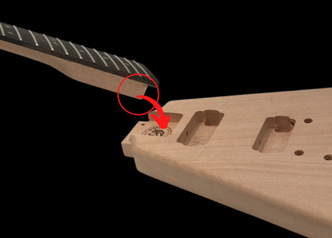

Dry Fitting the NeckĀ
You should also check the neck fit. Most hollow body guitars are set necks and would sometimes have a tighter neck pocket than a bolt on.Ā it’s important toĀ dry fit the neck and check how well it fits the neck pocket, along with neck alignment, neckĀ angle and scale length.Ā
Insert the NeckĀ
FirstĀ push the heelĀ gently into the back of the neck pocket, then push the neck down flat.Ā Ā
Check the scale lengthĀ
You can check the location of your bridge with regardĀ to scale lengthĀ by loosely installing theĀ bridge and measuring the distance from the edge of the nut closest to the fretboard and theĀ middle of the 12th fret and then doubling that number.Ā
V-styleĀ kits usually have a scale length of 24.75" or (629 mm)
If your scale length appears out by a few mm, keep in mind the individual saddles can beĀ adjusted forward or back via theĀ intonation adjustmentĀ screws.Ā

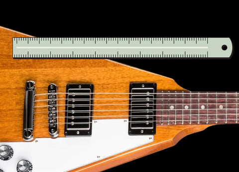

Check the neck angleĀ
RunĀ a steel rulerĀ along the fretboard and over the bridge. The steel ruler should sit just aboveĀ the saddles on the bridge when the bridge is sitting flat against the body.Ā Ā

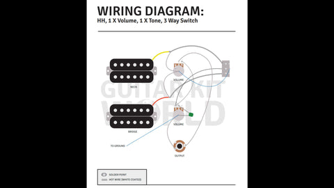

3. Connecting the electronics
HH, 1 X Volume, 1 X Tone, 3 Way SwitchĀ (PDF)
If you haven’t soldered before you’re going to need aĀ soldering iron, solder, and aĀ dampĀ spongeĀ to clean the tip of your iron. I’d also recommend practicing before committing solderĀ to yourĀ electrical components.Ā

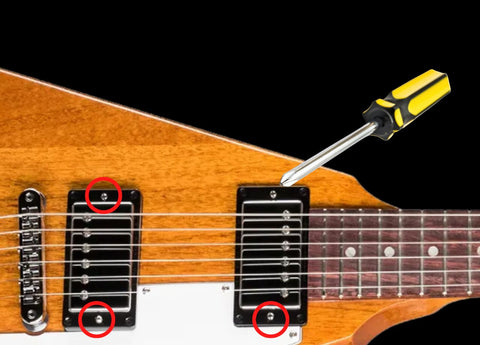

Adjusting pickup heightĀ
Lastly, we’ll check andĀ adjust the pickup height. Much like string action, the height of yourĀ pickups is mostly subjective and will depend on what you are hearing.Ā  Ā
The DIY guitar by Bryan Pratt
But, if unsure a good starting point is 2.4mm from the top of the magnetic pole piece to theĀ underside of the string. However, this should be measured when pressing down the last fretĀ of the guitar.Ā
