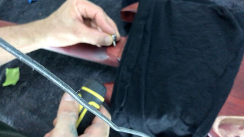

Pilot Holes
Drill pilot holes for all screws used on the body and neck of the guitar. The small
screws used for securing your tuners for example are small, fragile and easily
stripped.
Whenever installing hardware:
  1. Use masking tape on the guitar to mark the location of the hole using a pen (pencils usually don’t result in sharp lines on masking tape)
  2. Mark the location of the hole making an indentation in the wood through the masking tape using a hole punch or similar tool
  3. Decide on the correct size drill bit (⅔ thickness of the screw) and mark the drill bit depth using a small piece of masking tape at approximately 2/3 the depth of the screw to be installed
  5. Use a countersink drill bit (or similar) to chamfer the edges of any holes in the body of the guitar, especially if painted using a solid color finish, to prevent chipping.
You may want to drill less than ⅓ depth on less dense timbers such as Mahogany and Basswood.
Installing strap buttons
Strap buttons not only support your guitar when playing standing up, the
placement of the strap buttons also affects the balance of the guitar.
installing strap buttons
On a G-style guitar, the rear strap button is located in the center of the lower bout.
The front strap button is either inserted into the top horn on a downward facing
angle, or installed on the back of the neck heel, which is what we have done
in the example above.
Follow the method described above for all hardware installation including using painters marking tape for marking the location of pilot holes, and drilling to the correct size.

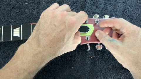

Installing the truss rod cover
While not strictly hardware, it’s important to center the truss rod cover
on the headstock.
installing truss rod cover
The simplest way to do this is by using masking tape on the headstock,
measuring half way across the headstock (the guitar has a nut width of 42mm, so the number should be 21mm) and drawing a line extending out from
the nut to the end of the headstock.
You can then align the truss rod cover with the nut and center by lining up the hole at the tip for the truss cover with the centerline.

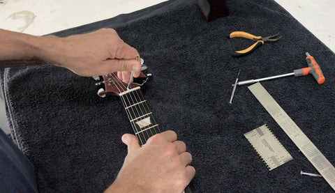

Installing the Tuners
G-style guitar kits utilize 3 per side tuners, so you will need to first separate your
tuners into left and right.
  1. Start by inserting the tuner in the back of the headstock with the mounting hole facing back toward the body.
  2. Place the washers over the tuning posts, then place the bushings and install the tuners by hand tightening.
  3. Align the tuners using a steel rule (see image below).
  4. Mark the location of the mounting screws, drill your pilot holes and install the small screws.
  5. Remove the protective covering by firmly pressing masking tape onto the back of each tuner and removing both the covering and masking tape in one action.
Align tuners using a steel ruler. You can also install the first and last tuner, and
using a steel rule mark a straight line between them on masking tape to mark
out the location of the pilot holes.

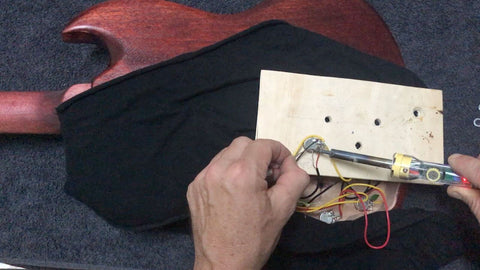

Connecting the pickup wires
Next, we’ll warm up our soldering iron and connect the pickups.
connecting the pickup wires
Taking the wire from the neck position on the pickup selector (the top position) insert the end of the shielded wire through the input lug eyelet (the leftmost lug if facing away from you) and secure in place.
Warm up the lug by placing the soldering on it for a few seconds before adding some solder between the lug and the wire, once the lug is hot enough, the solder will melt.
Once cooled sufficiently the wire should be connected to the lug. You can then test the connection by gently pulling on the wire.
Follow the process above to connect the unshielded ground wire to the back of the volume pot casing. And then repeat the process for the bridge controls.
Your wiring is now complete. You can now test the pickups by inserting a cable from an amplifier and gently tapping the pickups. If something isn’t working, check the wiring diagram above. If you notice the guitar is particularly noisy, it is likely to be a problem with your ground circuit (the black wires).

Adjusting neck relief
The ideal guitar neck is one that has a small amount of inward bow or relief to provide clearance for the strings when vibrating. A neck that is too straight will very likely run into problems with fret buzz.
adjusting neck relief
You can measure the straightness of the neck using a steel ruler. I prefer to hold down the first and last fret and then tap the 12th fret lightly of the low E string.
If the string is already sitting hard against the fret more relief is required. If
sitting well above the fret, the amount of relief can be reduced.
To adjust the amount of relief, adjust the truss rod using the hey key included in your packaging. Turn counter clockwise to loosen the truss rod which will introduce more relief. Turn clockwise to flatten the neck further.
Remember to only make incremental changes of ⅛th to a ¼ turn each time and make sure the guitar is tuned to concert pitch so the correct amount of tension from the strings is placed on the neck. Be sure to continue to check your tuning through the entire setup process.

Adjusting pickup height
Lastly, we’ll check and adjust the pickup height.
Much like string action, the height of your pickups is mostly subjective and
will depend on what you are hearing.
But, if unsure a good starting point is 2.4mm from the top of the magnetic pole piece to the underside of the string. However, this should be measured when pressing down the last fret of the guitar.
To adjust the height of the pickups, adjust the mounting screws on the outside of the pickup surround.
