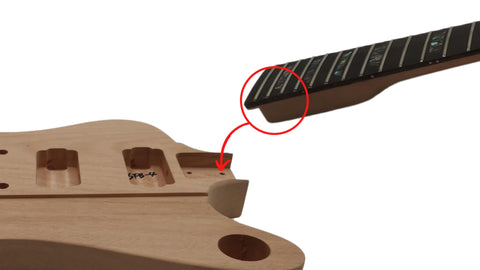

Dry fitting the neckĀ
Insert the NeckĀ
First pushĀ the heelĀ gently into the backĀ ofĀ the neck pocket, then push the neckĀ
down flat.Ā Ā

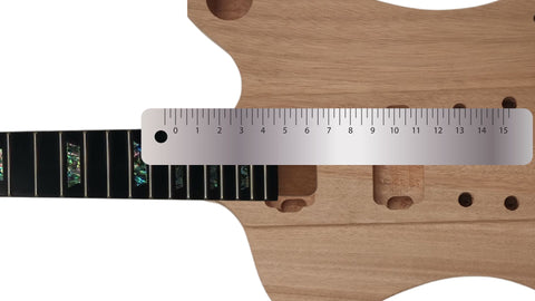

Check the scale lengthĀ
You can check the location of your bridge post holes with regardĀ to scale lengthĀ byĀ measuring the distance from theĀ edge of the nutĀ closest to the fretboard and the middle ofĀ the 12th fret and then doubling that number.Ā
FB-style guitar kits should have a scale length of 24.75ā€ or 628mm.Ā Ā
If your scale length appears out by a few mm, keep in mind the position of the bridge isĀ angled to compensate for the additional mass of the thicker bass strings and the saddles canĀ be adjusted forward or back via the intonation adjustment screws.Ā

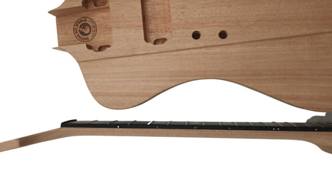

Check the neck angleĀ
KeepingĀ the bridgeĀ and steel ruler in place after checking your neck alignment, run the steelĀ ruler along the fretboard and over the bridge. The steel ruler should sit just above the saddlesĀ on the bridge when the bridge is sitting flat against the body.Ā

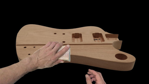

Next we’ll move onto prepĀ sanding the bodyĀ and neck.Ā
  1. Start by sanding the entire body using 180 grit sandpaperĀ
  2. Follow that up with 240 grit paper. If you areĀ applying a stain directlyĀ to the raw woodĀ sand up to 400 grit, but sanding any smoother than this may begin to affect how wellĀ the stain is absorbed.Ā
  3. Once you have completed sanding up to 240 grit, wipe a small amount of moisture onĀ the surface of the guitar. UsingĀ denatured alcoholĀ is a good option here as itĀ evaporates before it is absorbed into the timber, but water will also suffice. This willĀ raise the grain of the timber which can then be sanded flat.Ā Ā
Generally grain will only raise once, soĀ you can be confident you won’t haveĀ any problems during the finishingĀ process.Ā  Ā
sanding the body

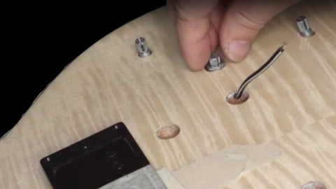

Installing and grounding the bridgeĀ Ā
Next, we need to insertĀ the groundĀ wireĀ into theĀ bridge post holeĀ andĀ insert the bridge bushing.Ā
There should be a loose black groundĀ wire in your packaging. Look for a smallĀ
hole on the side of the bridge post holeĀ nearest toĀ the control cavity. ThereĀ
should be a small hole just largeĀ enough to thread the ground wireĀ through to the electronics cavity.Ā
  1. Remove a few mm of the PVC coating and expose the bare wires.Ā
  2. Thread the wire, ensuring the bare wires are exposed and will sit flush against the sideĀ of the bridge or tailpiece post bushing once installed.Ā
  3. Make a small ā€˜hook’ in the top of the wire so the ground wire sits at the top of theĀ bridge or tailpiece post hole before installing the bushing.Ā Ā
  4. Remove the post from the bushing.Ā
  5. Insert the bushing into the predrilled hole, ensuring the ground wire ends up sittingĀ flush against the bushing. In many cases you may require a rubber mallet to force theĀ bushing into place.Ā
  6. Screw the bridgeĀ posts to the bridge bushings andĀ the tailpieceĀ posts to the tailpieceĀ bushings.Ā
  7. You can then fit the bridge over the bridge posts, but leave the tail piece for now as itĀ will not remain in place until the strings are installed.Ā
