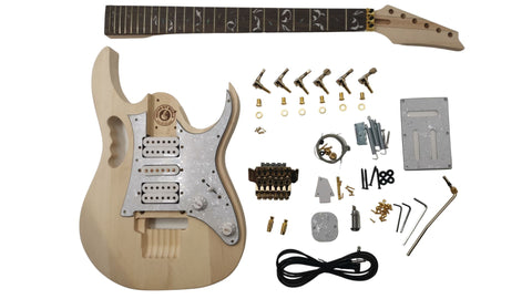

Parts ListĀ
Below are the parts you will find included in your packaging to complete a Hollow Body Guitar.

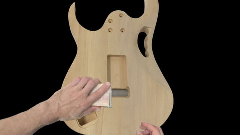

Once you have identified problem areasĀ you can begin prepĀ sanding the guitar.Ā
Start by sanding the entire body usingĀ 180 grit sandpaperĀ
Follow that up with 240 grit paper. IfĀ you areĀ applying a stainĀ directly to theĀ raw wood sand up to 400 grit, butĀ sanding any smoother than this mayĀ begin to affect how well the stain is absorbed.Ā
Once you have completed sanding up to 240 grit, wipe a small amount of moisture on theĀ surface of the guitar. Using denatured alcohol is a good option here as it evaporates before itĀ is absorbed into the timber, but water will also raise the grain of the timber which can thenĀ be sanded flat. Generally grain will only raise once, so you can be confident by taking care ofĀ it now, you won’t have any problems during the finishing process.Ā Ā

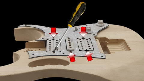

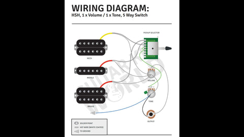

3. Connecting the electronics
HSH, 1 x Volume / 1 x Tone, 5 Way Switch
    If you haven’t soldered before you’re going to need aĀ soldering iron, solder, and aĀ dampĀ spongeĀ to clean the tip of your iron. I’d also recommend practicing before committing solderĀ to yourĀ electrical components.Ā
    SolderingĀ
    Most entry level soldering irons will do the job, andĀ your kitĀ will come with more than enoughĀ solder.Ā Ā
    1. TinningĀ
    Tin your soldering iron and the components you are connecting to.Ā TinningĀ refers toĀ maintaining a light coating of solder over the tip of your soldering iron and preventsĀ the iron tip from oxidizing.Ā
    2. PreheatingĀ
