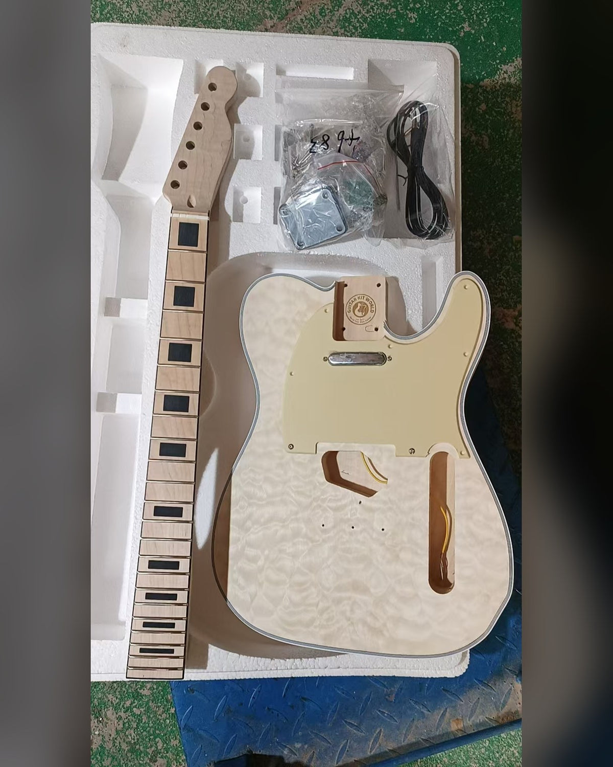

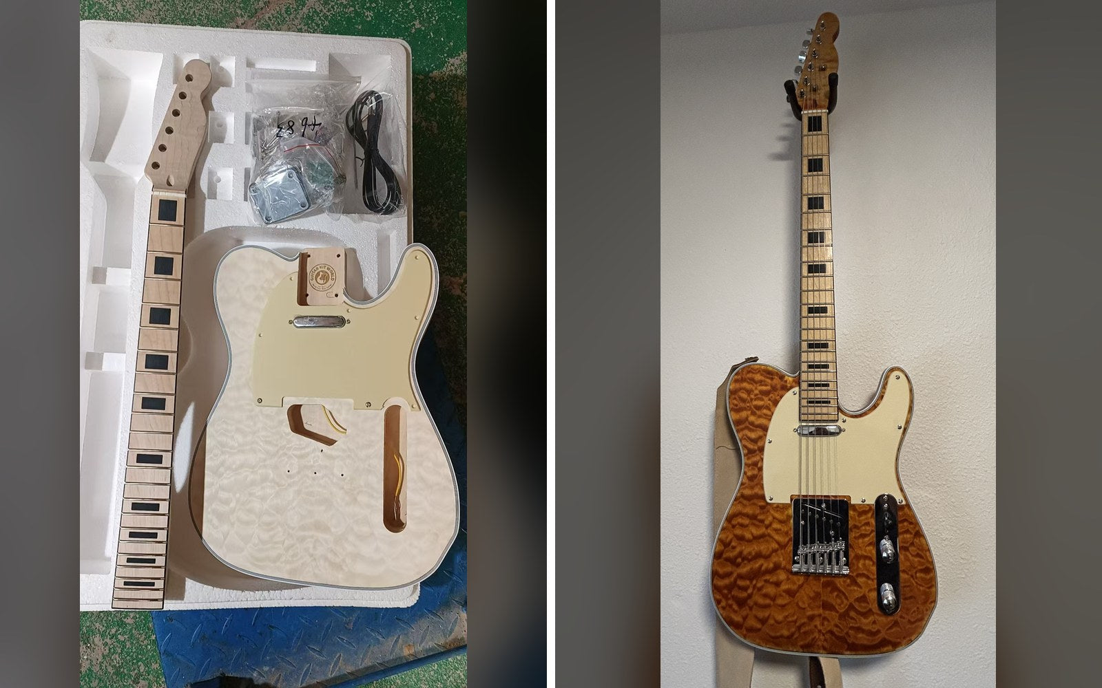

Steve built his guitar from our Custom Shop, starting from the Custom Shop classic single-cutaway kit. He chose a single-cutaway body with a quilted maple top, white binding, and a striped maple neck with black block inlays. Quilted maple was a smart pick for this finish. Its figure looks like rippled water. Dye and oil make those ripples catch the light.
The kit before any work: quilted maple top, white binding and a figured maple neck with black block inlays. Photo: Guitar Kit World custom shop.

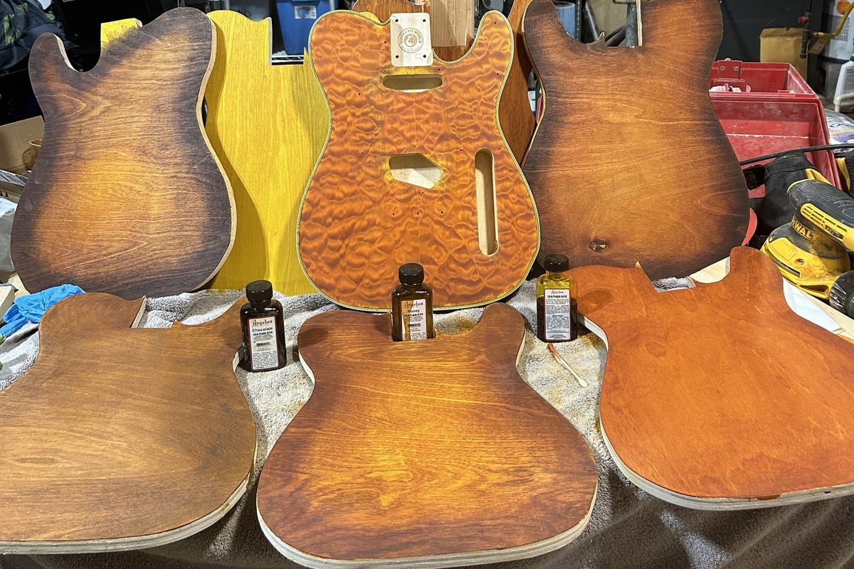

I watched many hours of YouTube videos from a couple of builders before I applied any color. I also made several Maple Ply blanks for color and pattern testing.
He used alcohol-based leather dyes. They mix into any color, and they stay easy to work. He tested each color and each step on maple plywood. Maple ply takes dye much like a maple top, so the blanks showed him what the guitar would do.
The test bench: plywood practice bodies in sunburst and amber. The real quilted body sits in the middle. Courtesy of Steve Madden.
His plan was a sunburst. The practice bodies changed his mind.
I did make several blanks for testing the Angelus dies and patterns. Once I got the first coat on and did the sand back I decided against a burst pattern.
Making the blanks was worth the effort.

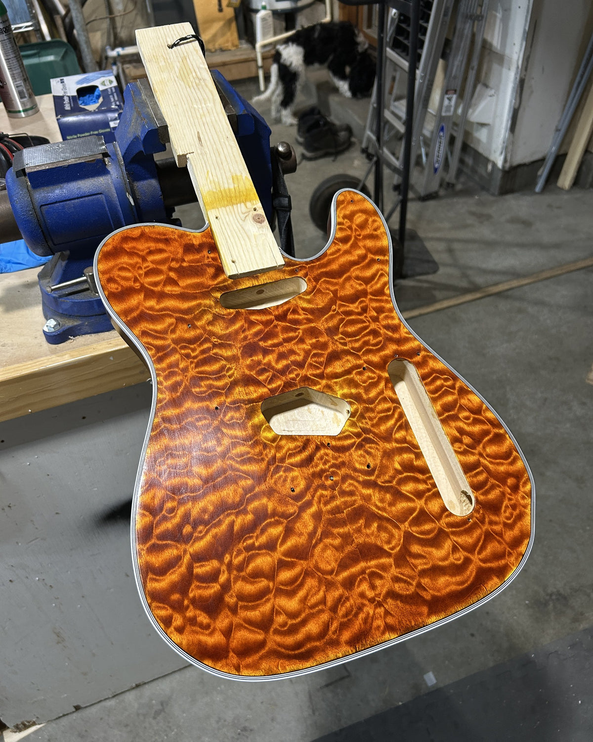

A sand back is how a figured top gets its depth. First, a bright color goes on. Here it was yellow. Then you sand lightly. The color comes off the high spots but stays in the soft ones. When the darker color goes on top, you see two layers instead of one.
Once Steve saw how much the quilt did on its own, he skipped the burst. The deep amber below is the result.
The top after the yellow base coat, the sand back and the amber dye, before any oil. Courtesy of Steve Madden.

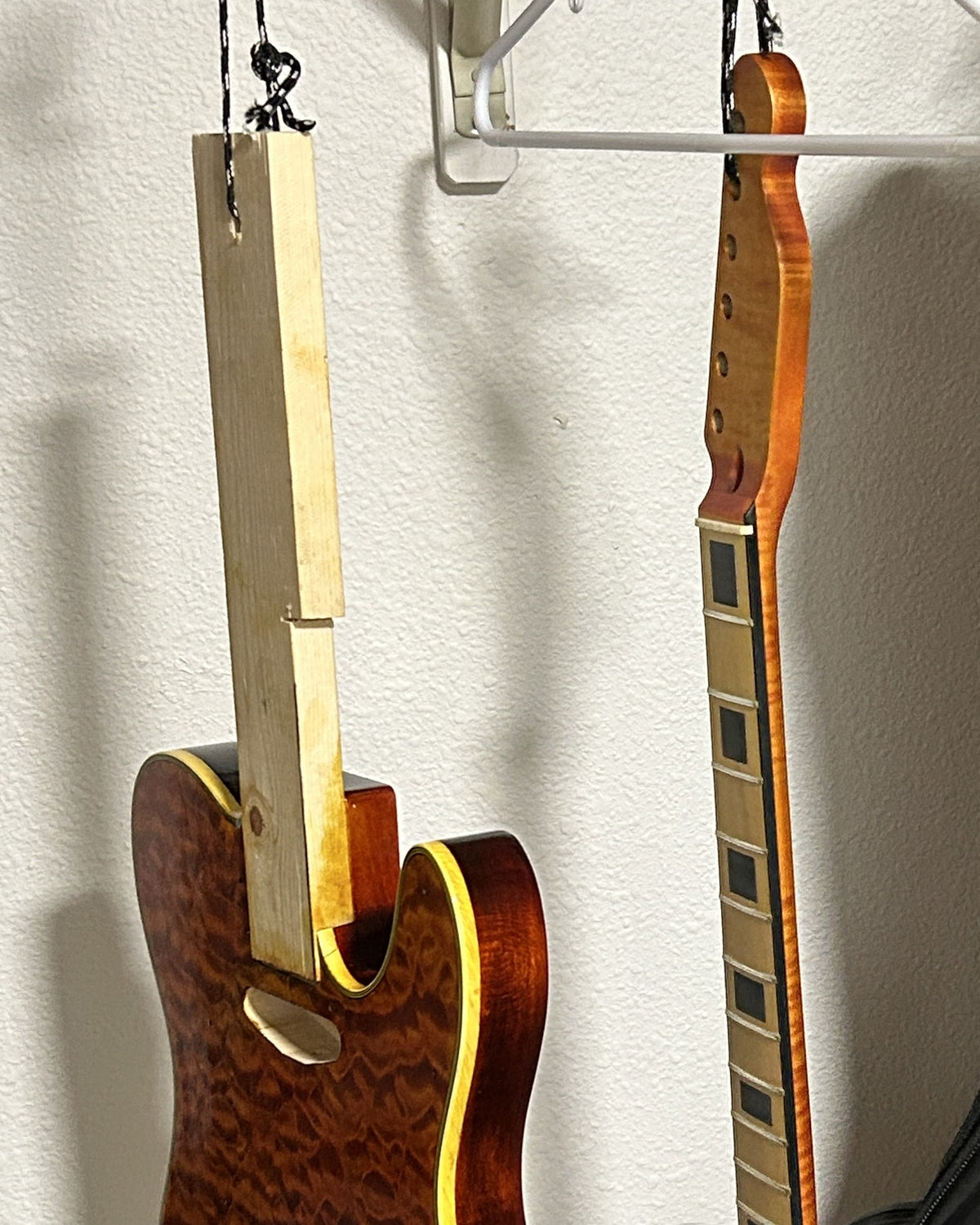

Tru-OilĀ® should be applied in very thin coats using a clean, lint-free cloth. Work out some way to hang the neck and body while they dry before you start.
Hanging to dry between coats: the body from a pine strip screwed into the neck pocket, the neck from its headstock. Courtesy of Steve Madden.

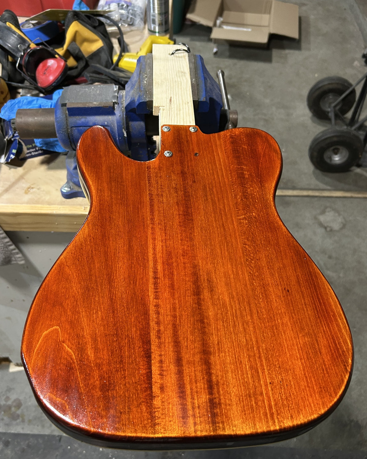

The back of the basswood body under dye and Tru-Oil, with the gloss already building. Courtesy of Steve Madden.

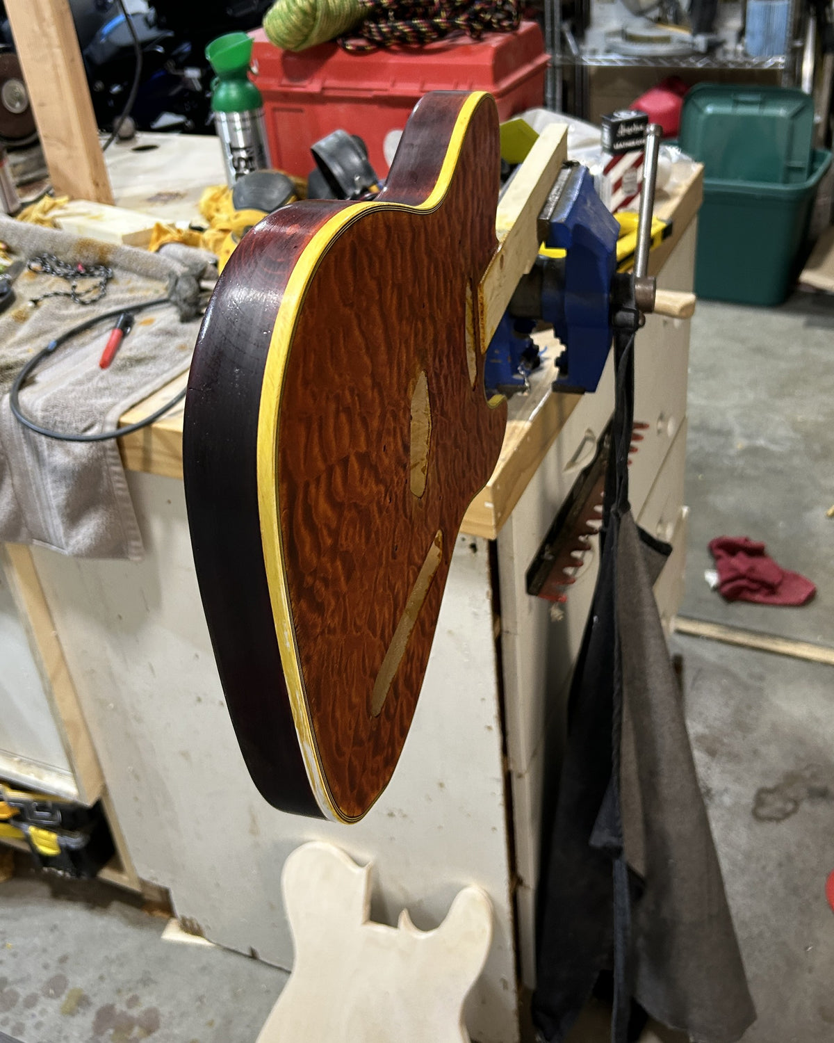

Why did the white binding turn yellow?

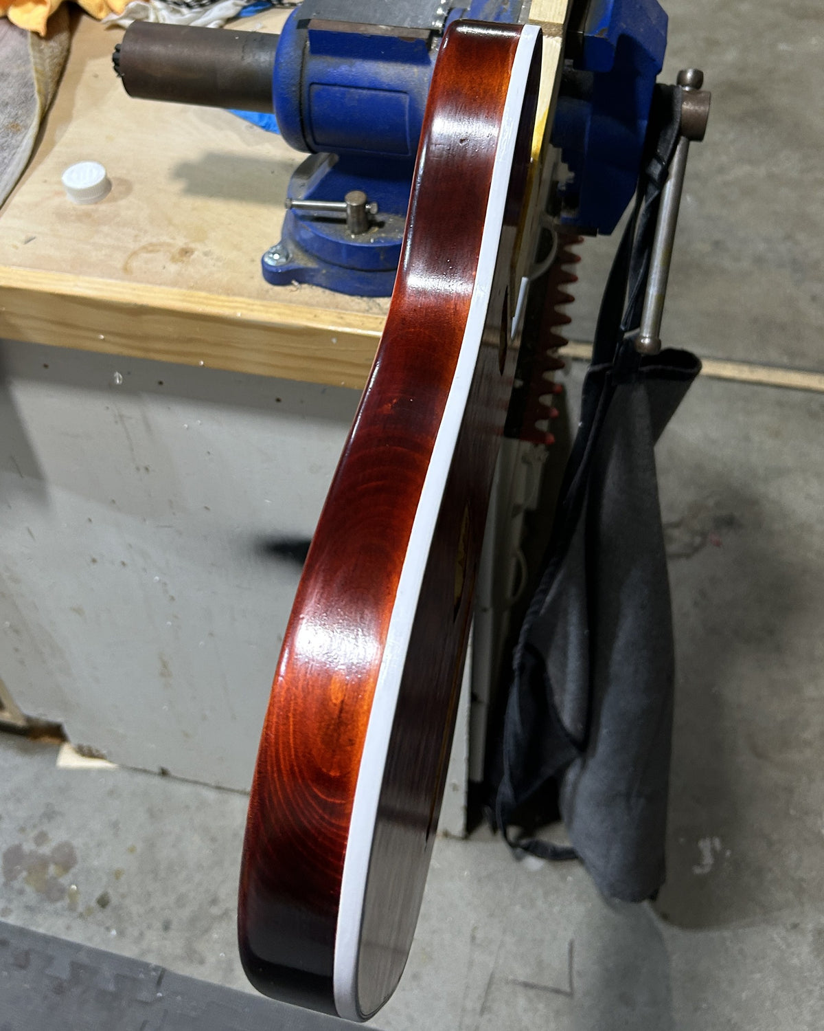

This was the step Steve had never done. Every coat of dye and oil on the top also landed on the white binding around its edge. By the last coat, the binding was bright yellow.
The problem: after dye and five coats of oil, the white binding around the top is yellow. Courtesy of Steve Madden.
The white binding had 5 coats of Tru-OilĀ® that had to be scraped off.
Here is the good news. Binding is plastic. It does not soak up dye or oil the way wood does. The color just sits on top as a thin skin. A sharp scraper, held flat and pulled along the binding, lifts that skin off. The clean white plastic is right underneath, and the wood next to it is not touched.
Scraping takes a steady hand and a steady body. Steve solved the steady part like a cabinetmaker.
I attached a strip of 3/4 ā pine to the body using the screw holes for installing the neck. This let me clamp and hold the body for scraping. It was pretty nerve racking at first, but I got the hang of it and after about 60 mins the binding was scraped and buffed and the body was ready for wax.
The fix: the body edge after about an hour of scraping, the binding white again against the oiled sides. Courtesy of Steve Madden.

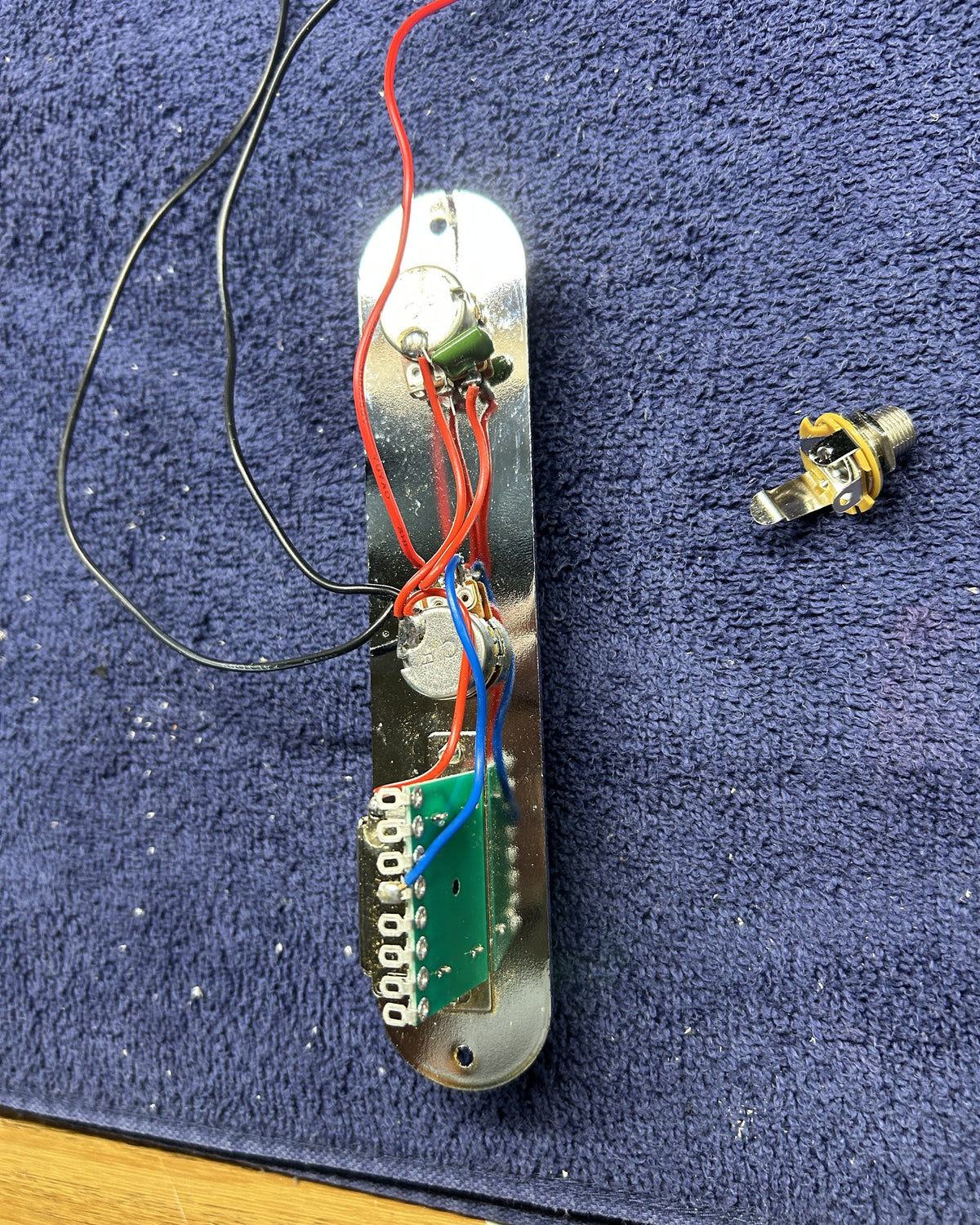

Can you wire a kit if you have never wired a guitar?
The finish was Steve's home turf. The wiring was not, and he said so.
I do plan to ask a guitar tech friend for help with the wiring. I am only about 50% confident working from the manual.
The control plate halfway wired: volume, tone and the pickup switch. The output jack waits beside it. Courtesy of Steve Madden.
So he laid every part out and took photos. He worked out which wires were ground and which carried the signal. He found where each pickup joined the switch. Two days later, it was done.
I managed to figure everything out. The guitar is complete and dropped off with my guitar tech today for a professional setup.

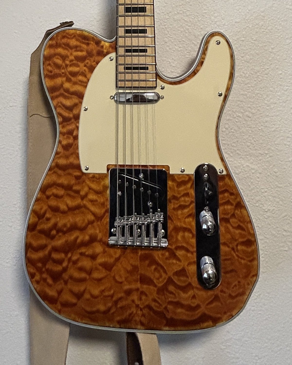

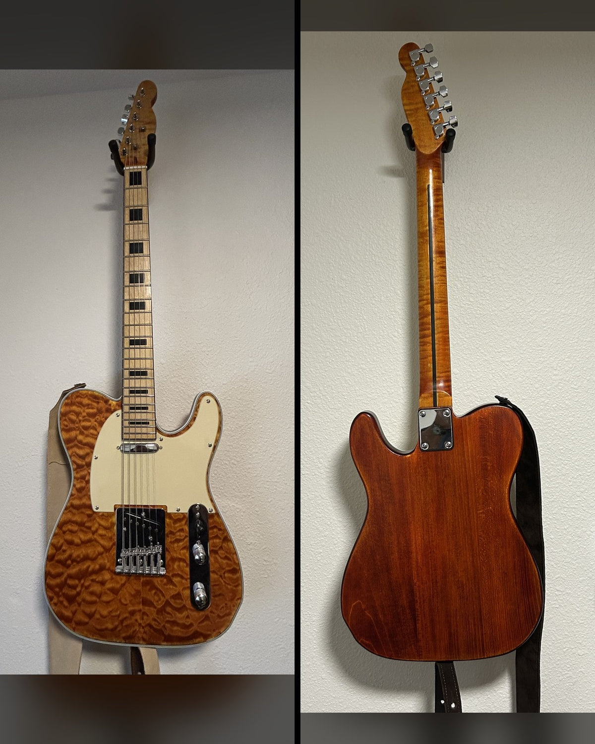

The finished guitar
Finished, front and back. Amber quilted top, cream pickguard, red-brown back. Courtesy of Steve Madden.
Look at the edge of the top. The white binding runs around it in one clean, unbroken line. That line is what makes the amber look deep. It gives your eye a sharp edge to measure the figure against. It is also the hour Steve spent with a scraper.
Up close: the quilt under five coats of Tru-Oil and four of paste wax. Courtesy of Steve Madden.
I am very happy with the project. It is definitely a homemade 1 of 1 guitar that I am very proud of.
