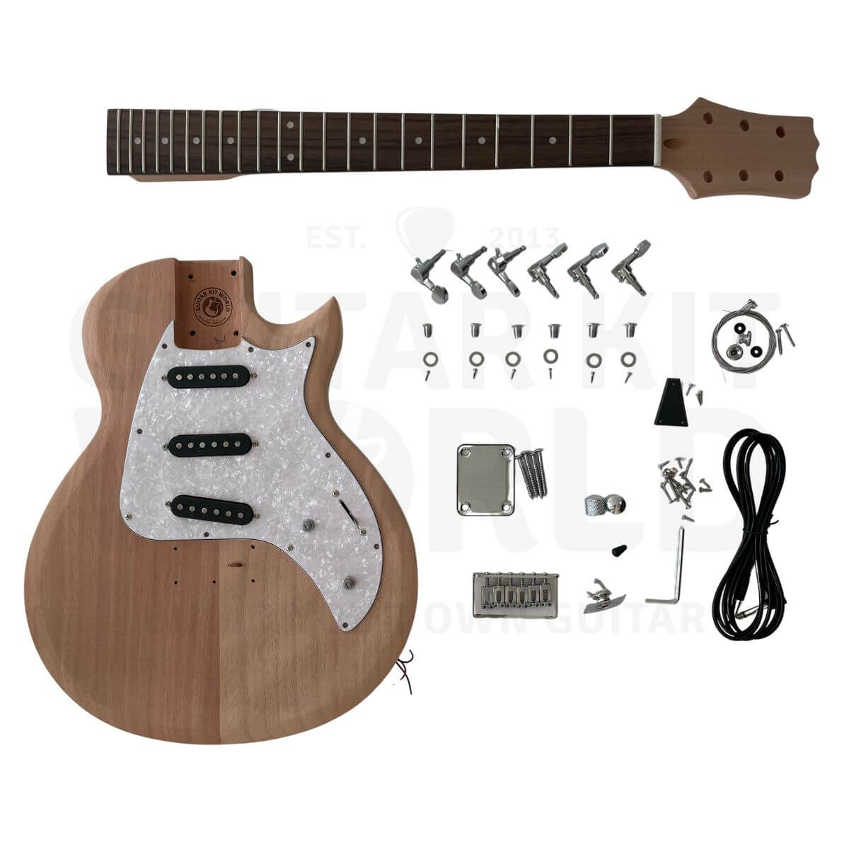

Mahogany TR Guitar Kit with Bolt On Neck, SSS Pickups, Rosewood
Solid body construction is the standard for most rock, metal, and high-gain
electric guitars.

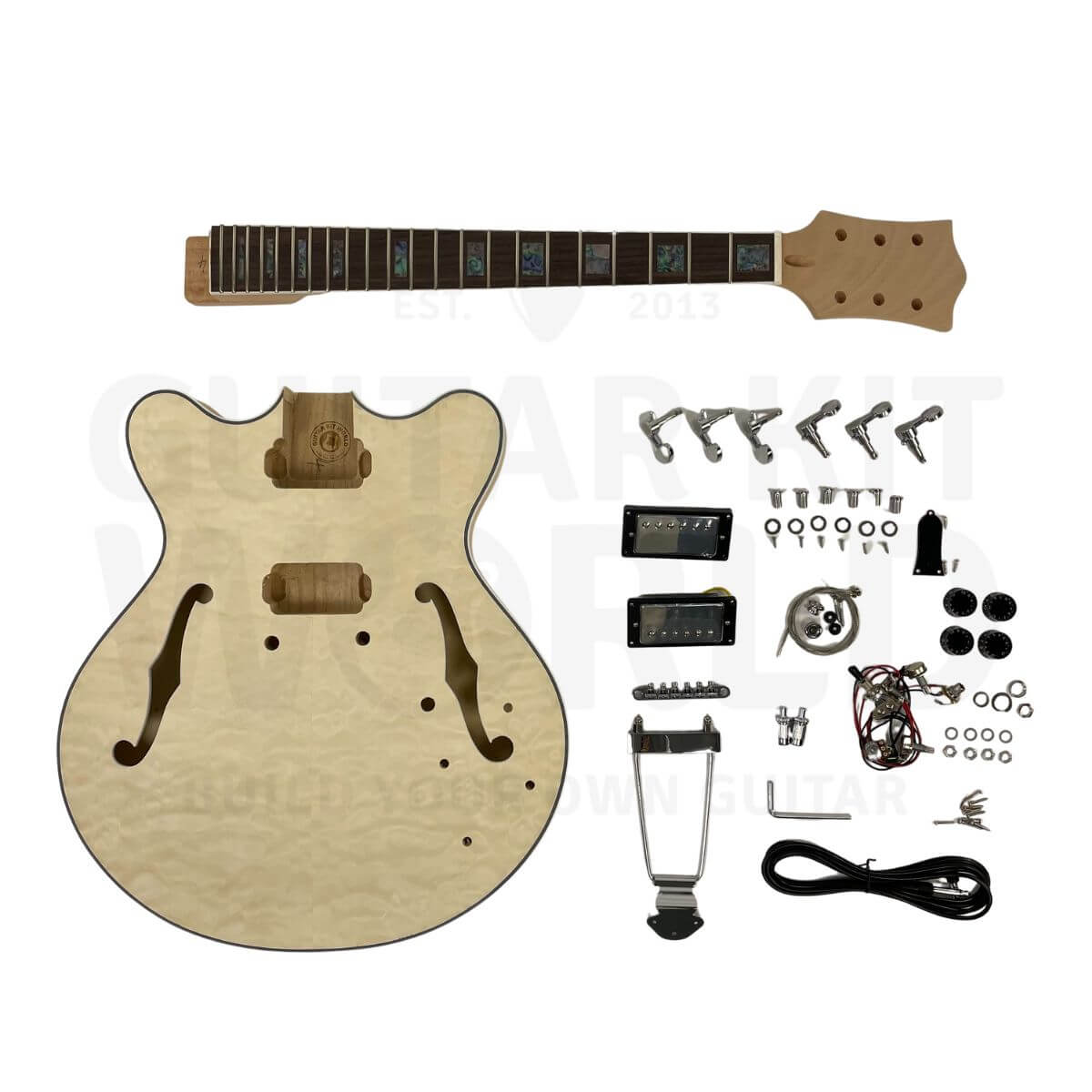

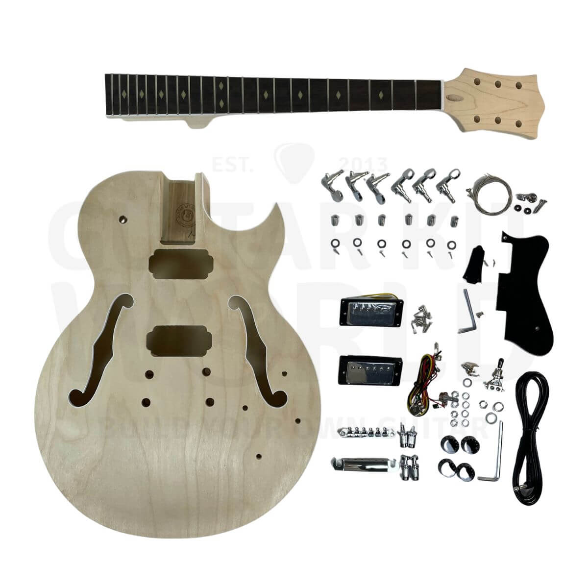

3. Semi-Hollow Electric Guitars
Semi-hollow guitars have large hollow sections but retain solid wood in
critical areas for strength and feedback control.
Large hollow wings
One or two f-holes
Internal support: Full-length center block
Warmer tone than solid bodies
Moderate feedback resistance
On every kit we list as Semi-Hollow, the spec sheet reads Internal Support: Full-length center block. That block runs the length of the body and divides the cavity into two separate wings, which is what keeps a semi-hollow controllable at volume.

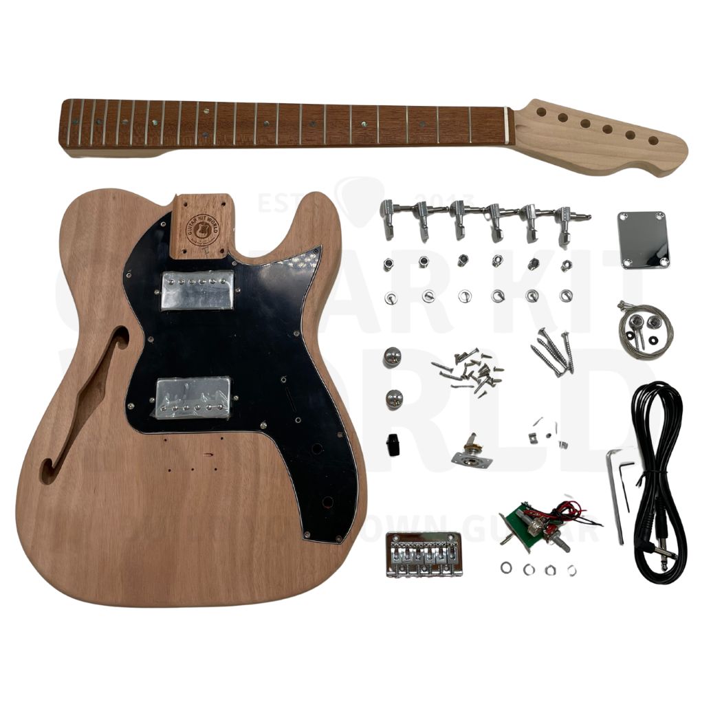

The semi-hollow chambered body is a subtype of the category above. It
originated as a weight-relieved T-style variant in the late 1960s, combining
chambered construction with visible semi-hollow features.
Routed internal chambers
Solid top glued over the chambers
Sound holes: one or two f-holes
Internal support: None (chambered body)
These guitars were originally designed to reduce weight while keeping the feel
and response of a solid body electric.
Courtesy of Michael. One f-hole, a solid top over routed chambers, and no
full-length block.

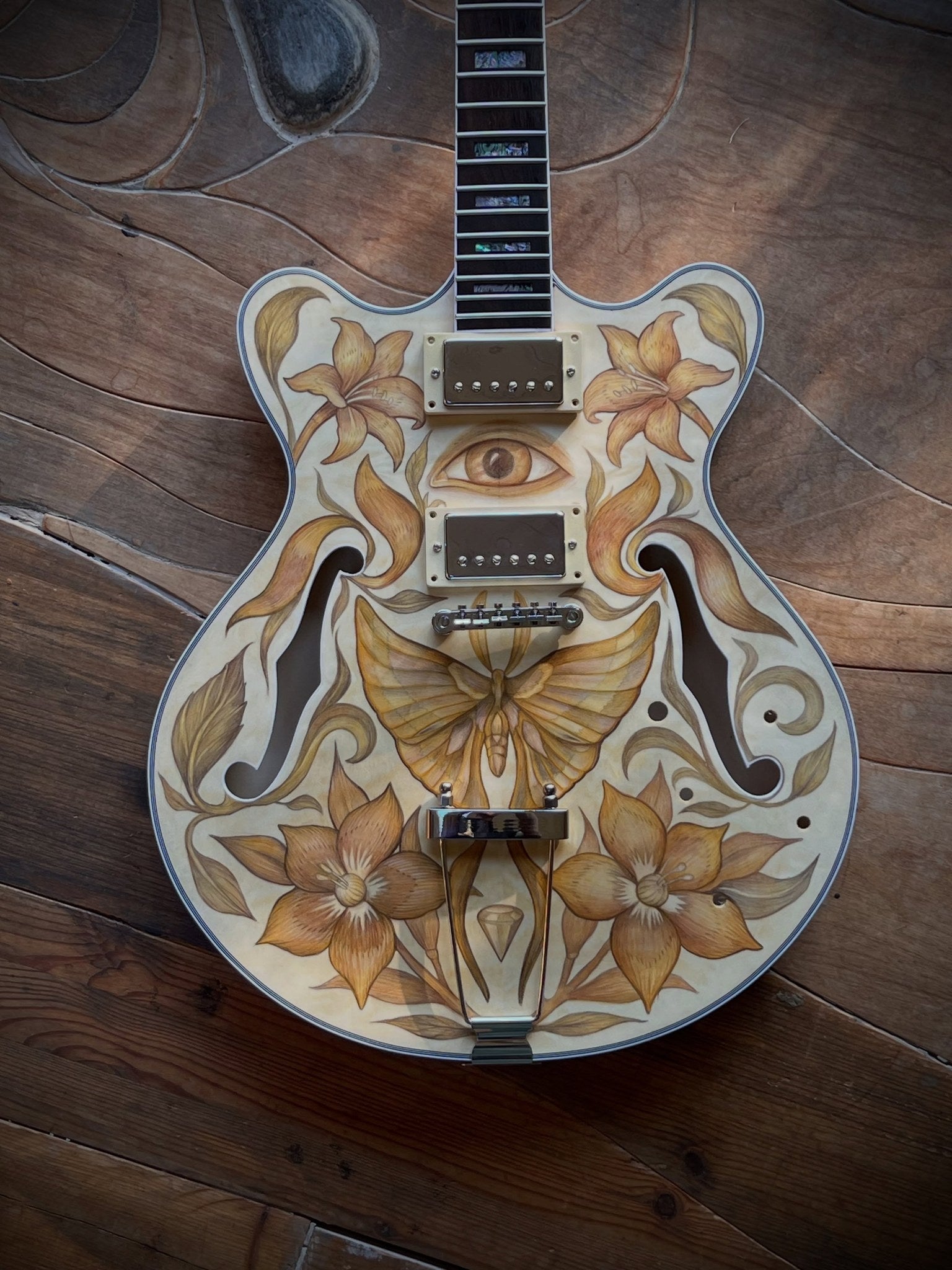

Bill Antonitis took the same category in a very different direction on a
baritone semi-hollow archtop, with a hand-carved rune, shotgun shell knobs and
LEDs behind the f-holes.
See Bill's first build.
A note from experience:One of the most common questions we get from builders is whether a
chambered body is the same as a semi-hollow. The short answer: a semi-hollow
chambered guitar is one kind of semi-hollow, but not every semi-hollow is
chambered. Chambered guitars typically start with a solid-body outline (like
a T-style shape) that has been routed out internally and capped with a top,
whereas many semi-hollows are built from the ground up as hollow instruments
with a center block added.

structure. On most of our Hollow Body kits the spec sheet reads Internal Support: Bridge block. A bridge block is a small support under the bridge only. It does not divide the cavity, and that is exactly what separates a Hollow Body from a Semi-Hollow.
Internal support: Bridge block (under the bridge only)
Prominent f-holes
Lightest body construction
Strong acoustic resonance
More prone to feedback than solid or semi-hollow bodies

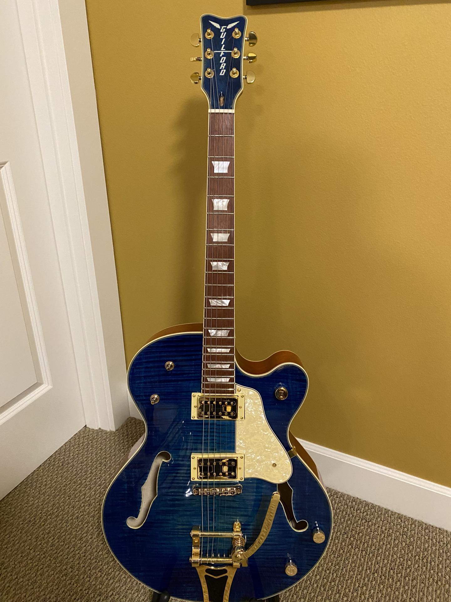

Byron Stafford has been building since the 1950s and still leaves every new
kit boxed for a week before he starts. His most recent build is a thin hollow
body with a Florentine cutaway and gold hardware.
Read why he lets a kit breathe first.

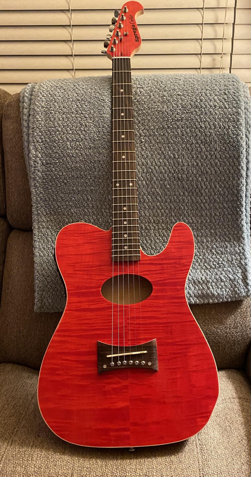

Courtesy of Aruyne E. Note the round soundhole and the piezo bridge in
place of magnetic pickups.
