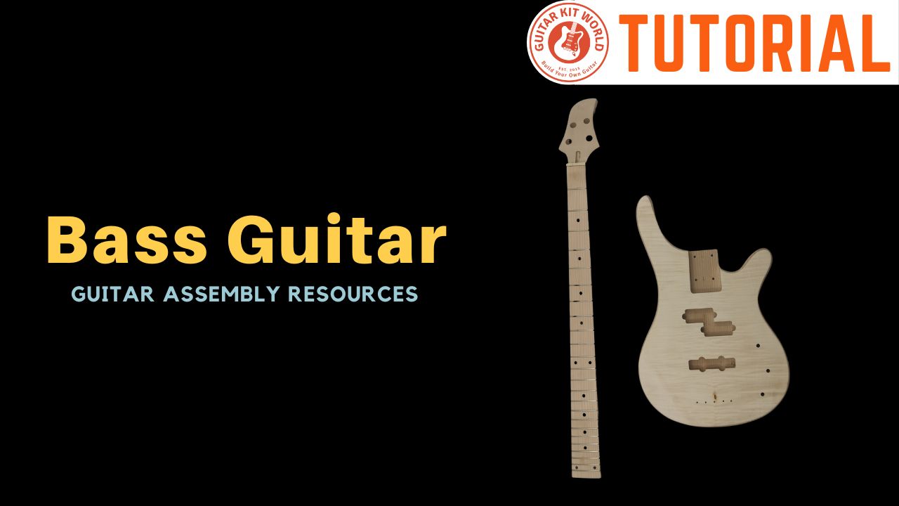

Bass Guitar Kit Assembly Manual
This guide provides step-by-step instructions to build a DIY Bass Guitar using a kit. Even if you have never built before, you can learn how to get started by reading this tutorial.

Parts List
Below are the parts you will find included in your packaging to complete an JG-style guitar kit.
  • Prepped DIY Bass Guitar
  • Completed neck
  • Neck plate, neck plate cushion and screws (if bolt-on neck)
  • 2 x Strap buttons
  • 4 tuners (4 string bass), 5 tuners (5 string bass)
  • Stud mounted Tune-O-matic style bridge with tailpiece
  • Neck and bridge humbuckers
  • 2 x volume and 1 x tone controls, and input jack
  • Truss rod cover, pick guard and electronics cavity cover
  • Cable and hex wrench (for adjusting truss rod)
  • Tone and volume knobs
  • Assorted screws and washers
