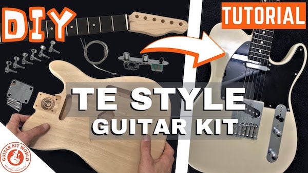

TE Guitar Kit Assembly Manual
Step-by-step instructions on how to build your own TE-style guitar using our DIY TE guitar kits. Get started by reading the following tutorial even if you're a first-time builder.
TE Guitar Kit Assembly Manual | Guitar Kit World
This guide provides step-by-step instructions to build a TE-style DIY guitar using a kit. Even if you have never built before, you can learn how to get started by reading this tutorial.
There’s nothing more satisfying than playing a guitar you have put together yourself!
Before we begin, let's watch this quick time lapsed video of building a TE-style kit.

Parts List
Below are the parts you will find included in your packaging to complete an LPH guitar kit.
  • Prepped TE body
  • Completed neck
  • Neck plate, neck plate cushion and screws
  • Pickguard (pre-mounted with T style neck pickup)
  • 2 x Strap buttons
  • 6 x inline tuners
  • T style Bridge (pre-mounted with T style bridge pickup)
  • Pre-mounted control plate ( 1 x volume and 2 x tone controls, 1 x 3 way pickup selector)
  • Input jack
  • 2 x string trees
  • Cable and hex wrench (for adjusting truss rod
  • Tone and volume knobs
  • Assorted screws and washers
