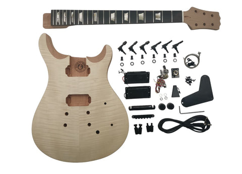

Below are the parts you will find included in your packaging to complete a Hollow Body Guitar.

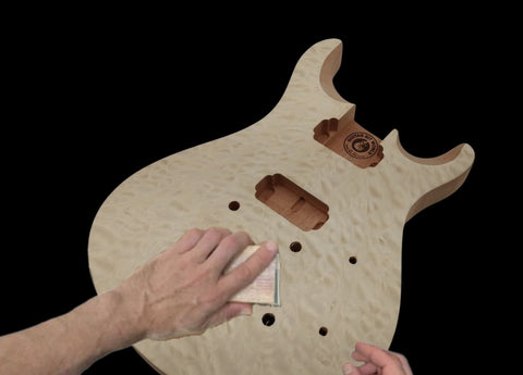

Once you have identified problem areas you can begin prep sanding the guitar.
Start by sanding the entire body using 180 grit sandpaper
Follow that up with 240 grit paper. If you are applying a stain directly to the raw wood sand up to 400 grit, but sanding any smoother than this may begin to affect how well the stain is absorbed.
Once you have completed sanding up to 240 grit, wipe a small amount of moisture on the surface of the guitar. Using denatured alcohol is a good option here as it evaporates before it is absorbed into the timber, but water will also raise the grain of the timber which can then be sanded flat. Generally grain will only raise once, so you can be confident by taking care of it now, you won’t have any problems during the finishing process.

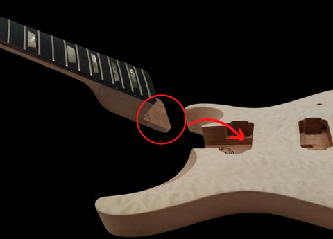

Dry Fitting the Neck
You should also check the neck fit. Most hollow body guitars are set necks and would sometimes have a tighter neck pocket than a bolt on. it’s important to dry fit the neck and check how well it fits the neck pocket, along with neck alignment, neck angle and scale length.
Insert the Neck
First push the heel gently into the back of the neck pocket, then push the neck down flat.
This reduces the risk of chipping the thin edges of the neck pocket before the neck has been installed.

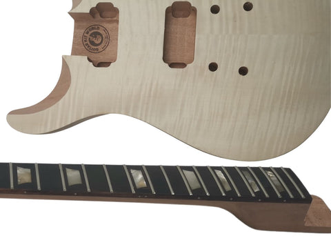

Check the neck fit
The neck, once inserted into the neck pocket, should have very little sideways movement. If there is a gap on either side of the neck, you may need to shim the neck by cutting small sections of scrap wood with a craft knife and gluing these to the sides of the neck pocket. Otherwise smaller gaps can be filled prior to finishing using a filler.

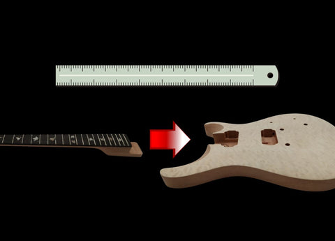

Check the neck angle
Run a steel ruler along the fretboard and over the bridge. The steel ruler should sit just above the saddles on the bridge when the bridge is sitting flat against the body.

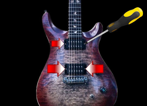

    Adjusting pickup height
    Lastly, we’ll check and adjust the pickup height. Much like string action, the height of your pickups is mostly subjective and will depend on what you are hearing.
    The DIY guitar by Bryan Pratt
    But, if unsure a good starting point is 2.4mm from the top of the magnetic pole piece to the underside of the string. However, this should be measured when pressing down the last fret of the guitar.
    To adjust the height of the pickups, adjust the mounting screws on the outside of the pickup surround.
    Recommended: How High Should my Pickups Be?
