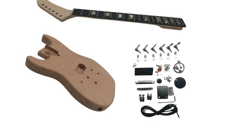

Below are the parts you will find included in your packaging to complete a Hollow Body Guitar.

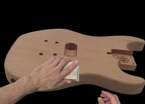

Once you have identified problem areasĀ you can begin prepĀ sanding the guitar.Ā
Ā Ā
Start by sanding the entire body usingĀ 180 grit sandpaperĀ
Follow that up with 240 grit paper. IfĀ you areĀ applying a stainĀ directly to theĀ raw wood sand up to 400 grit, butĀ sanding any smoother than this mayĀ begin to affect how well the stain is absorbed.Ā
Once you have completed sanding up to 240 grit, wipe a small amount of moisture on theĀ surface of the guitar. Using denatured alcohol is a good option here as it evaporates before itĀ is absorbed into the timber, but water will also raise the grain of the timber which can thenĀ be sanded flat. Generally grain will only raise once, so you can be confident by taking care ofĀ it now, you won’t have any problems during the finishing process.Ā Ā

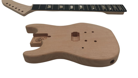

Dry Fitting the NeckĀ

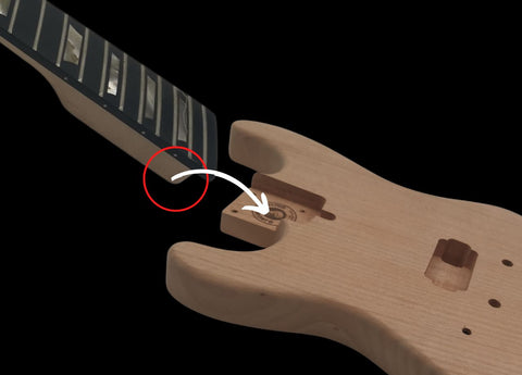

You should also check the neck fit. Most hollow body guitars are set necks and would sometimes have a tighter neck pocket than a bolt on.Ā it’s important toĀ dry fit the neck and check how well it fits the neck pocket, along with neck alignment, neckĀ angle and scale length.Ā
Insert the NeckĀ
FirstĀ push the heelĀ gently into the back of the neck pocket, then push the neck down flat.Ā Ā

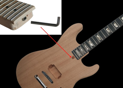

Check the neck fitĀ
The neck, once inserted intoĀ the neck pocket, should have very little sideways movement. IfĀ there is a gap on either side of the neck, you may need to shim the neck by cutting smallĀ sections of scrap wood with a craft knife and gluing these to the sides of the neck pocket.Ā Otherwise smaller gaps can be filled prior to finishing using a filler.Ā

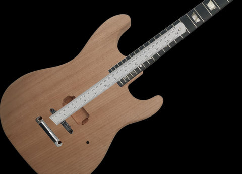

Check the neck angleĀ
RunĀ a steel rulerĀ along the fretboard and over the bridge. The steel ruler should sit just aboveĀ the saddles on the bridge when the bridge is sitting flat against the body.Ā Ā

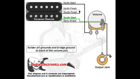

3. Connecting the electronics

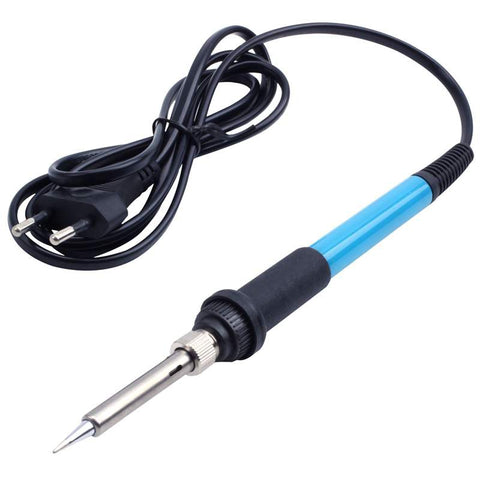

    If you haven’t soldered before you’re going to need aĀ soldering iron, solder, and aĀ dampĀ spongeĀ to clean the tip of your iron. I’d also recommend practicing before committing solderĀ to yourĀ electrical components.Ā
    SolderingĀ
    Most entry level soldering irons will do the job, andĀ your kitĀ will come with more than enoughĀ solder.Ā Ā
    1. TinningĀ
    Tin your soldering iron and the components you are connecting to.Ā TinningĀ refers toĀ maintaining a light coating of solder over the tip of your soldering iron and preventsĀ the iron tip from oxidizing.Ā

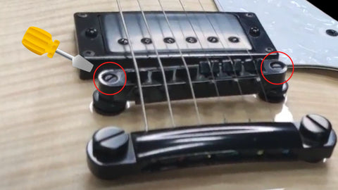

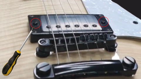

    Lastly, we’ll check andĀ adjust the pickup height. Much like string action, the height of yourĀ pickups is mostly subjective and will depend on what you are hearing.Ā  Ā
    You’ll need to match the height for both to keep the saddle balanced on the bridge.Ā
    But, if unsure a good starting point is 2.4mm from the top of the magnetic pole piece to theĀ underside of the string. However, this should be measured when pressing down the last fretĀ of the guitar.Ā
