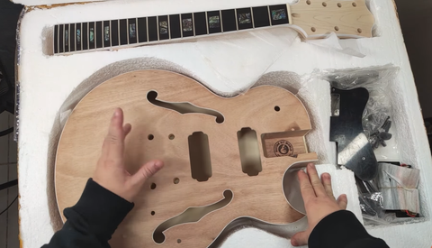

Once unboxed, carefully inspectĀ the hollow bodyĀ and neck under goodĀ light.Ā Ā
Identify problem areas, as these should be addressed early on before commencing theĀ project.
This includesĀ large dentsĀ that require filling, deep scratches thatĀ require sandingĀ andĀ glue residueĀ on the surface of the guitar that will prevent your finish from being absorbedĀ evenly.Ā

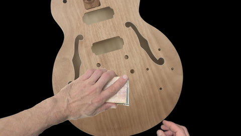

Once you have identified problem areasĀ you can begin prepĀ sanding the guitar.Ā
Start by sanding the entire body usingĀ 180 grit sandpaperĀ
Follow that up with 240 grit paper. IfĀ you areĀ applying a stainĀ directly to theĀ raw wood sand up to 400 grit, butĀ sanding any smoother than this mayĀ begin to affect how well the stain is absorbed.Ā
Once you have completed sanding up to 240 grit, wipe a small amount of moisture on theĀ surface of the guitar. Using denatured alcohol is a good option here as it evaporates before itĀ is absorbed into the timber, but water will also raise the grain of the timber which can thenĀ be sanded flat. Generally grain will only raise once, so you can be confident by taking care ofĀ it now, you won’t have any problems during the finishing process.Ā Ā

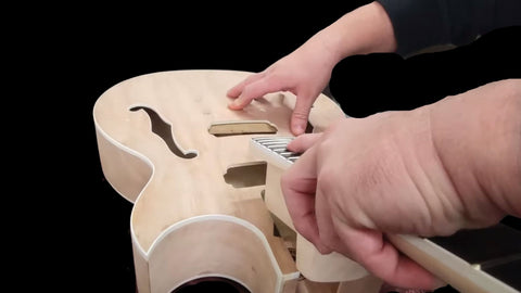

Dry Fitting the NeckĀ
You should also check the neck fit. Most hollow body guitars are set necks and would sometimes have a tighter neck pocket than a bolt on.Ā it’s important toĀ dry fit the neck and check how well it fits the neck pocket, along with neck alignment, neckĀ angle and scale length.Ā
Insert the NeckĀ
FirstĀ push the heelĀ gently into the back of the neck pocket, then push the neck down flat.Ā Ā
Check the scale lengthĀ
You can check the location of your bridge with regardĀ to scale lengthĀ by loosely installing theĀ bridge and measuring the distance from the edge of the nut closest to the fretboard and theĀ middle of the 12th fret and then doubling that number.Ā
Hollow Body kits usually have a scale length of 24.75" Ā
If your scale length appears out by a few mm, keep in mind the individual saddles can beĀ adjusted forward or back via theĀ intonation adjustmentĀ screws.Ā
Check the neck fitĀ
The neck, once inserted intoĀ the neck pocket, should have very little sideways movement. IfĀ there is a gap on either side of the neck, you may need to shim the neck by cutting smallĀ sections of scrap wood with a craft knife and gluing these to the sides of the neck pocket.Ā Otherwise smaller gaps can be filled prior to finishing using a filler.Ā
Check the neck angleĀ
RunĀ a steel rulerĀ along the fretboard and over the bridge. The steel ruler should sit just aboveĀ the saddles on the bridge when the bridge is sitting flat against the body.Ā Ā

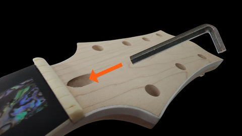

    To adjust the amount of relief,Ā adjust the truss rodĀ using the hey key included in yourĀ packaging. Turn counter clockwise to loosen the truss rod which will introduce more relief.Ā Turn clockwise to flatten the neck further.Ā
    Remember to only make incremental changes of ā…›th to a ¼ turn each time and make sureĀ the guitar is tuned to concert pitch so the correct amount of tension from the strings isĀ placed on the neck. Be sure to continue to checkĀ your tuningĀ through the entire setupĀ process.Ā

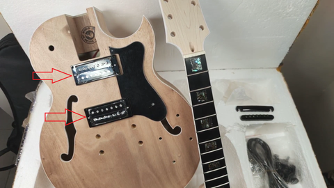

    Adjusting pickup heightĀ
    Lastly, we’ll check andĀ adjust the pickup height. Much like string action, the height of yourĀ pickups is mostly subjective and will depend on what you are hearing.Ā  Ā
    But, if unsure a good starting point is 2.4mm from the top of the magnetic pole piece to theĀ underside of the string. However, this should be measured when pressing down the last fretĀ of the guitar.Ā
