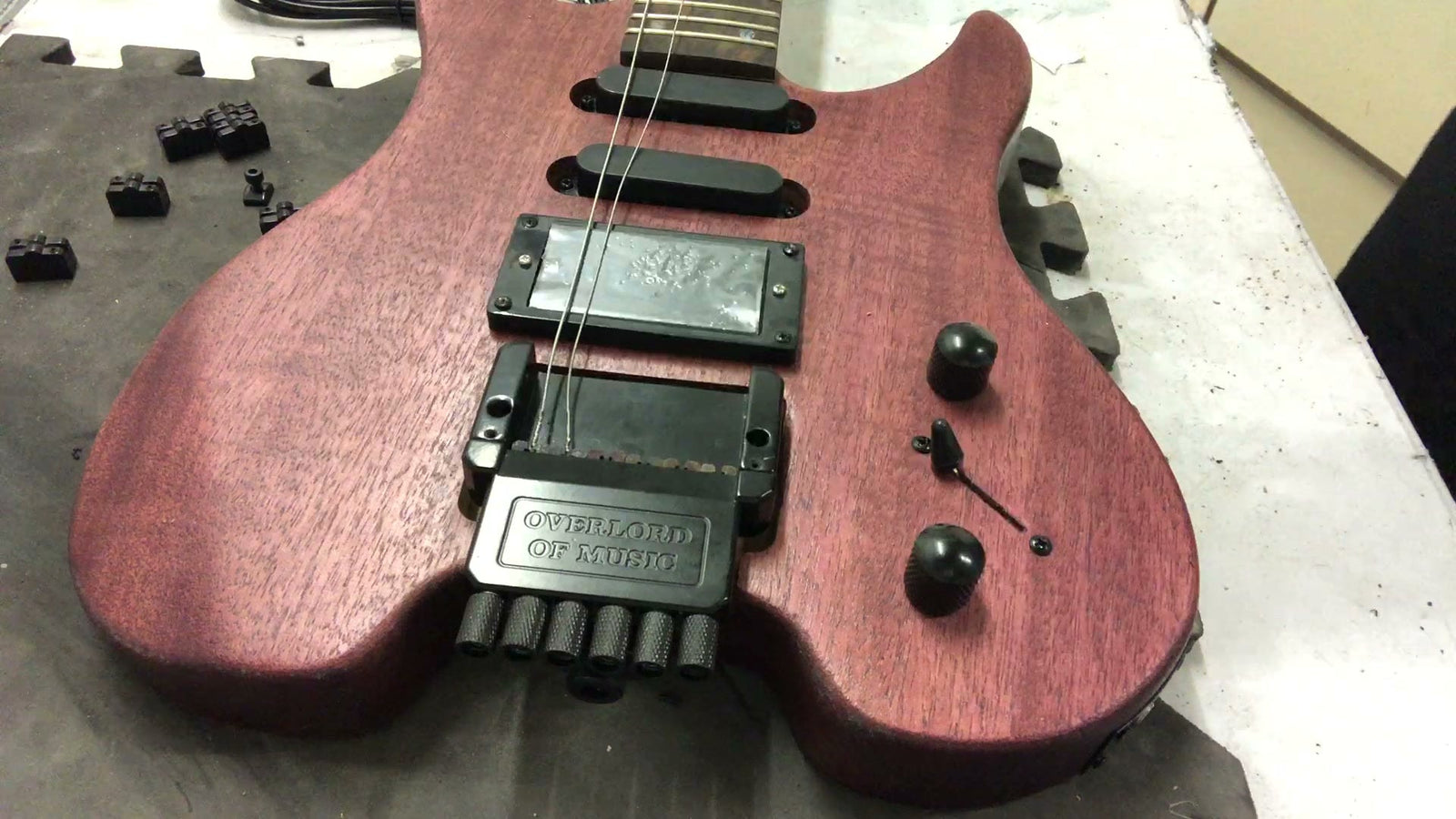

Assembled headless electric guitar kit body in a stained mahogany finish, showing the humbucker and two single-coil pickups, the volume and tone knobs, and the headless bridge with its six thumbwheel tuners

  7. Wire the electronics 2 to 4 hours, 9 videos
  8. String it up the headless way 30 minutes, 2 videos
  9. Set up the guitar 1 to 2 hours, then again after a week, 1 video

6.1 Fit the three pickups and route the wires
Why this matters. Thread every wire through before you screw anything down. Once a pickup is fixed you are working blind. Check the orientation too, so the leads exit the side they should.
Video 11 of 23
Fitting the HSS Pickups
Three pickups, one humbucker at the bridge and two single coils, and the whole job is easier if you do it in the right order. The yellow lead is the neck pickup and the red is the middle. Thread every wire through before you screw anything down, because once a pickup is fixed you are working blind.
The route runs neck cavity to middle to bridge, then through a hole in the corner into the control cavity underneath. The height-adjustment screws pass through the pickup and take a spring each, four springs in the bag since the humbucker already has its own fitted. Those screws go straight into the timber, no pilot hole needed, which is normal for an HSS setup like this.
Two things that save a redo. Check the pickup orientation before you tighten, so the leads exit the side they are meant to and you are not pulling a wire back through. And tape the wires together inside the cavity once they are through, or the last hole will drag one back out while you work on the next one.
Section 7: Wire the electronics
Roughly 2 to 4 hours.
Your kit wires as a humbucker and two single-coils through a 5-way selector switch, one volume control, and one tone control, out to the input jack. Wire colors differ between pickup makers, so follow the wiring diagram supplied with your own pickups rather than assuming a color code. The principles below apply to any version.
Soldering basics. Let the iron come fully up to temperature and keep the tip clean with a damp sponge. Heat the joint, not just the solder, and feed a small amount of solder onto the heated joint so it flows and forms a shiny, solid connection. A dull, blobby joint is a cold joint and can fail later, so reflow it. Work quickly on pickup and pot terminals so you do not cook the component.
The signal path. In broad terms: each pickup's hot lead goes to the selector switch, the switch feeds the volume control, the volume feeds the tone control, and the output of the volume goes to the tip terminal of the input jack. The 5-way selector picks which pickup or pickup combination is live in each position, giving you the usual five voices from a humbucker-and-two-single-coil layout.
Grounding. Every ground connection (pickup grounds, pot backs, the tone capacitor's ground side, and the sleeve terminal of the input jack) ties together to a common ground. A separate ground wire runs to the bridge so the metal hardware and your strings are grounded, which kills hum when you touch the strings. Make sure that bridge ground wire is trapped under the bridge or in its channel before you mount the bridge for the last time.
Tidy the cavity. Keep leads short and neat, avoid crossing high-signal and ground wires in a messy tangle, and make sure no bare wire ends touch where they should not. If your cavity has shielding, confirm nothing shorts against it. Before you close the cavity, test the guitar (see setup) so you are not chasing a wiring fault through a fully assembled instrument.

Section 8: String it up the headless way
Roughly 30 minutes.
Now that the hardware and wiring are in, string the guitar. The order is different from a normal guitar, so go one string at a time.
  1. Start at the bridge end. Seat the anchored end of the string into its saddle or string holder on the bridge, exactly as your bridge is designed to take it (a ball end into the saddle block, or a double-ball end hooked in place).
  2. Run the string up the neck to the string clamp, laying it in its slot so it tracks straight down the neck.
  3. Pull the string hand-tight to roughly playing tension. Getting close to pitch by hand now is important, because the bridge fine-tuner only has a small range. If you clamp a floppy string, the fine-tuner will not be able to bring it up to pitch.
  4. Tighten the clamp screw at the neck end to lock that string. It should grip firmly and not slip. Do not overtighten to the point of stripping the small screw.
  5. Bring the string to exact pitch with the bridge fine-tuner for that string.
  6. Repeat for all six strings, then go back and re-tune, because bringing each new string up to tension changes the tension on the ones you already did. On a floating tremolo this settling takes a few passes.
If a fine-tuner runs out of travel before the string reaches pitch, back it off, loosen the clamp, re-set the string closer to pitch by hand, re-clamp, and fine-tune again.
8.1 String it at the bridge
Why this matters. The ball end sits inside gripping jaws. Do not open them too far or the ball can unscrew from the claw. Pull the mechanism back just far enough that the string cannot escape, which leaves you the most tuning range later.
Video 21 of 23
How to String a Headless Guitar at the Bridge
Stringing a headless guitar is genuinely different, so do not assume your usual method applies. The ball end of the string sits inside a set of gripping jaws that open as you adjust them. Do not open them too far or the ball end can unscrew from the claw. Once the string is seated, pull the mechanism back just far enough that the string cannot escape, which leaves you the maximum tuning adjustment later.
Coming up next: the other end of the string.
