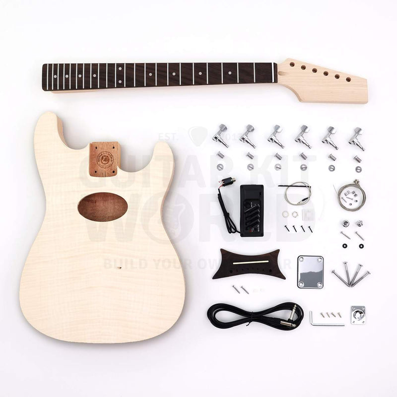

Build your own acoustic electric guitar with this ST-style hollow body DIY guitar kit, designed for builders who want acoustic warmth, electric versatility, and full customization. This kit features a hollow body with a solid block under the bridge, offering enhanced sustain and feedback control while preserving natural acoustic resonance. The bridge arrives pinless with its string holes drilled and its position scaled at the factory, so the hardest part of an acoustic build is already done for you.
Updated kit, easier to build
We changed this kit so a first-time builder can finish it.
  • No soldering. The electronics arrive pre-wired with plug-in connectors.

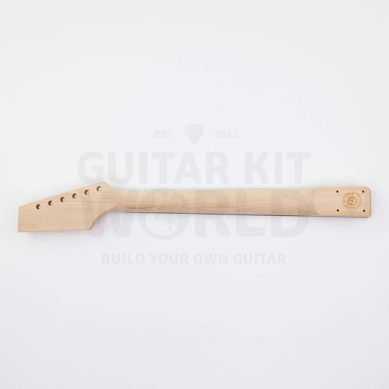

  • Bolt-on neck. Four screws and a neck plate, no glue-up and no clamping time.

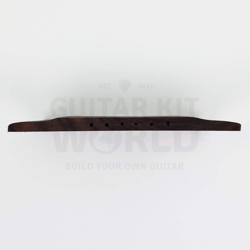

  • Pre-drilled pinless bridge. String holes already drilled and the position scaled at the factory, so you are not measuring intonation or drilling the bridge yourself.

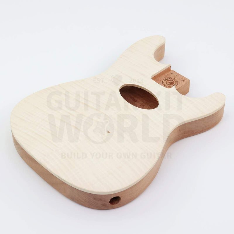

One part to take your time over: the veneer top
The flame maple top is a thin sheet of real wood, so sand it lightly by hand and go easy at the edges. A stain and clear coat shows the flame best: see Guitar Finishing 101 and How do you stain a veneer?, then a sunburst once you are comfortable. If the top does not come out the way you hoped, paint it: a solid color covers any sand-through. That is the finish in our own build, step by step in the assembly manual.
  • Pre-wired electronics with plug-in connectors keep the wiring simple, no soldering needed
  • The bridge position is scaled at the factory and the pickup wire hole is pre-drilled through the top, so you are not measuring intonation yourself
  • The pinless bridge arrives with its string holes already drilled, so there is no bridge drilling at home

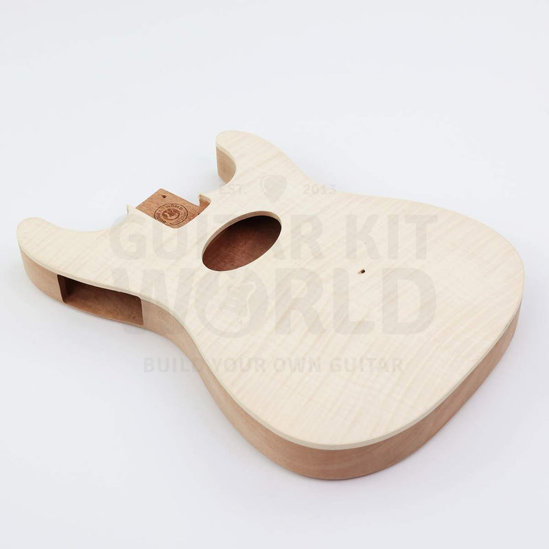

  • Tuner and strap button screws need pilot holes, and the output jack cable is routed through the hollow body

  • Hollow basswood body with flame maple veneer and ivory binding (unfinished)

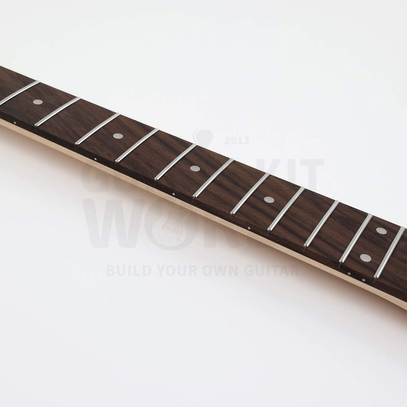

  • Bolt-on maple neck with rosewood fretboard and blank headstock (unfinished)
  • Piezo pickup
  • Pre-wired preamp with master volume, 4-band EQ, and integrated 9-volt battery box
  • Output jack and jack plate (pre-wired to the harness)
  • Wooden pinless acoustic-style bridge with pre-drilled string holes and saddle
  • 6x closed chrome tuning machines with bushings and washers
  • Neck plate with screws
  • Strap buttons with screws
  • Allen wrenches
  • Set of strings
  • 1/4" instrument cable
