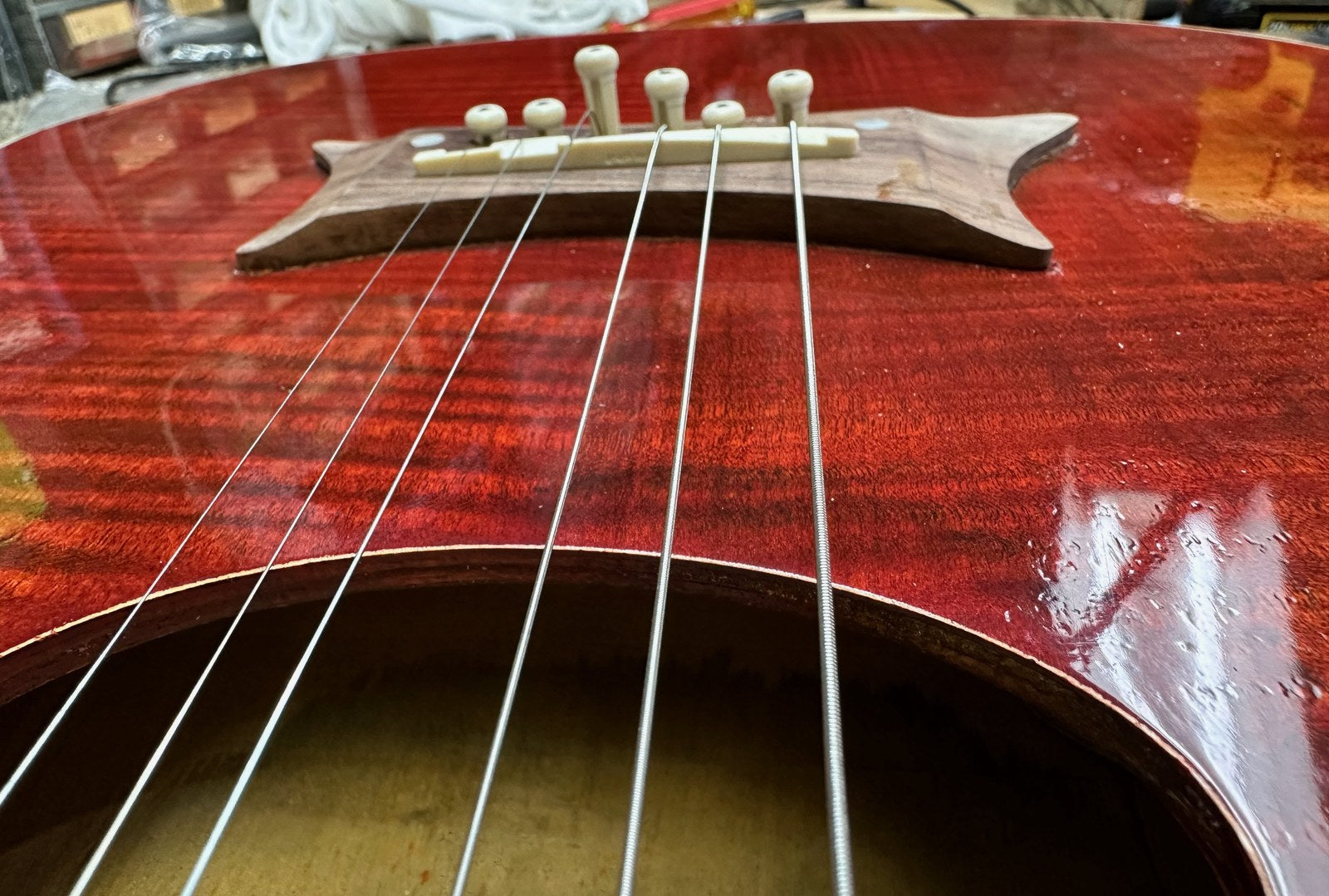

Type 1: Fitting a bridge with pins
The traditional setup. Six holes run through the bridge and the top. You drop the string in ball end first and push a pin in behind it, and the pin wedges the ball against the underside of the top.
Order of work: position and mark the bridge, drill the pin holes, glue the bridge down, then ream the holes to fit your pins.
Drilling: back the top with a support block so the bit does not tear out the underside as it breaks through. Go slow, and keep the bit perpendicular to the top.

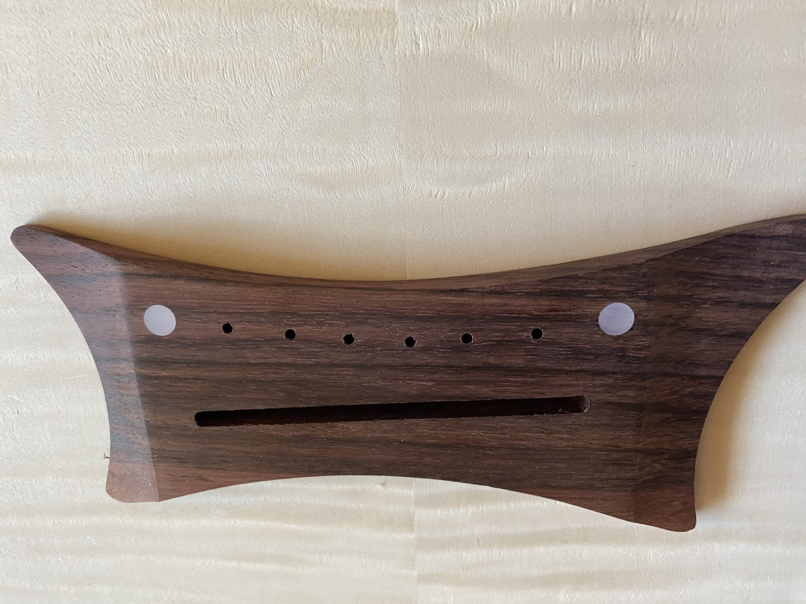

Before: the bridge off the guitar, saddle slot cut and the six pin holes drilled straight through.After: the same bridge glued down and strung. The six pins sit behind the saddle, each holding a string ball end against the underside of the top. Photos by Andy Jensvold, who built this kit.

On a pinless bridge the string enters from behind and the ball end catches on a shelf inside the bridge. Nothing can work loose under tension because there is no pin to work loose, and restringing is quick once the pattern is familiar.
If your bridge already has the rear holes, there is nothing to drill. Glue it down and string it up.
If it does not, a plain bridge does not become pinless on its own. You have to drill the rear holes yourself, and both the spacing and the angle have to be right or the strings will not sit straight over the saddle. Mark your spacing from the saddle rather than from the edge of the bridge, start with a bit well under your final diameter, and step up gradually. A hole drilled slightly small can be opened up. A hole drilled slightly wrong cannot be moved.

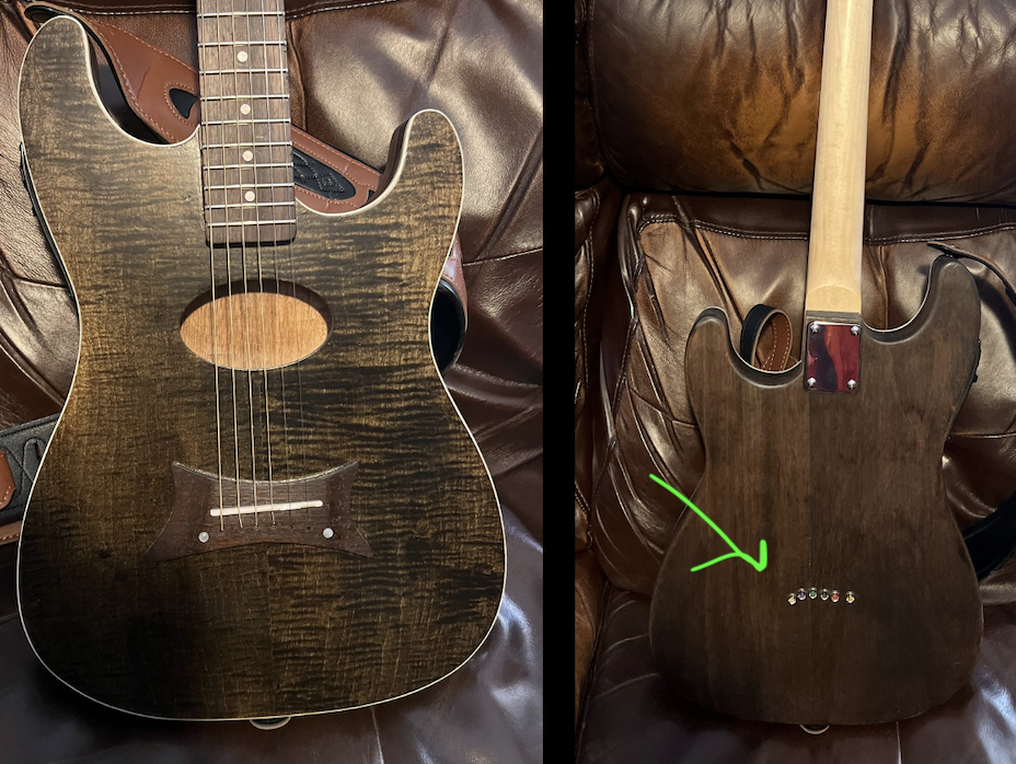

Here the strings pass through the body itself and anchor in ferrules set into the back, the way a string-through electric works. Builders choose it for the steeper break angle over the saddle. It is the most involved of the three and the least forgiving, because you are drilling through the whole instrument.
Order of work:
Position the bridge and mark the string holes.
Work out where your internal bracing and any center block sit, and confirm the holes will clear them.
Plan the piezo wire route before you drill, so no string ends up crossing or pinching it.
Drill the six holes through the body.
Fit the ferrules on the back.
Glue the bridge down, then string up through the body and over the saddle.
A finished body-through build. The six ferrules sit in a line on the back of the body, below the control plate. Photo by a Guitar Kit World builder.
