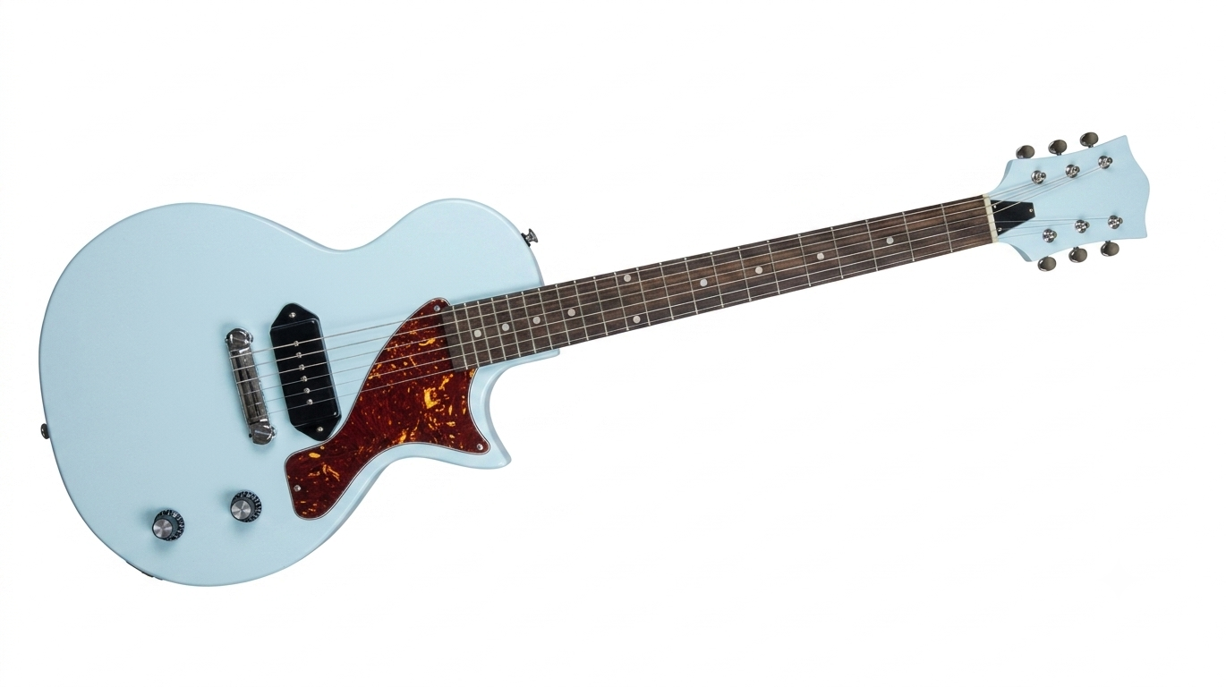

The payoff
Mark: How does the finished kit play and stack up, in your experienced hands?
Jamie: I would say I have the bug and am already looking at other kits to see which one I want to build next. I love my blue single-cutaway guitar. It is quite the little rocker. Perfect for the type of music I like to play.
The finished guitar: strung, set up and, in Jamie's words, "quite the little rocker". Courtesy of GuitarCollectorGuy.
