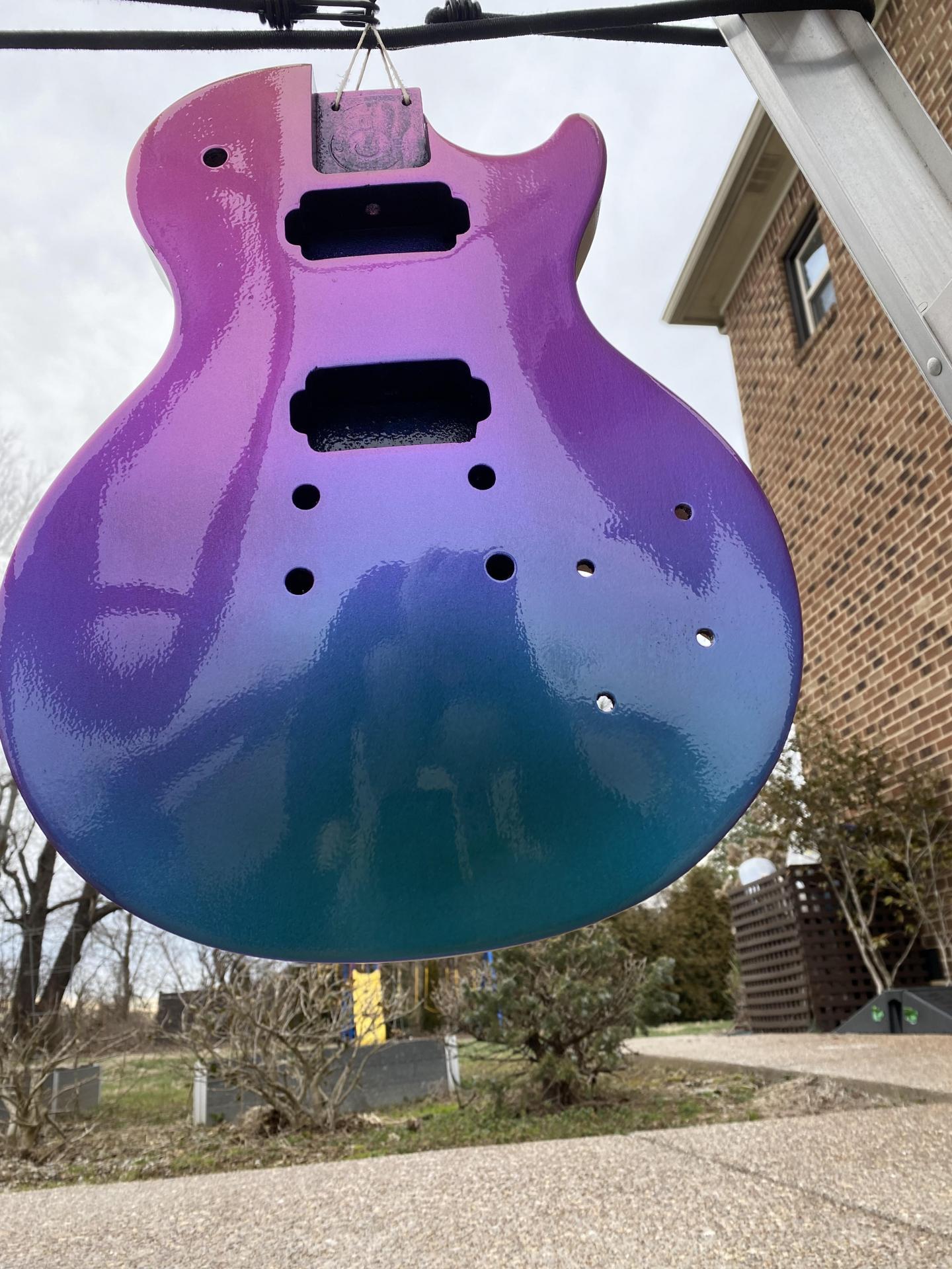

Color-shifting guitar body finish in progress, a custom finish on a DIY guitar kit from Guitar Kit World
A color-shift finish in progress from the Guitar Kit World community.

The spray can approach is the most popular paint method among kit builders because it requires no special equipment. Sand the body, apply 2 coats of primer, 3 to 4 coats of color, and 3 to 4 coats of clear. Wet sand with 1000 to 2000 grit between final coats for a smooth surface, then polish for gloss. See how to paint a solid body guitar for the full process.
The keys to a good spray finish: light coats (no drips), consistent distance (10 to 12 inches), warm and dry conditions, and patience between coats. Most beginner mistakes come from spraying too thick or not waiting long enough between coats.

An HVLP (High Volume Low Pressure) spray gun produces finer atomization and more even coats than a rattle can. The investment in equipment makes sense if you plan to build multiple guitars or want the smoothest possible finish on a special build.
