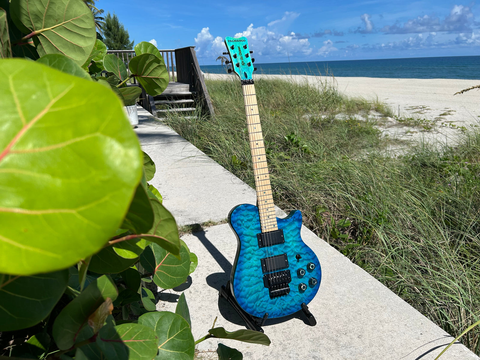

From the bench to a beach photoshoot
The guitar debuted at a beach photoshoot, which suits a top that looks like water. The kit is the same one anyone can order. The color, the decals, the matching back covers and the springs are theirs, and there will never be another one like it.
Ginger's turquoise quilted maple guitar standing in beach grass with the ocean behind it
At the beach photoshoot, a top that looks like water. Courtesy of Ginger.
The finished turquoise quilted maple guitar on a stand outdoors at the beach photoshoot
The quilt catches the sun at the shoot. Courtesy of Ginger.
