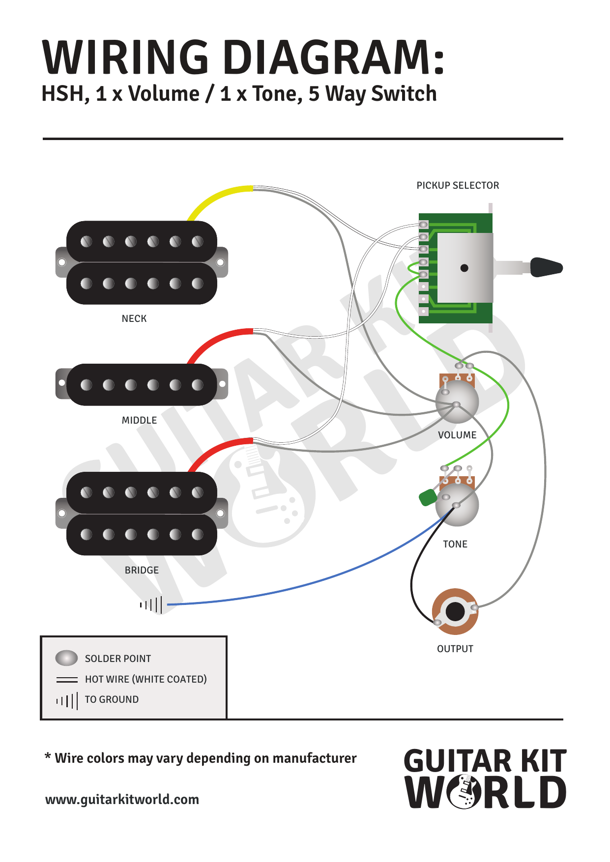

HSH Wiring Diagram: 1 Volume, 1 Tone, 5-Way Switch
Wiring for two humbuckers and a single coil with 1 volume, 1 tone, on a 5-way blade switch. Free to download and print. Used by 4 Guitar Kit World kits, listed on the page.

What this diagram covers
| Pickups | 3: humbucker (bridge), single coil (middle), humbucker (neck) |
| Switch | 5-way blade switch |
| Output | Mono output jack |
| Tone capacitor | Wired across the tone pot, as shown on the diagram |
| 1 (toward the bridge) |
Bridge humbucker lead, rhythm with bite |
| 2 |
Bridge humbucker and middle single coil thinner, funkier |
| 3 (centre) |
Middle single coil clean rhythm |
| 4 |
Middle single coil and neck humbucker warm, hollow |
| 5 (toward the neck) |
Neck humbucker warm lead, jazz |
