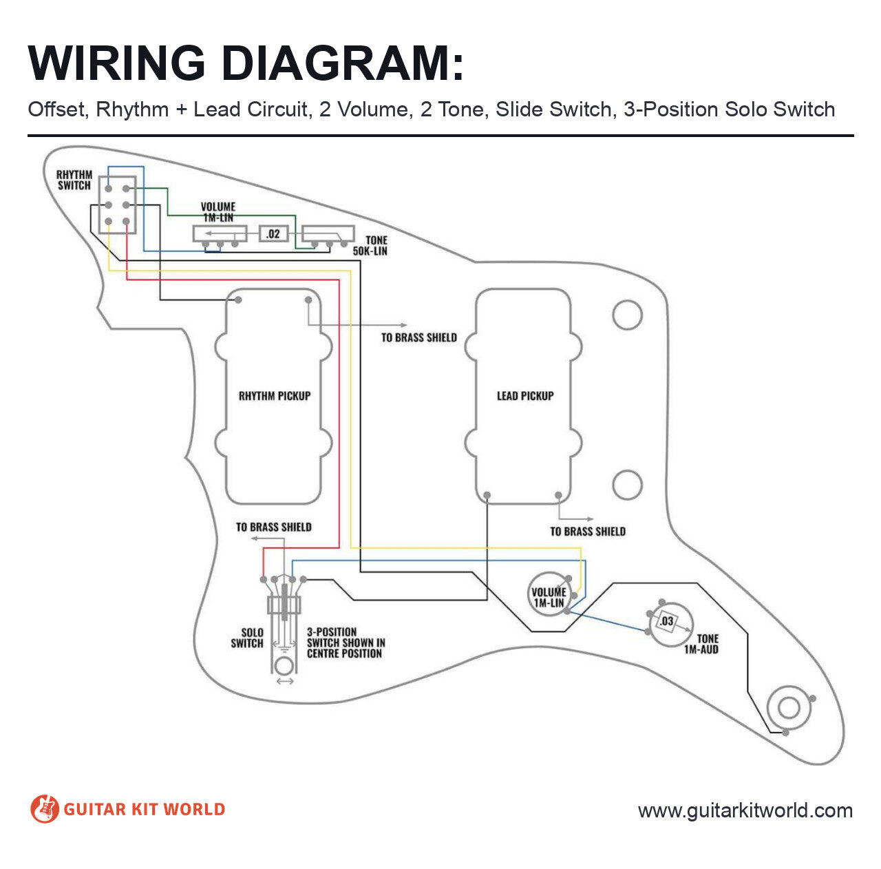

Offset Wiring Diagram: Rhythm and Lead Circuit, 2 Volume, 2 Tone, Slide Switch
Wiring for two offset pickups on a rhythm and lead circuit with 2 volume, 2 tone. Free to download and print. Used by 4 Guitar Kit World kits, listed on the page.
This diagram covers this pickup layout, running through 2 volume, 2 tone.
What this diagram covers
| Controls | 2 volume, 2 tone |
| Output | Mono output jack |

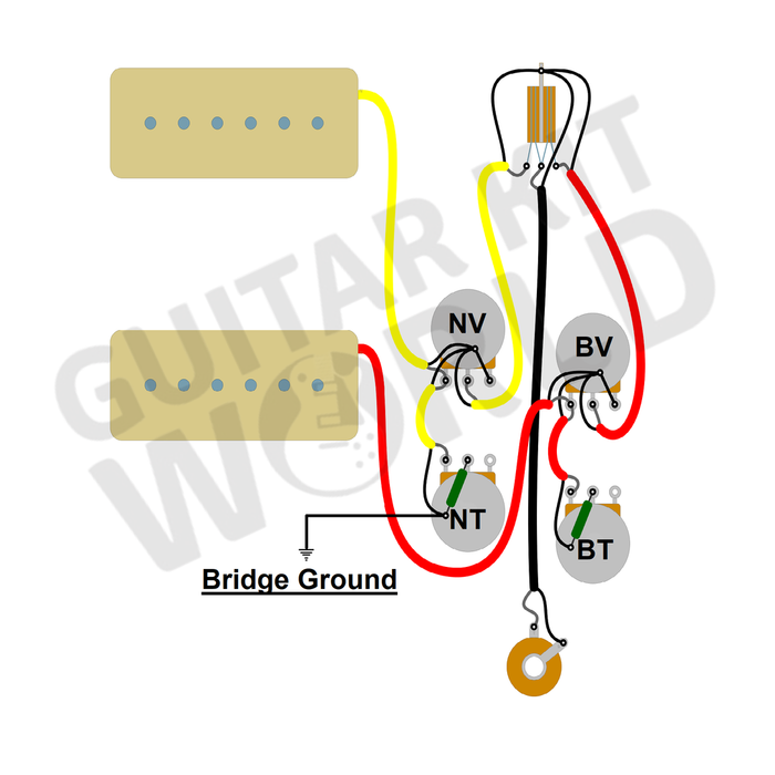

2x P90 Wiring Diagram: 2 Volume, 2 Tone, 3-Way Switch
Wiring for two P90 pickups with 2 volume, 2 tone, on a 3-way selector switch. Free to download and print. Used by 2 Guitar Kit World kits, listed on the page.Read now
