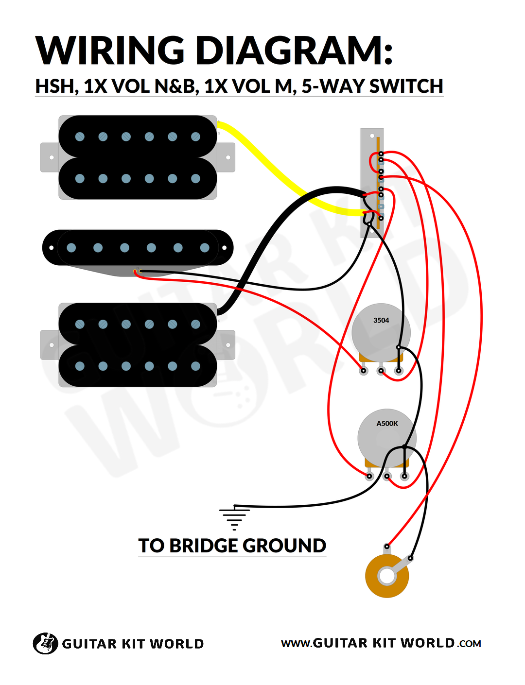

Wiring for two humbuckers and a single coil with 1 volume, no tone control, on a 5-way selector switch. Free to download and print. Match it to your own control cavity before you solder.
This diagram covers a humbucker at the bridge and a single coil at the middle and a humbucker at the neck, running through 1 volume, a 5-way switch.
What this diagram covers
| Pickups | 3: humbucker (bridge), single coil (middle), humbucker (neck) |
| Controls | 1 volume, no tone control |
| Switch | 5-way selector switch |
| Output | Mono output jack |
| 1 (toward the bridge) | Humbuckerlead, rhythm with bite |
| 2 | Humbucker and Single coilthinner, funkier |
| 3 (centre) | Single coilclean rhythm |
| 4 | Single coil and Humbuckerwarm, hollow |
| 5 (toward the neck) | Humbuckerwarm lead, jazz |
