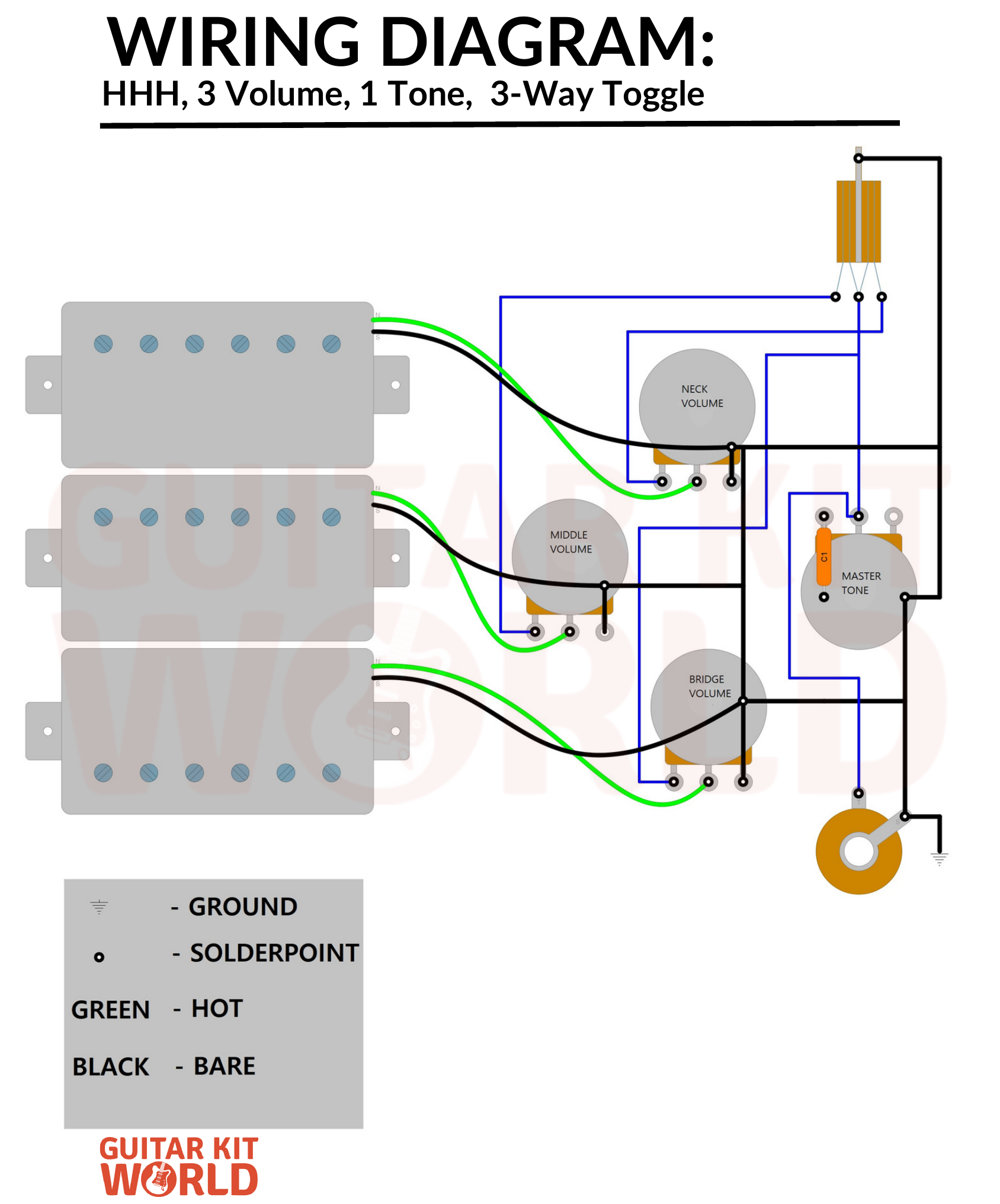

HHH Wiring Diagram: 3 Volume, 1 Tone, 3-Way Toggle
Wiring for three humbuckers at bridge, middle and neck with 3 volume, 1 tone, on a 3-way selector switch. Free to download and print. Match it to your own control cavity before you solder.
This diagram covers a humbucker at the bridge and a humbucker at the middle and a humbucker at the neck, running through 3 volume, 1 tone, a 3-way switch.
What this diagram covers
| Pickups | 3: humbucker (bridge), humbucker (middle), humbucker (neck) |
| Controls | 3 volume, 1 tone |
| Output | Mono output jack |
