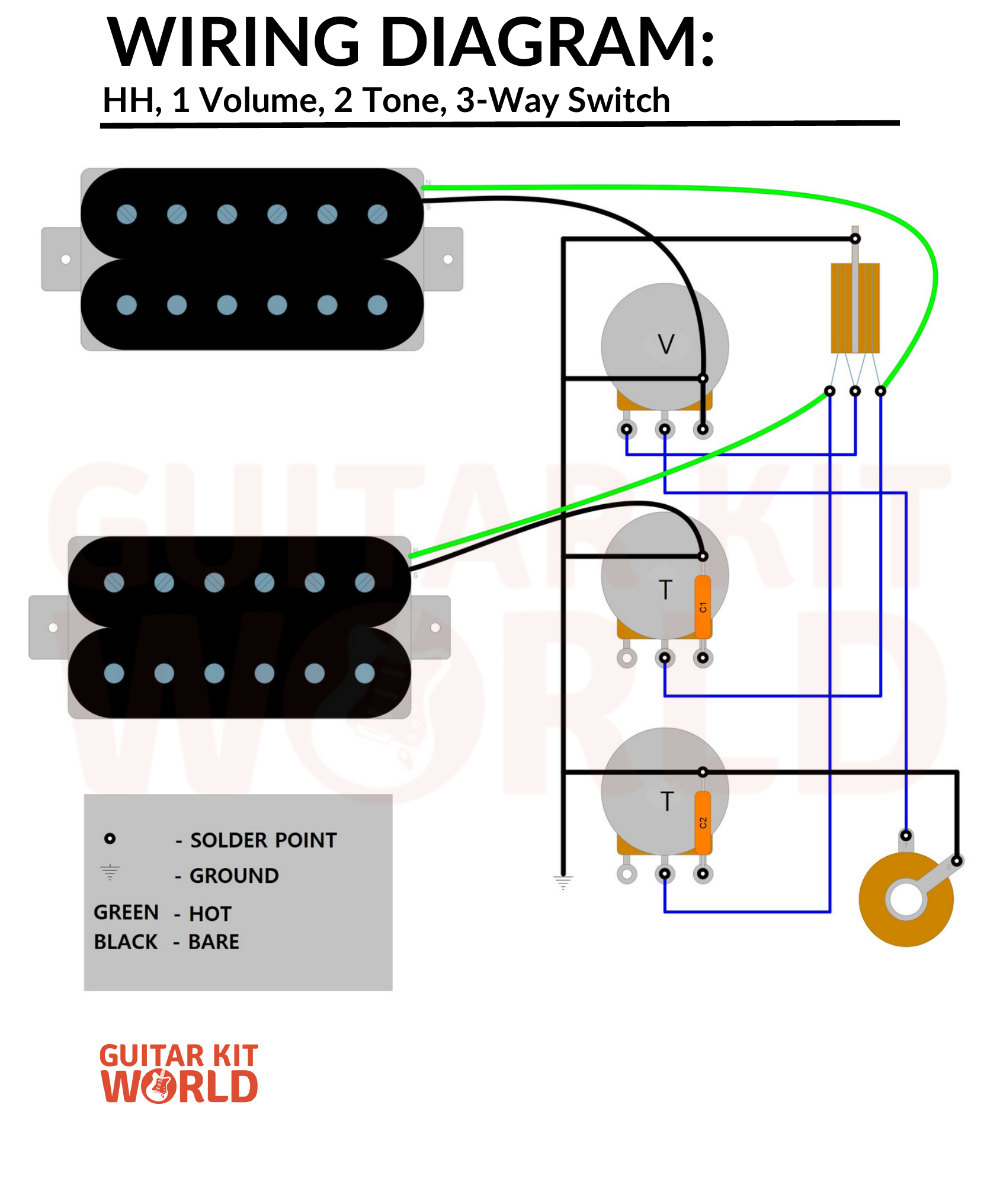

Wiring for two humbuckers at bridge and neck with 1 volume, 2 tone, on a 3-way selector switch. Free to download and print. Used by 8 Guitar Kit World kits, listed on the page.
This diagram covers a humbucker at the bridge and a humbucker at the neck, running through 1 volume, 2 tone, a 3-way switch.
What this diagram covers
| Pickups | 2: humbucker (bridge), humbucker (neck) |
| Controls | 1 volume, 2 tone |
| Output | Mono output jack |
| 1 (toward the bridge) | Humbuckerbrighter, more attack |
| 2 (centre) | Both pickups togetherbalanced, fuller |
| 3 (toward the neck) | Humbuckerwarmer, rounder |
