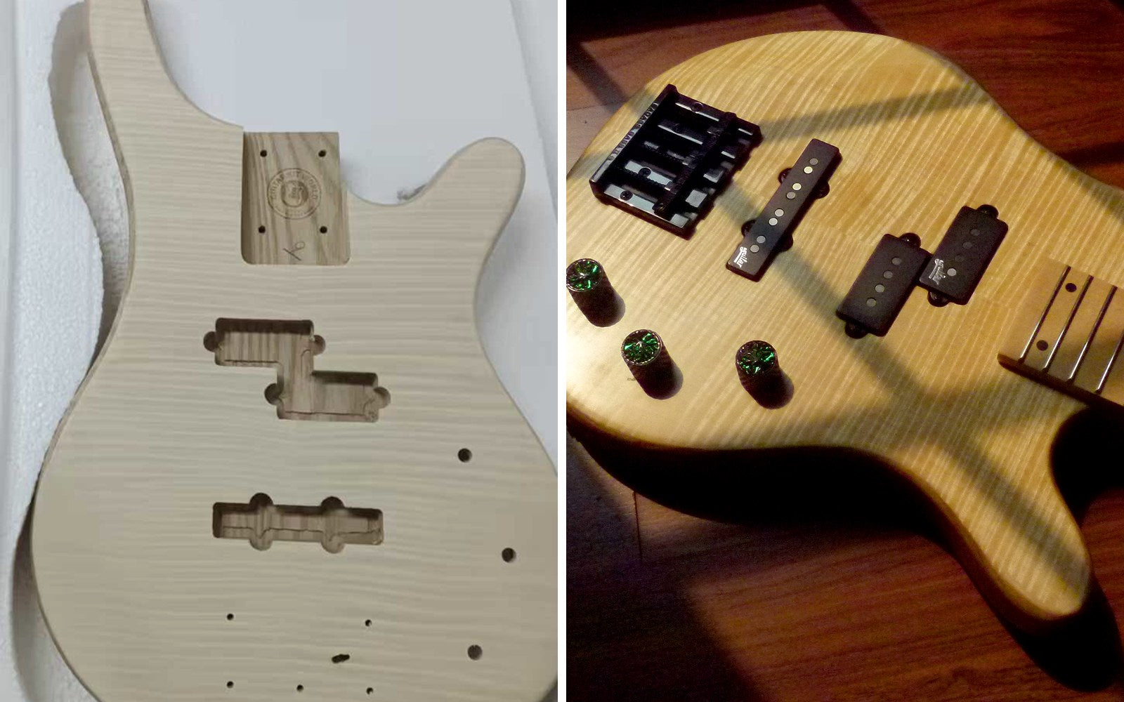

Unfinished flamed maple bass body beside the same bass finished in natural oil with black hardware
Bill Arico builds guitars in Findlay, Ohio, for people who play them. He does not play himself. This one was for his daughter, a working bass player in two bands, and it had to solve a problem her current instrument could not: it had to stop diving. He started with our WB Bass Guitar Kit with Flamed Maple Top, Maple Fretboard, a 279.99 USD kit with an ash body, a flamed maple veneer top and a maple neck, and the reason that kit suited the job is the reason most people overlook. Ash and maple are light to begin with, and on a bass the starting weight is most of the battle.

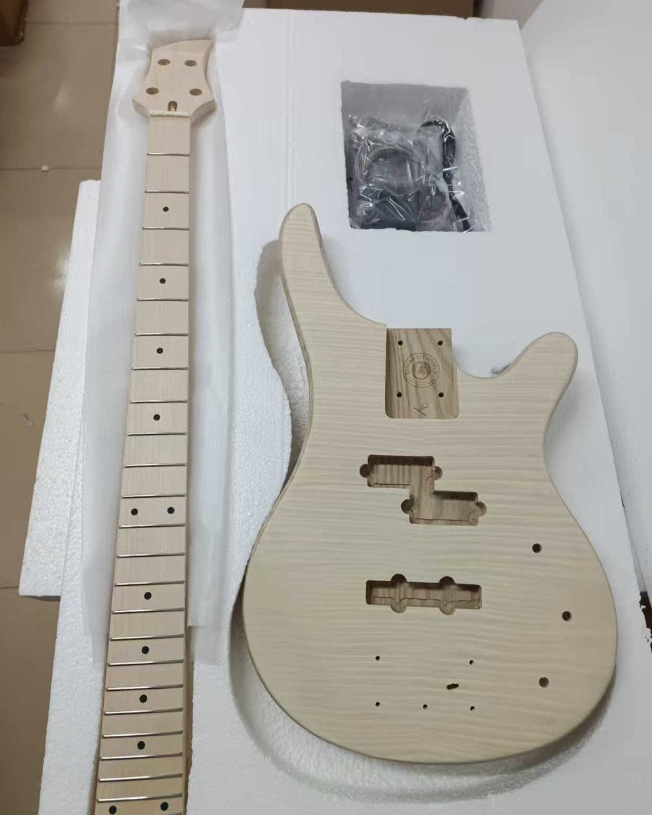

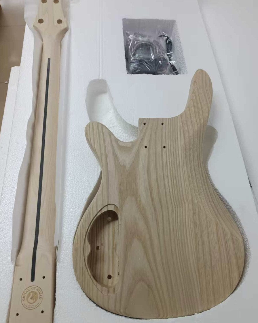

Unfinished bass kit body with flamed maple veneer top and routed P and J pickup cavities, beside a bare maple neck
The kit as it shipped: flamed maple veneer over ash, cavities and holes already routed, maple neck and fretboard.

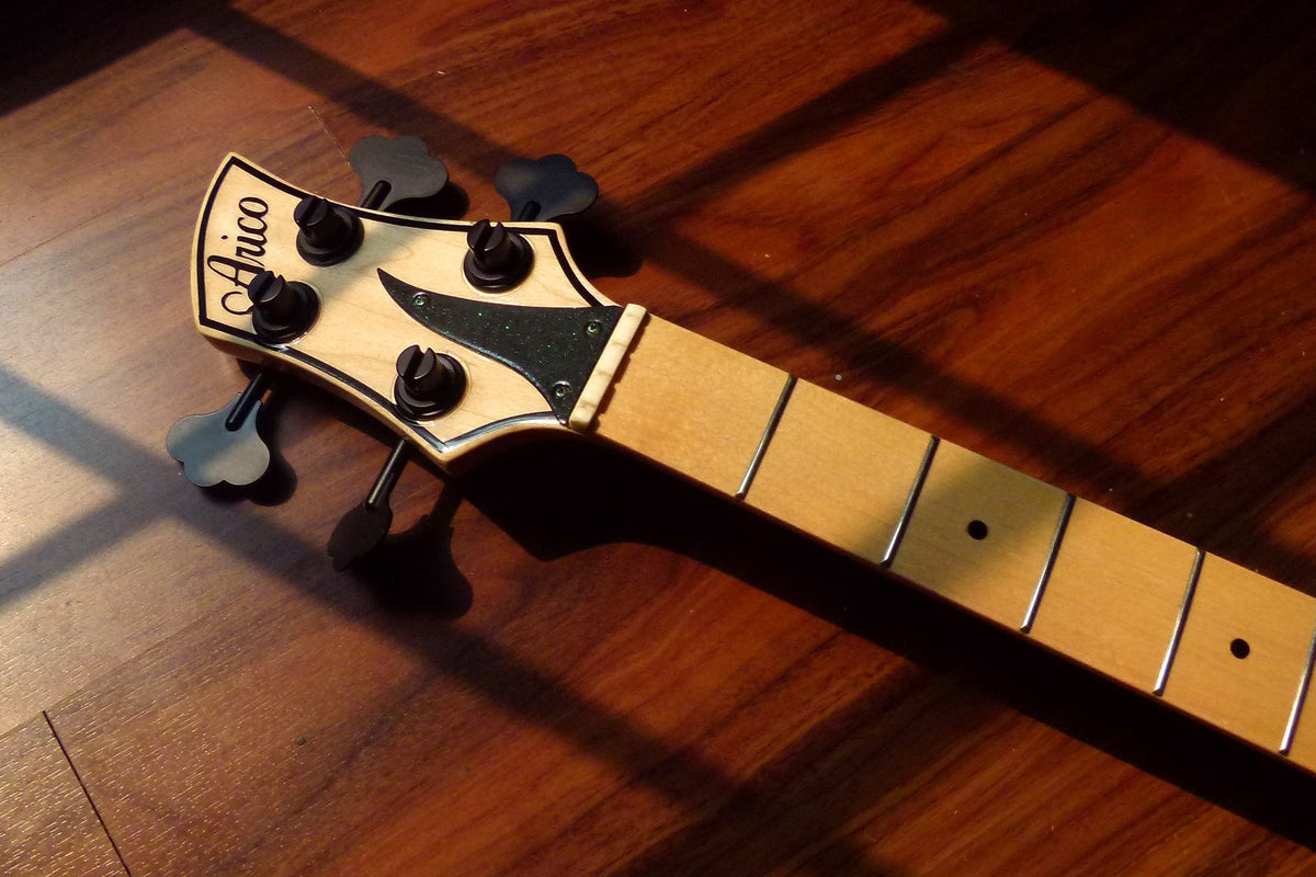

Bill went at the lever arm directly. Ultralight tuning machines were the single biggest change he made to the kit.
In order to alleviate the neck dive problem, I chose ultralight tuning machines.
Bass headstock with a script Arico logo, black ultralight tuners with clover-shaped keys, and a bone nut
The fix, in one frame: four ultralight machines on a two-a-side headstock, and the maker's own name where a brand normally goes. Courtesy of Bill Arico.

  • He chose a kit whose wood was already on his side. An ash body and a maple neck start light. Had he begun with a dense body he would have been trying to subtract weight that was never going to come off.

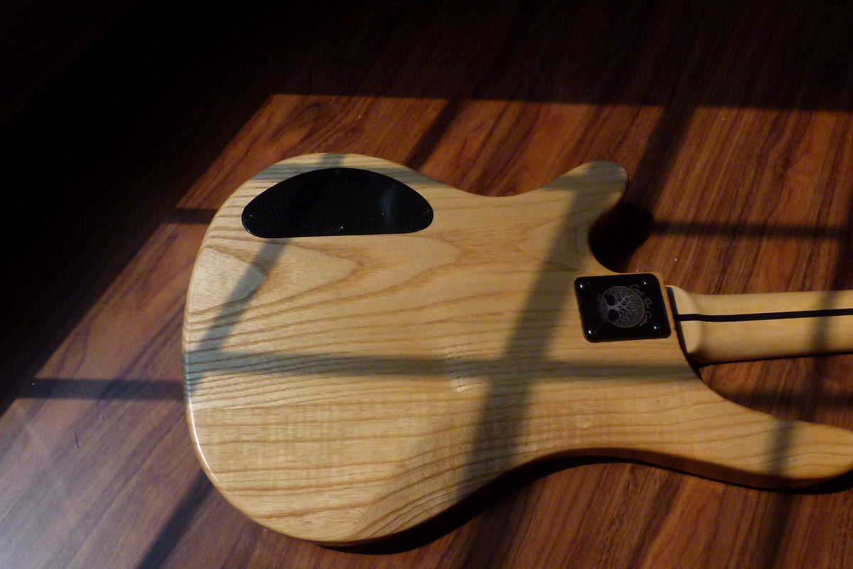

Back of an unfinished ash bass body showing open straight grain, with the control cavity routed
The back of the body before any finish. That open, straight, coarse grain is ash, and it is why the kit starts light.

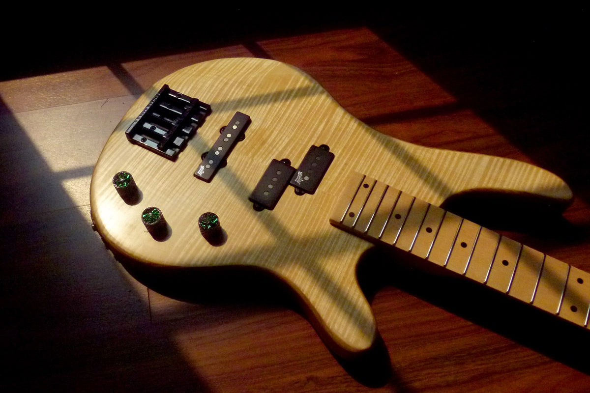

Mostly, and this is the useful part of the story. Bill replaced the electronics and hardware with US-made parts chosen for service life, because the instrument was going to be gigged rather than admired. His own reason for doing it is the honest one:
Part of the fun for me is shopping for all the best components and creating something that can be played for a lifetime.
He fitted ultralight tuning machines, a high-mass bridge, a matched pair of hum-cancelling pickups for the split and single-coil positions, CTS potentiometers with an Orange Drop capacitor, and a neck plate and rear control cover he had engraved himself. Three things did not simply drop in, and all three are predictable if you know to look.
One: the shielding he added made the pickups too tight.
My biggest problem was my own fault. I shielded all the control cavities and pickup cavities with copper shielding. That little bit of shielding made the pickups super tight in the space but a little grinding/sanding took care of it.

Finished natural bass with black high-mass bridge, split and single-coil pickups and three control knobs on flamed maple
The upgraded hardware in place: high-mass bridge, hum-cancelling split and single-coil pickups, and three knobs over two volumes and a tone. Courtesy of Bill Arico.

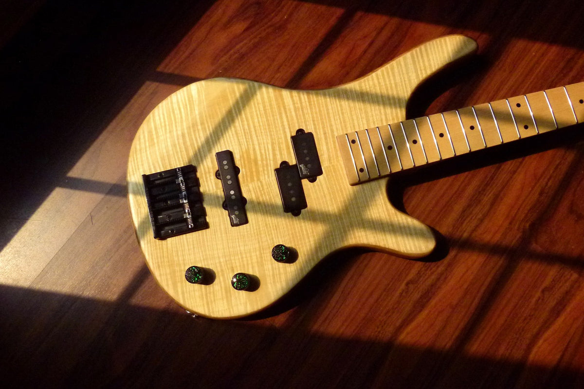

Finished natural oil bass leaning in low afternoon light, flamed maple top with black hardware and maple fretboard
The finished instrument in low afternoon light, which is the only light that shows flame honestly. Courtesy of Bill Arico.
Look at where the flame sits. It runs in tight, even bands across the lower bout and stays in register across the center seam of the veneer, which is a bookmatch that was laid down carefully rather than just laid down. The black hardware is doing real work here too: against a pale, warm, unstained top, black reads as a drawn outline rather than as another color competing with the wood.
Back of the finished ash bass showing straight open grain, oval control cavity cover and an engraved black neck plate
The back, oiled. The engraved neck plate carries a tree of life, and it is the one part of this bass that was never going to come out of a box. Courtesy of Bill Arico.

  • For neck dive, start at the headstock. Lighter tuners buy you more balance per gram than any other change, because they sit at the far end of the lever.
