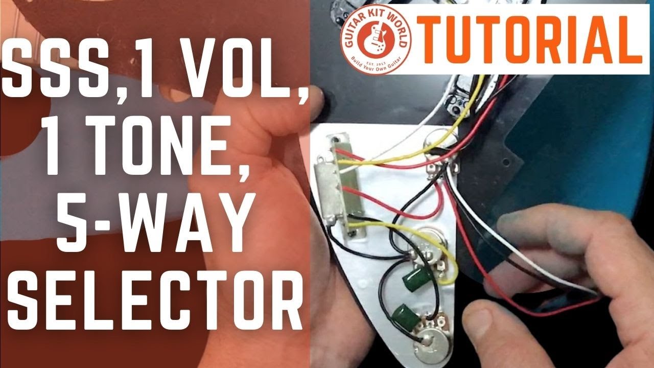

Watch this wiring done step by step
How to Wire 3 Single Coils with a 5-Way Selector, from the Guitar Kit World workshop.
