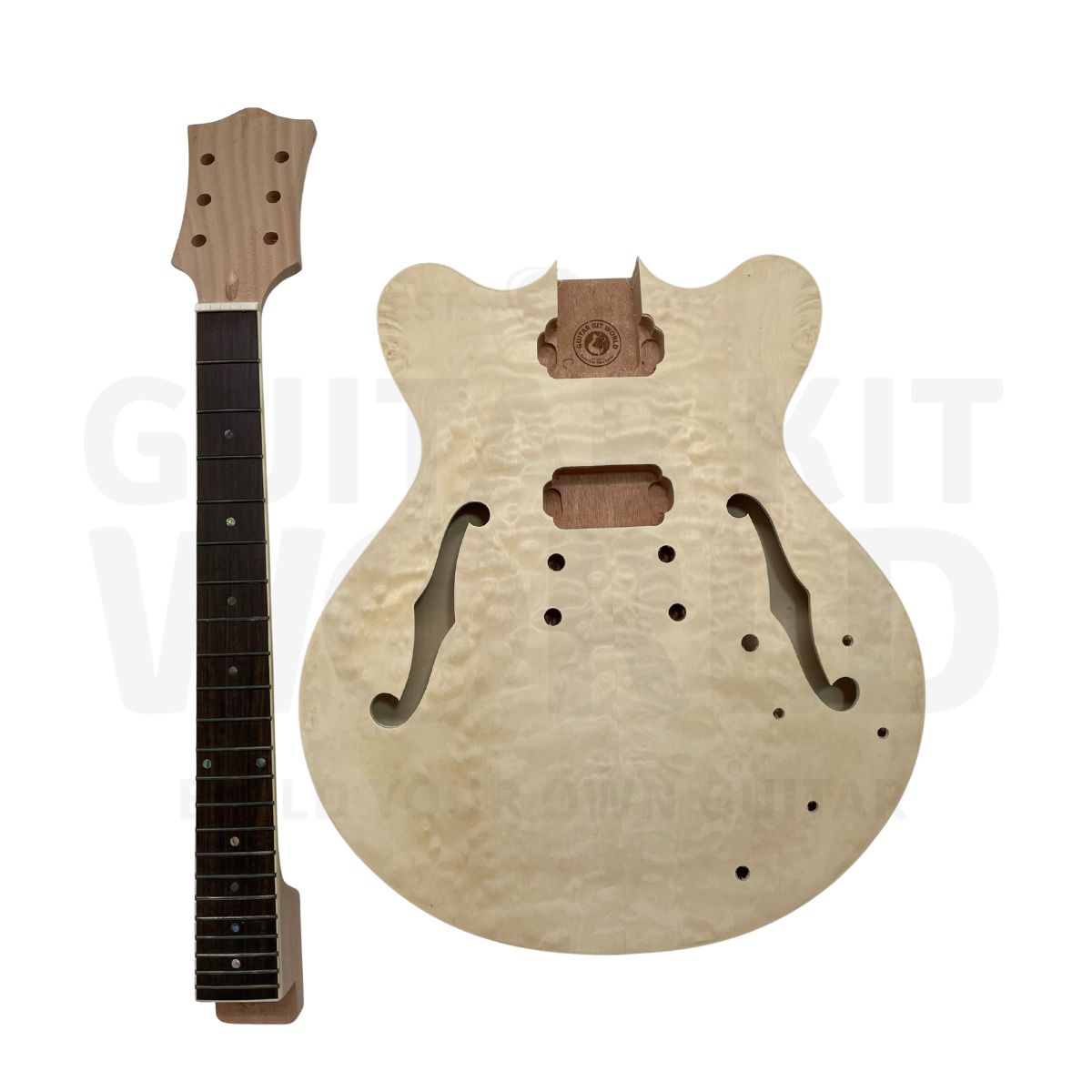

Semi-Hollow
Weight: Medium (chambered center block reduces weight)
Comfort: Wider body, sits naturally on the leg
Access: Varies by cutaway design
Best for: Jazz, blues, indie, rockabilly, warm resonance with feedback resistance
