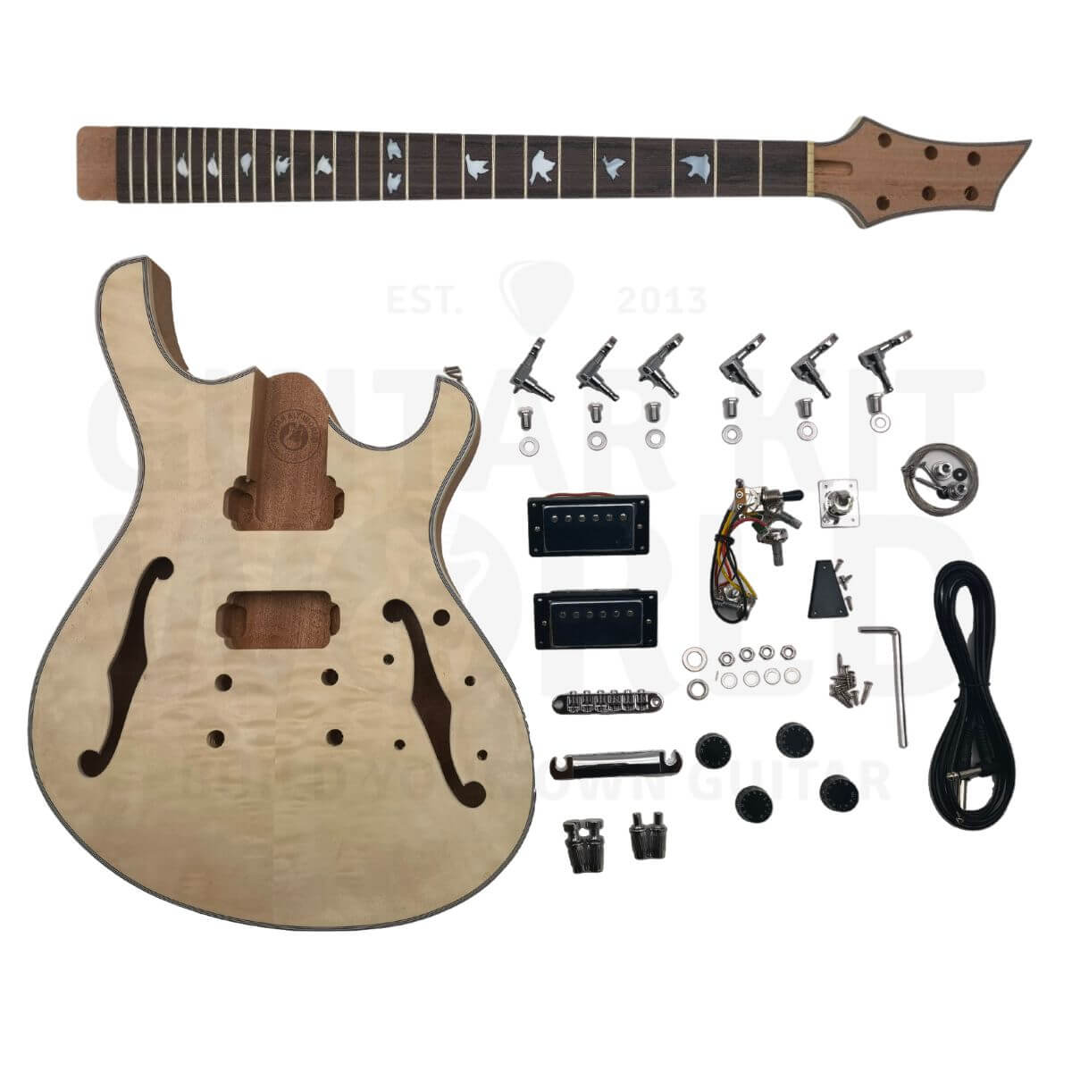

Semi-Hollow: Acoustic Warmth, Electric Versatility
Semi-hollow guitars have a solid center block running the full length of the body, with a hollow chamber on each side of it. The center block provides feedback resistance at high gain, while the hollow wings add acoustic resonance, warmth, and a touch of natural compression. F-holes on the top are functional, not decorative: they let air move inside the chamber.
Who it suits: Players who want warm, expressive tone with natural resonance. Jazz and blues musicians. Worship players who need clean headroom. Anyone who wants a guitar that sounds good unplugged too.
