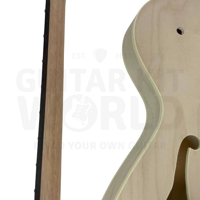

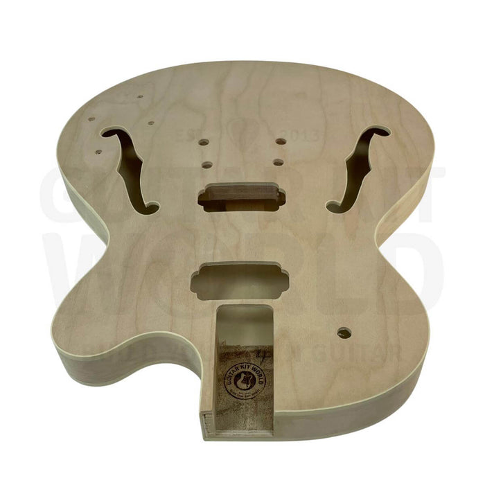

Build your own classic blues inspired thin hollow body guitar. Featuring a laminated maple body with maple center block, set-in mahogany neck, Ebonized fretboard, and dual humbuckers for warm tone and dynamic response. Ideal for players seeking vintage character with modern reliability.

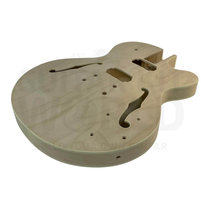

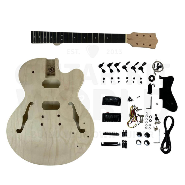

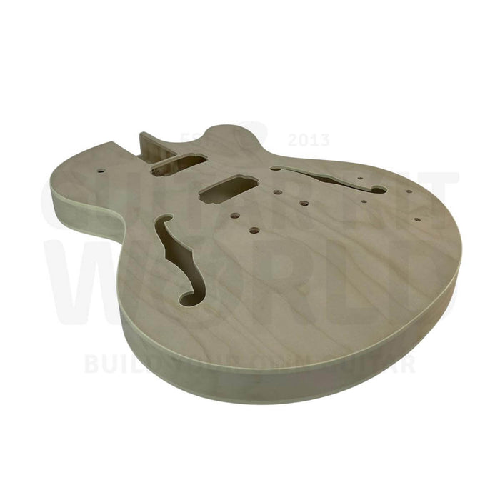

  • Unfinished thin hollow body with two f-holes, two routed pickup cavities and a routed neck pocket

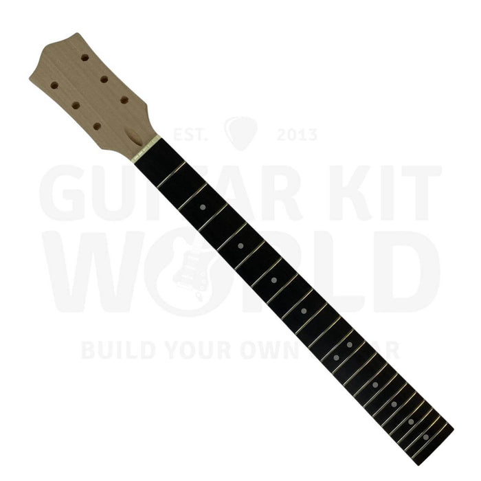

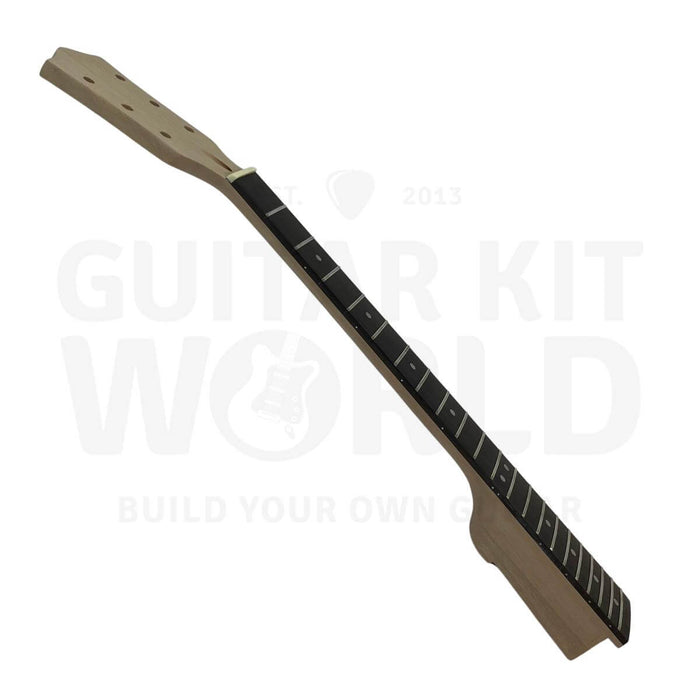

  • Neck with dark fretboard, dot position markers, ivory binding and a drilled headstock
  • 6x black sealed tuners with bushings, washers and mounting screws
  • 1x set of strings
  • 2x black strap buttons with washers and screws
  • 2x black-covered humbuckers with mounting rings and lead wires
  • 1x large black pickguard
  • 1x black bell-shaped cover plate with two screws
  • 1x black switch washer ring
  • 1x wiring harness with pots, capacitor and output jack on yellow, red and black wires
  • 1x toggle switch with a black tip, nut and washer
  • 1x black bridge with six adjustable saddles, two posts and thumbwheels
  • 1x black bar tailpiece with two mounting studs
  • 4x black knurled knobs
  • 1x bag of black mounting screws
  • Assorted chrome nuts and washers

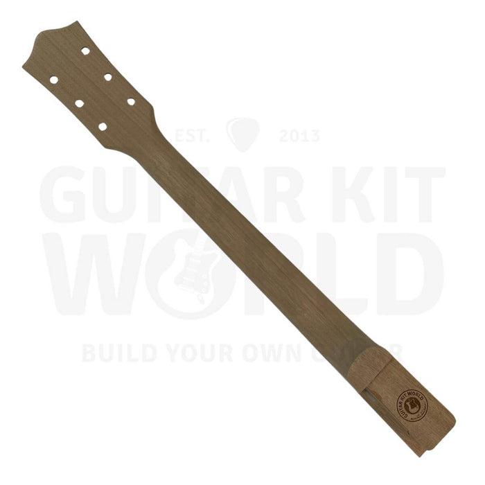

Why is there a thin strip of wood on the side of the neck heel?
Some of these kits have a thin wood shim glued to the side of the neck heel. The factory adds it while fitting each neck to its body, so the neck sits snug in the pocket and the strings line up. It is a normal part of the fit. Dry-fit the neck before you glue it. If it is too tight, sand the shim only, a little at a time, and test the fit between passes until the neck slides in with firm hand pressure. Do not remove the shim.
Thin wood shim glued to the side of a hollow body guitar kit neck heel, circled in red
