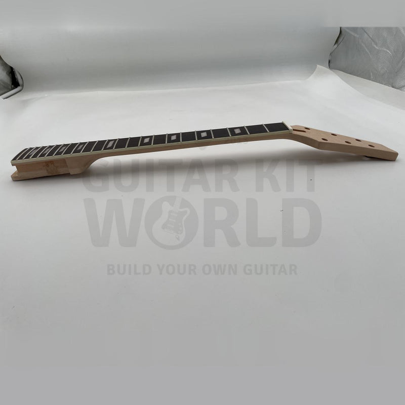

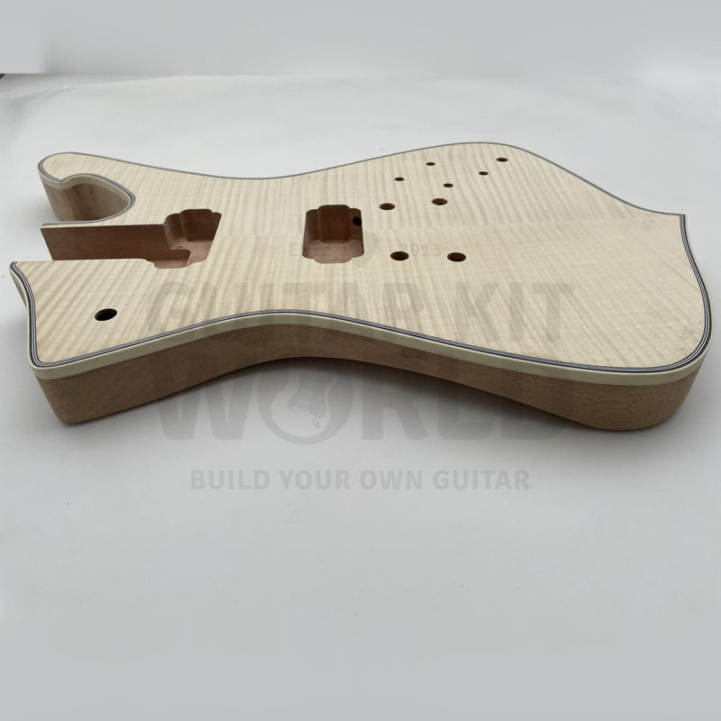

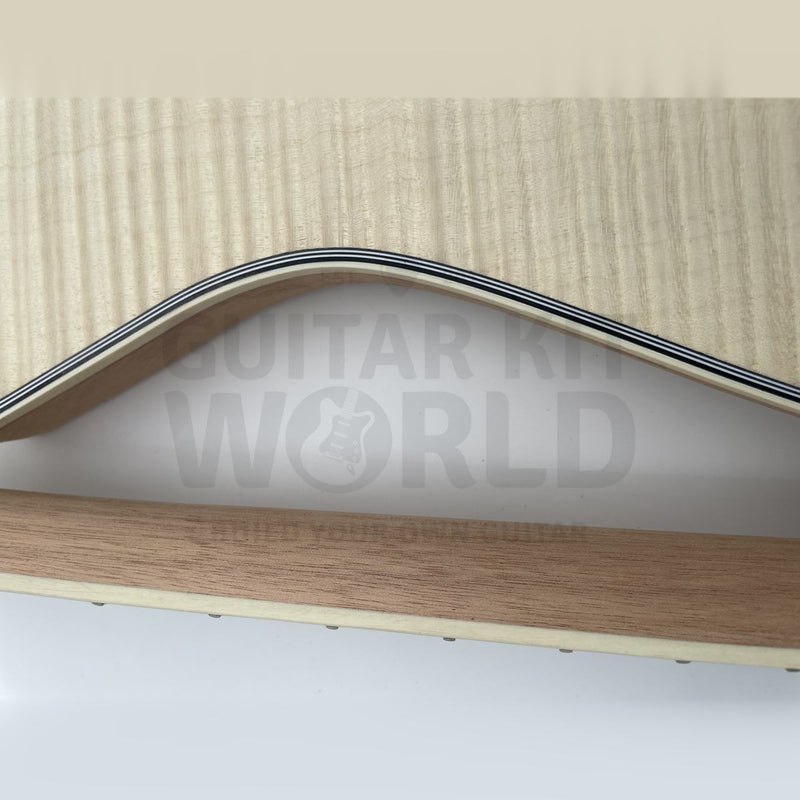

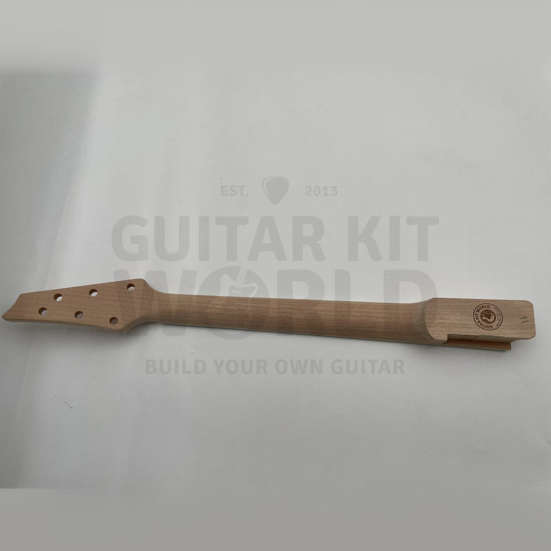

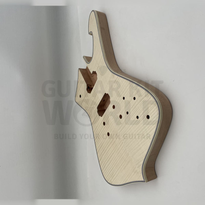

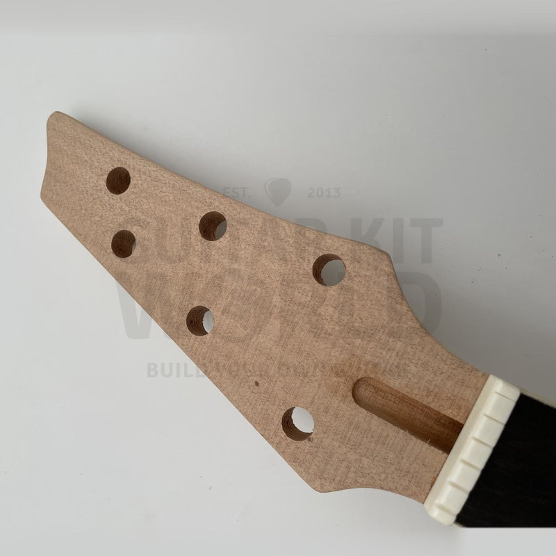

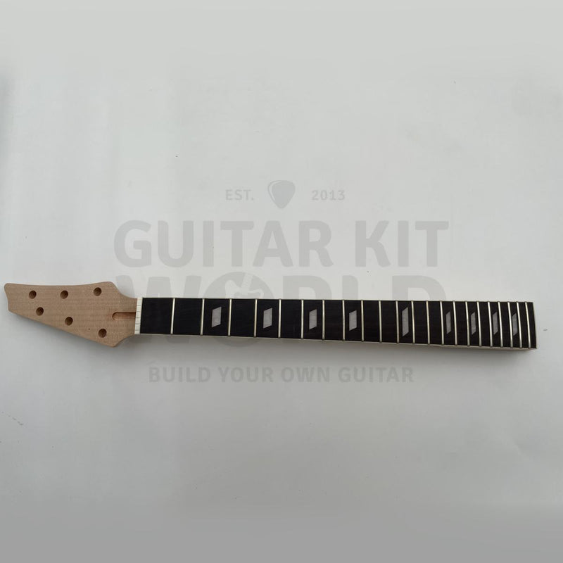

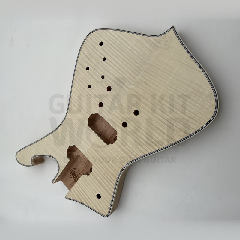

A set-in-neck DIY guitar kit built on our Hookline body, a pointed single-cutaway whose lower bout sweeps into a downward hook, topped with a flame maple veneer. Solid mahogany body and mahogany neck, a bound rosewood fretboard with white pearloid parallelogram inlays, multi-ply ivory body binding and a full gold hardware set. The veneer takes a translucent stain or burst beautifully. The electronics ship loose rather than pre-wired, so this build includes soldering.
  • Set-in neck joint requires gluing and clamping, and the fit must be checked before glue-up
  • Electronics are not pre-wired, so soldering is required for pickups, pots, switch and jack
  • The flame maple veneer is thin, so sand lightly and never power-sand the top, or you will cut through the figure
  • Multi-ply body binding and bound fretboard must be masked carefully when finishing
  • Binding: Multi-ply, ivory outer
  • Top: Flamed maple veneer on the front (thin sheet, about 0.5 mm); plain mahogany back

  • Inlay Shape: Parallelogram
  • Side Dots: Yes

  • Tuner Layout: 3+3

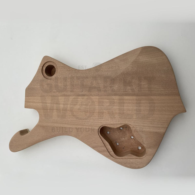

  • Mahogany guitar body (unfinished) with flame maple veneer top and multi-ply ivory binding

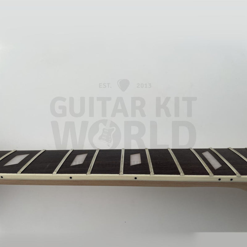

  • Mahogany set-in neck (unfinished) with bound rosewood fretboard, 22 frets and white pearloid parallelogram inlays

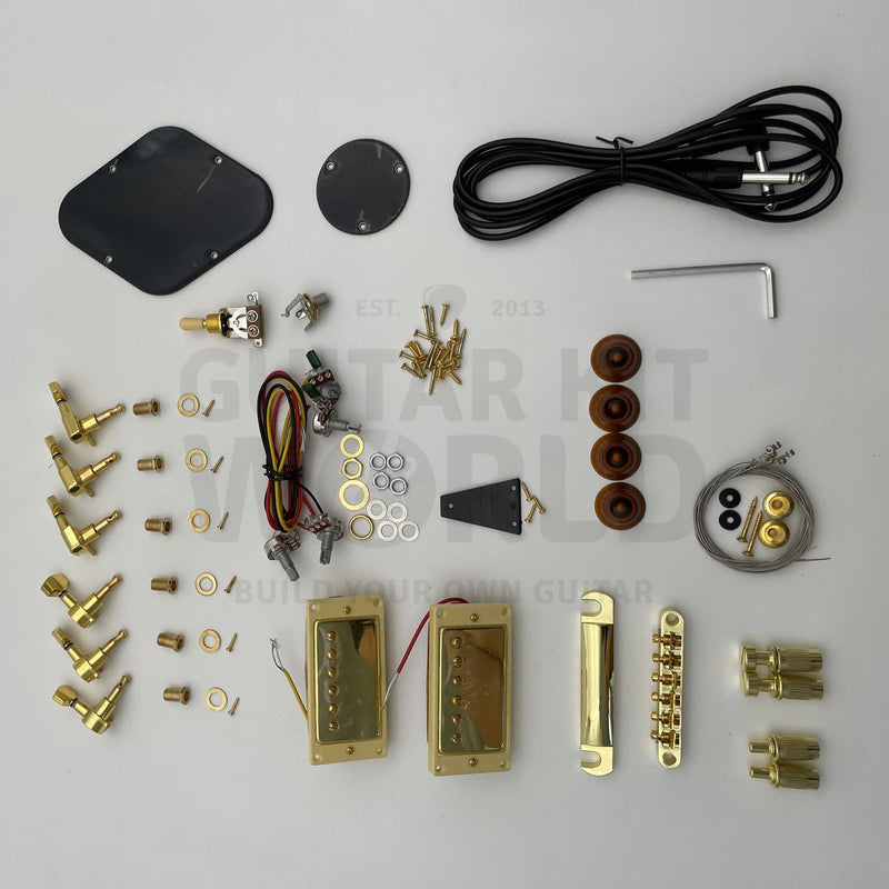

  • 2x gold-covered humbucker pickups (neck and bridge)
  • Gold adjustable bridge and stopbar tailpiece with mounting studs
  • 6x gold sealed diecast tuners (3+3) with bushings and screws
  • Wiring kit: 2 volume pots, 2 tone pots, 3-way toggle switch, output jack, hook-up wire
  • Bone nut
  • 4x amber bell knobs
  • Black bell truss rod cover
  • Black rear control cavity cover and round switch cavity cover
  • 2x gold strap buttons
  • Mounting screws
  • Steel strings
  • Guitar cable

No routing required: all cavities, holes and channels are pre-cut.

Is the top solid flamed maple?
No. The top is a thin flamed maple veneer glued onto the body. Sand it lightly so you do not sand through it.
