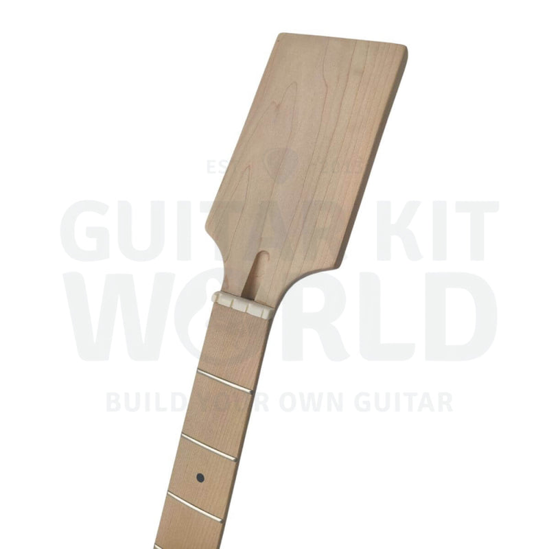

  • Blank headstock ships undrilled and unshaped, so you cut the outline and drill the tuner holes yourself

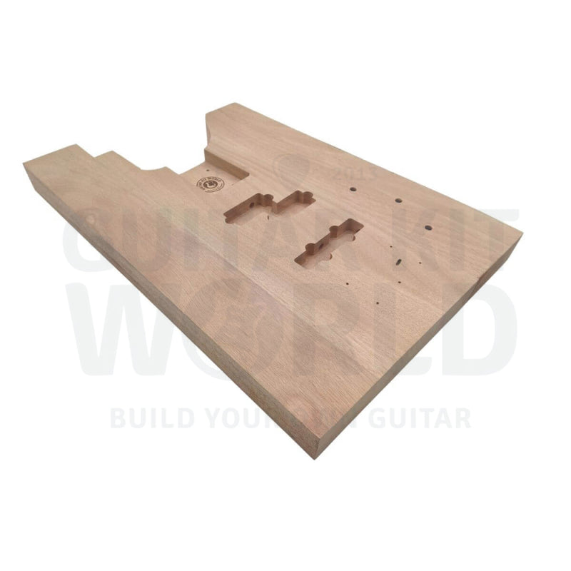

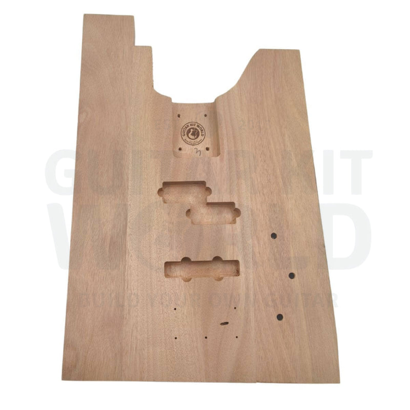

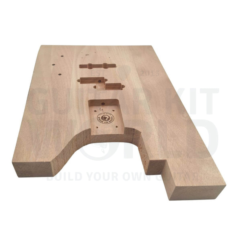

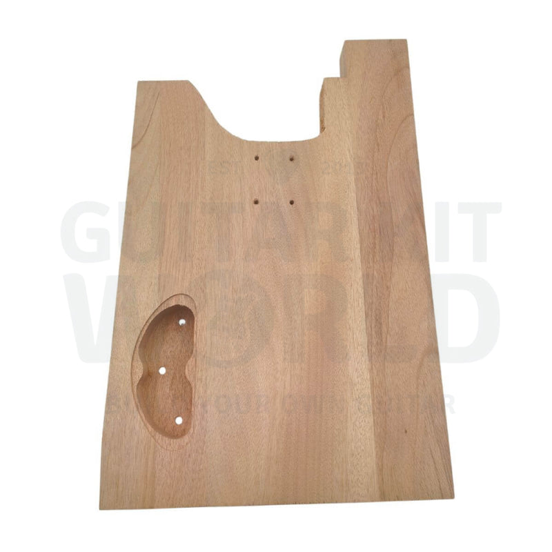

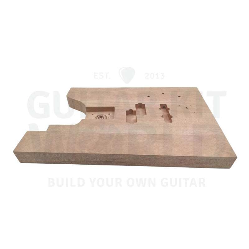

  • Bass body blank with squared outline and a single upper cutaway, routed for a split-coil pickup, a bar pickup, a control cavity and a neck pocket (unfinished)

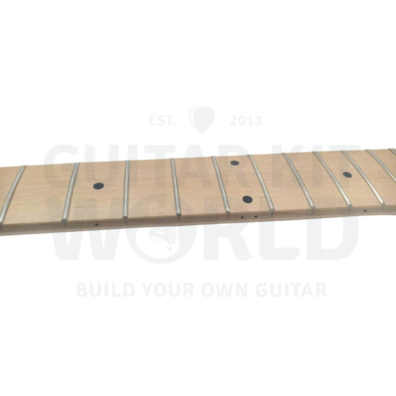

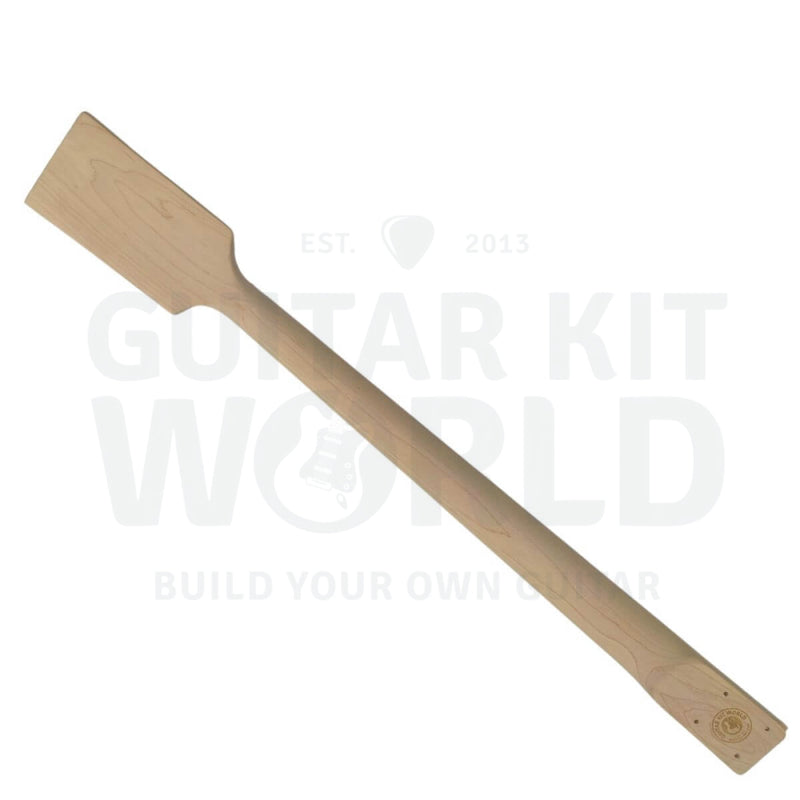

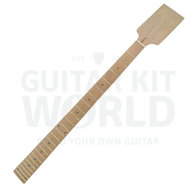

  • Maple neck with maple fretboard, dot inlays, fitted white nut and an undrilled paddle headstock

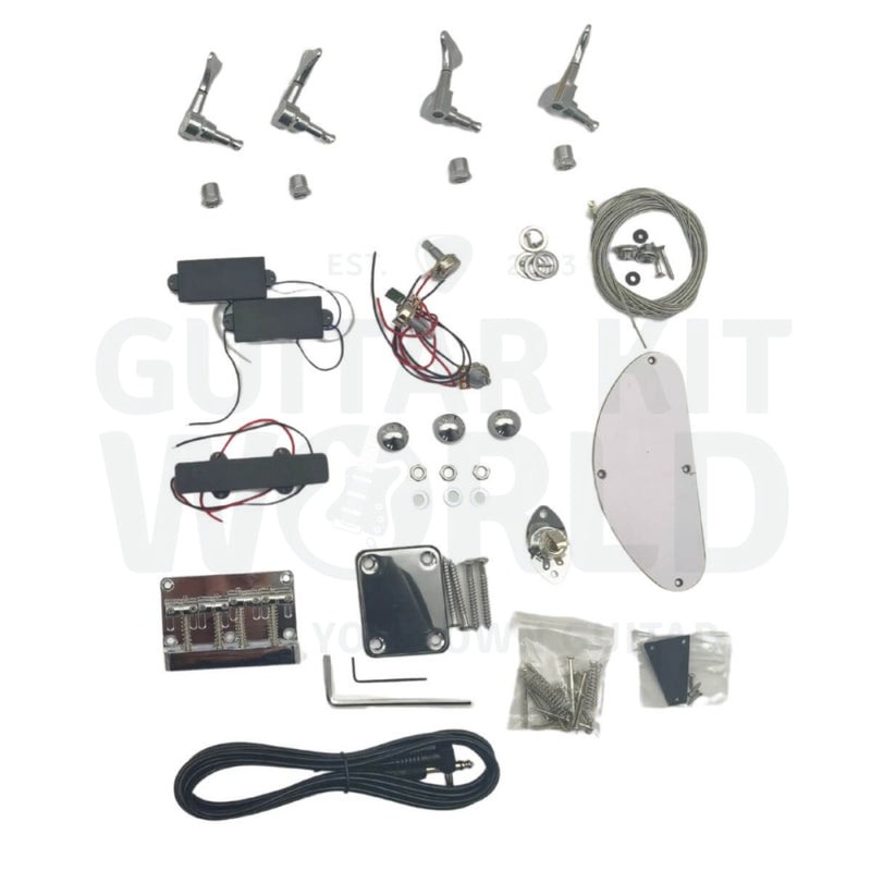

  • 4x chrome bass tuners with bushings
  • Split-coil bass pickup in two black halves
  • Black bar-style bass pickup
  • Chrome 4-saddle bass bridge plate with saddle and intonation screws
  • Pre-wired potentiometers with colored wiring loom
  • 3x chrome dome knobs
  • 3x pot nuts and 3x washers
  • White teardrop pickguard
  • Chrome oval jack plate with output jack socket
  • Chrome neck plate with four mounting bolts
  • Black trapezoid truss rod cover with screws
  • Coiled bass string set
  • Assorted screws

Woodworking required. You cut the body outline from a squared blank, cut the headstock outline and drill its tuner holes, and drill the output jack hole yourself. The neck pocket, pickup and control cavities are already routed, and the electronics need soldering.

The body is a solid slab of wood with the pickup routes, control cavity and bridge holes already cut, and the area around the neck is cut too. You cut the rest of the outline yourself. The headstock is a plain paddle with no tuner holes, so you drill them where you want them.
