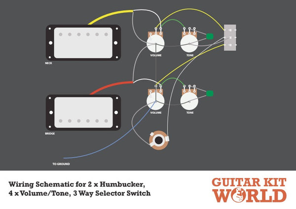

G-style Guitar Kit wiring
Below you will find an G-style guitar kit wiring diagram. The G-style is similar to the LP in regard to wiring as both guitars feature dual humbuckers and a 3-way pickup selector switch.
G-style Wiring Diagram
