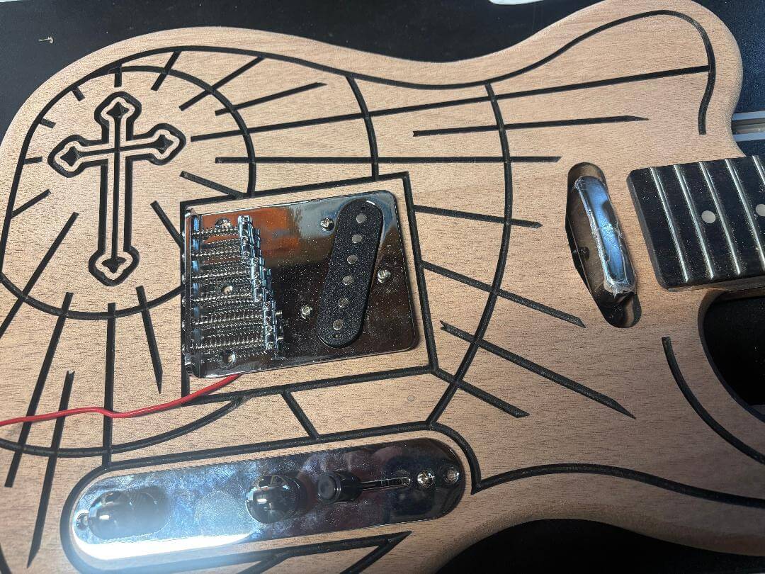

Steve chose the T-Style Blank Guitar Kit with Mahogany Body and Maple Neck. The "blank" part is what made this build possible. Unlike standard guitar kits that come with a pre-cut pickguard and routed pickup cavities, blank kits give you more freedom to customize. The body arrives with the shape already cut but without the usual routing, so you decide where everything goes.
For Steve's project, that freedom was essential. His grandson's design called for detailed carved imagery across the face of the guitar body. A standard pickguard would have covered most of it. So the pickguard had to go, and the entire top surface became a carving surface instead.

Solving the Pickup Problem
Removing the pickguard created a practical challenge. On a standard T-style guitar, the neck pickup mounts directly to the pickguard. No pickguard means no mounting point for that pickup.
Images courtesy of Steve Martin
Steve reached out to the Guitar Kit World support team, and together they worked through the solution: mounting the pickup directly to the body. The bridge pickup on a T-style guitar already mounts to the bridge plate, so that side required no changes. The end result is a fully functional two-pickup guitar with no pickguard, leaving the carved artwork completely visible.
