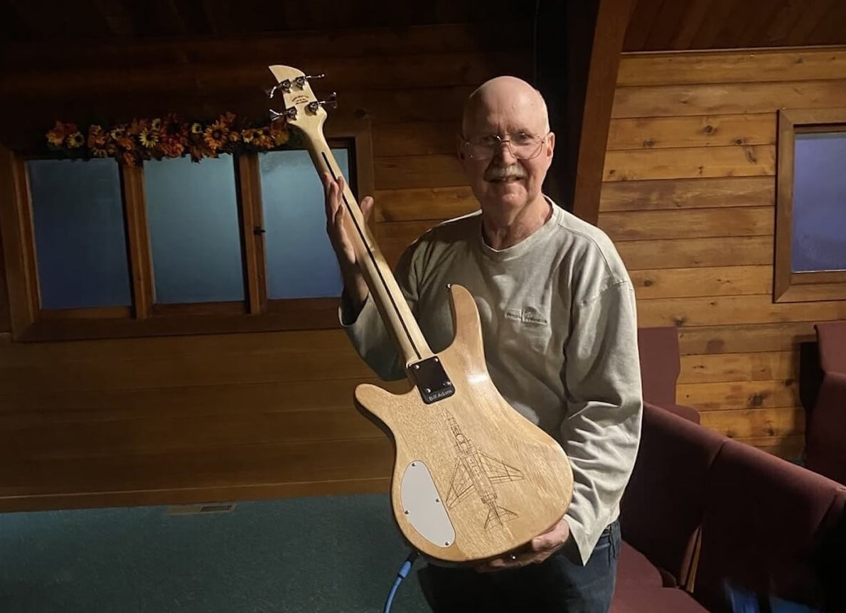

Air Force inspired engraving and a personal nameplate
The most striking personal touch on Bill’s bass is on the back. Jim’s son Josh owns a laser engraver, and together they found line art of an F4 Phantom fighter jet, chosen to honor Bill’s Air Force service, turning the back of the bass into a collaborative family tribute.
Images courtesy of Jim Larsen
They masked the back of the body with tape to minimize smoke marks, then burned the detailed outline of the Phantom into the mahogany. The result is a crisp, technical illustration that transforms the rear of the bass into a tribute panel.
Under the neck plate, Jim added another subtle personalization. Knowing Bill likes to put his name on his gear, he 3D printed a custom tag with “Bill Adam” and mounted it under the neck plate screws. It is visible every time someone looks closely at the joint, a small but meaningful signature.

The photos of Bill holding his finished bass say everything. The flamed maple top glows under the lights, the PJ pickups and upgraded hardware hint at serious tone, and the laser engraved F4 Phantom on the back ties the instrument directly to his life and service.
