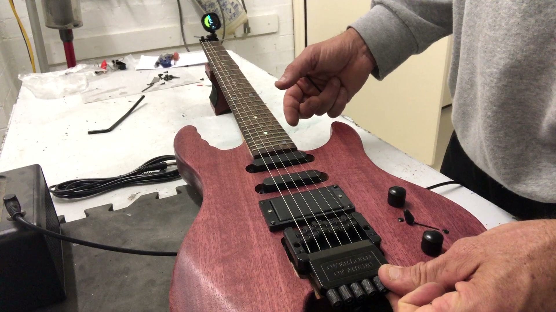

On our kits, though, the stability comes down to one thing during the build, and Marty is blunt about it in the build series: the bridge has to sit hard down on the two nuts underneath it. If it is sitting proud of them it will shift under string tension and the guitar will never hold tune. Seated correctly you can feel it, firm and fixed with no play at all.
Two more habits from his build that keep it there:
Lock the bridge before you tune or restring. There is a small lever for exactly this. Flip it and the bridge cannot move while you work.
Do not open the string jaws too far at the bridge. The ball end can unscrew itself from the claw. Seat the string, then pull the mechanism back just far enough that it cannot escape, which leaves you the most tuning range afterwards.
Tuning itself happens at the bridge with an allen key, one fine-tuner per string, down by your picking hand.

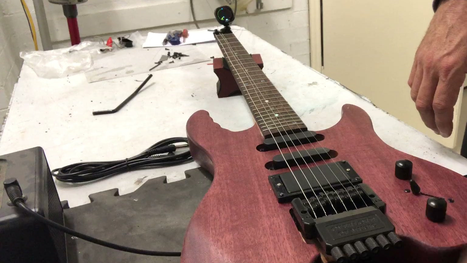

The bridge fine-tuners have a limited range. You have to bring each string close to pitch by hand before you lock the neck-end clamp. Clamp a floppy string and the fine-tuner will run out of travel before it reaches pitch, and you will be starting that string again.
New strings need stretching, properly. Marty's routine on the first tune-up is stretch, retune, stretch, retune, then stretch once more. Getting that initial tension out early is what stops the guitar drifting for the first week.

This is the part that surprises first-time builders. The HL bridge separates: pull the spring out from under the large screw and the top lifts off the base. The base is what you mount to the body, and the top assembles onto it afterwards. Before the base goes down you thread the ground wire up through a small hole in the body so it sits against the metal, because once the base is screwed down you cannot reach it. Pilot holes for the self-tapping screws go to about half depth.
The bridge has to seat hard down
Once installed, the bridge should sit hard against the two nuts underneath it. Sitting proud of them, it moves under string tension and the guitar will not hold tune. Correctly seated it feels firm and fixed with no play. This is a ten second check and it decides whether the finished instrument works.
You string it in the opposite order
Anchor the ball end at the bridge, run the string up to the neck-end clamp, pull it to near playing tension by hand, lock the clamp, then bring it to exact pitch with the bridge fine-tuner. Our kits take ordinary single ball-end strings, because the neck end clamps rather than hooking, so you do not need the double ball-end strings that some other headless systems require.
Intonation is worth one note as well. Before you set the saddles, back off the little grub screw on the side of each one, or it locks the saddle so tight that it will not move. Start with the saddles stepped back progressively for the heavier strings, roughly where they would sit on a conventional electric, then fine-tune from there.
