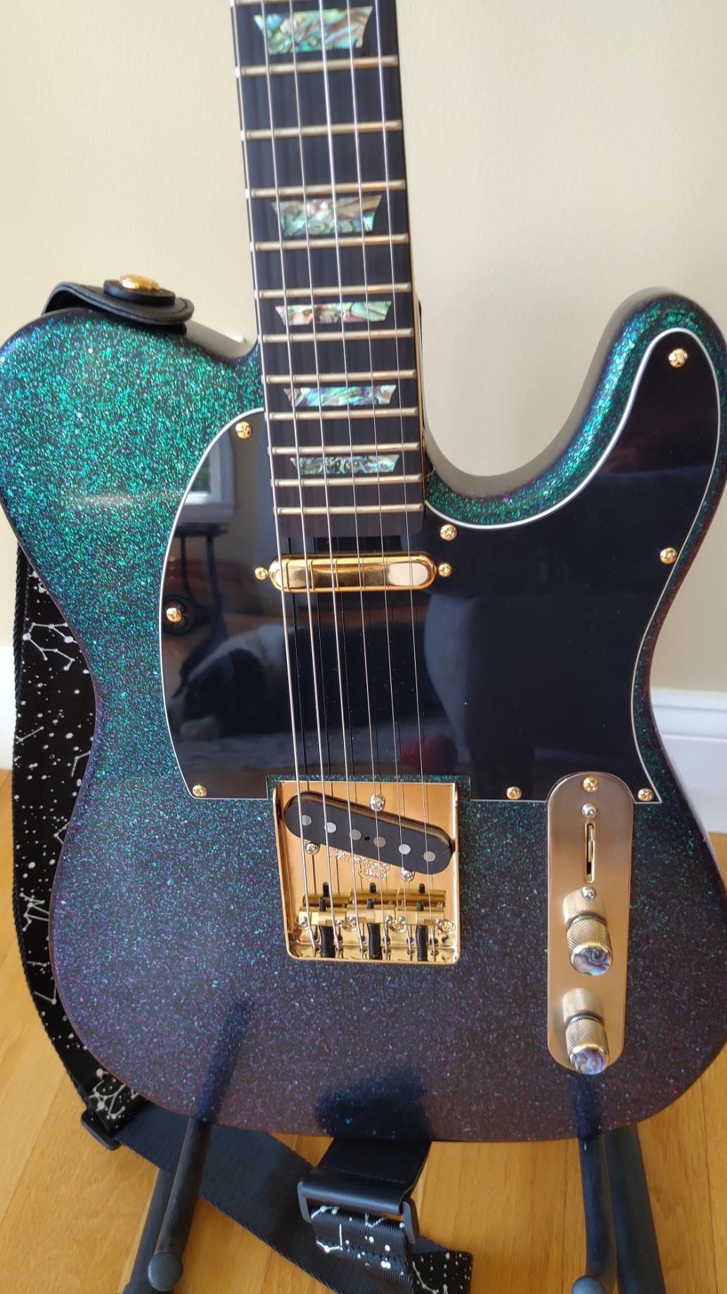

A completed TE-style kit build from the Guitar Kit World community.
