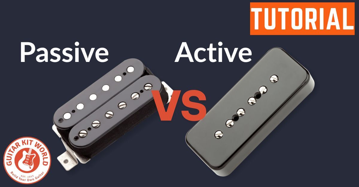

Active Pickups
Active pickups are a more modern innovation, featuring built-in preamps powered by a battery (commonly a 9-volt battery, image attached). They are known for their high output and clarity.
Characteristics:
Tone: Active pickups provide a cleaner, more precise sound with a consistent output. They are often described as having a "sterile" or "clinical" tone, which can be a benefit or a drawback depending on the player's preference.
Construction: These pickups include a built-in preamp and require a battery to operate. The preamp boosts the signal directly from the pickup, leading to higher output.
Output: Active pickups are known for their high output, making them ideal for genres that require powerful, overdriven sounds, such as metal and hard rock.
Noise Reduction: The design of active pickups allows for lower noise levels and less interference, making them ideal for high-gain settings.
