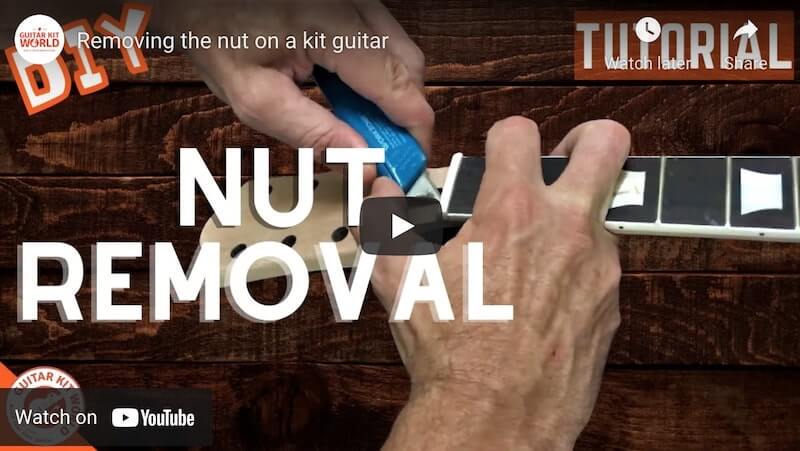

How do you remove a glued guitar nut?
Removing a Standard Nut
The video below shows how a standard plastic nut was removed on a E35 kit guitar. As you can see, a great deal of force is not required. Instead focus on breaking the seal between the nut and glue using a razor blade.
In most cases only a small amount of glue is used, and while it may feel like nothing is happening, if you continue to work at the seal with the blade, the seal will break, resulting in a popping sound and the nut coming loose.
