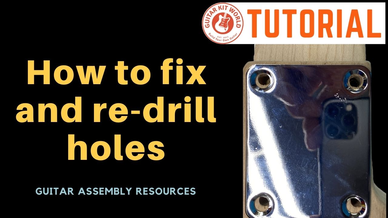

Having issues installing the neck of your bolt on guitar kit? Is it misaligned and not lining up with the holes of your backplate? We have gathered good resources you could refer to if you are encountering these problems.
1. First option is to use dowels and drill the holes again in the correct position.
This method not only applies for neck alignments, but generally to any hole that you need to fix, improve the positioning, stripped out, and resize.
