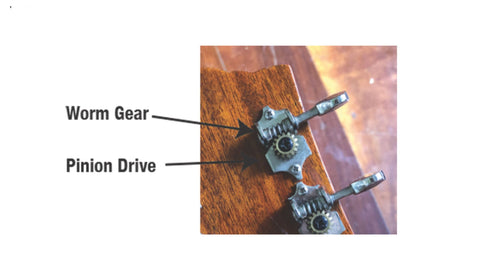

They do this by utilizing a worm gear and pinion drive mechanism. When you turn the tuning button, it rotates the worm gear, which then drives the pinion gear which controls the tuning post.Ā
This allows you to wind or unwind the string, increasing (raising the pitch) or decreasing the tension (lowering the pitch).Ā

Open-gear tuners expose the gears of the tuner. This means you can see the tuning mechanism (worm gear and pinion drive) in action when tuning, unlike sealed gear tuners which are enclosed in a metal casing, as per the example above.Ā
