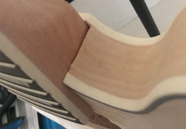

a. Neck heel wiggles side-to-side in the pocket.
b. Visible gaps along one or both pocket walls.
Loose Neck Pocket
c. Strings don’t run evenly along fretboard edges (neck appears shifted).
d. Pickguard/pickup/bridge alignment looks skewed relative to the centerline.
