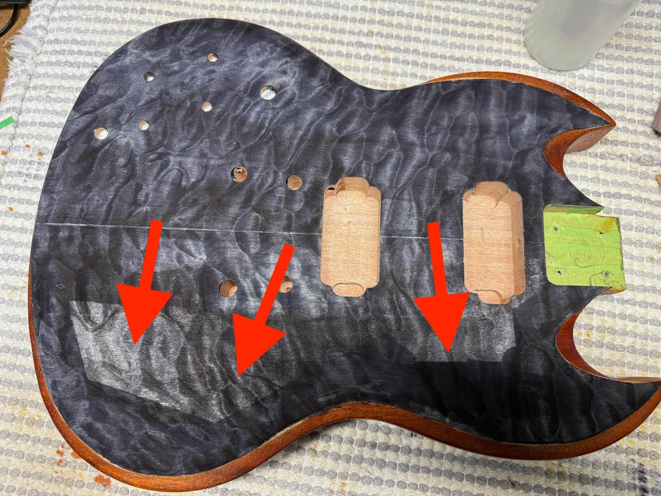

Glue Bleed-Through
Glue bleed-through has a few tell-tale signs once a finish is being applied:
Image courtesy of builder Mike Rego
  • Hard, defined edges: Glue-affected areas of the veneer tend to have relatively sharp edges. The transition from coloured to uncoloured veneer will almost look deliberate, as if it’s been masked off.
  • Shiny, or reflective quality: Under angled light, especially, glue spots often appear glossier/shinier than the surrounding veneer, even after sanding.
  • Pattern follows pressure/glue spread zones: The shapes created by glue bleed-through aren’t usually the same as random grain features or contaminants in the finish. As they are most likely caused when the glue was pressed through the veneer during factory lamination, you will tend to notice them more near routed areas and/or where pressure and squeeze-out are highest.
