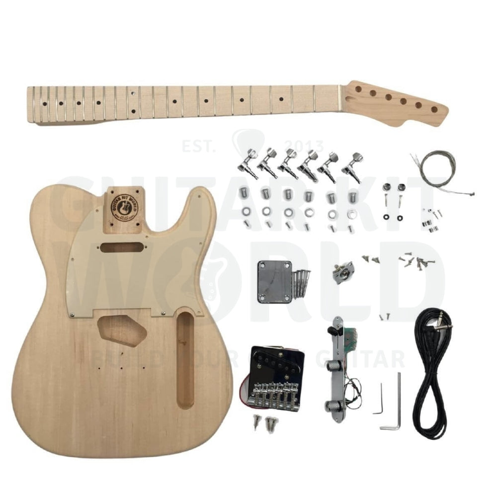

A custom guitar for beginners starts with a DIY guitar kit. Kits include a pre-shaped body, neck, hardware, pickups, electronics, and step-by-step instructions. You supply the finish and basic tools. No woodworking experience is required. Most first-time builders complete their guitar in 15 to 25 hours spread over a few weekends, spending 250 to 400 USD total including the kit and finishing supplies.
If you have never built anything more complex than a shelf, you can build a guitar kit. The body is already shaped. The neck pocket is already routed. The holes are already drilled. Your job is assembly, wiring, finishing, and setup. This guide walks you through everything a beginner needs to know before starting their first custom guitar.
