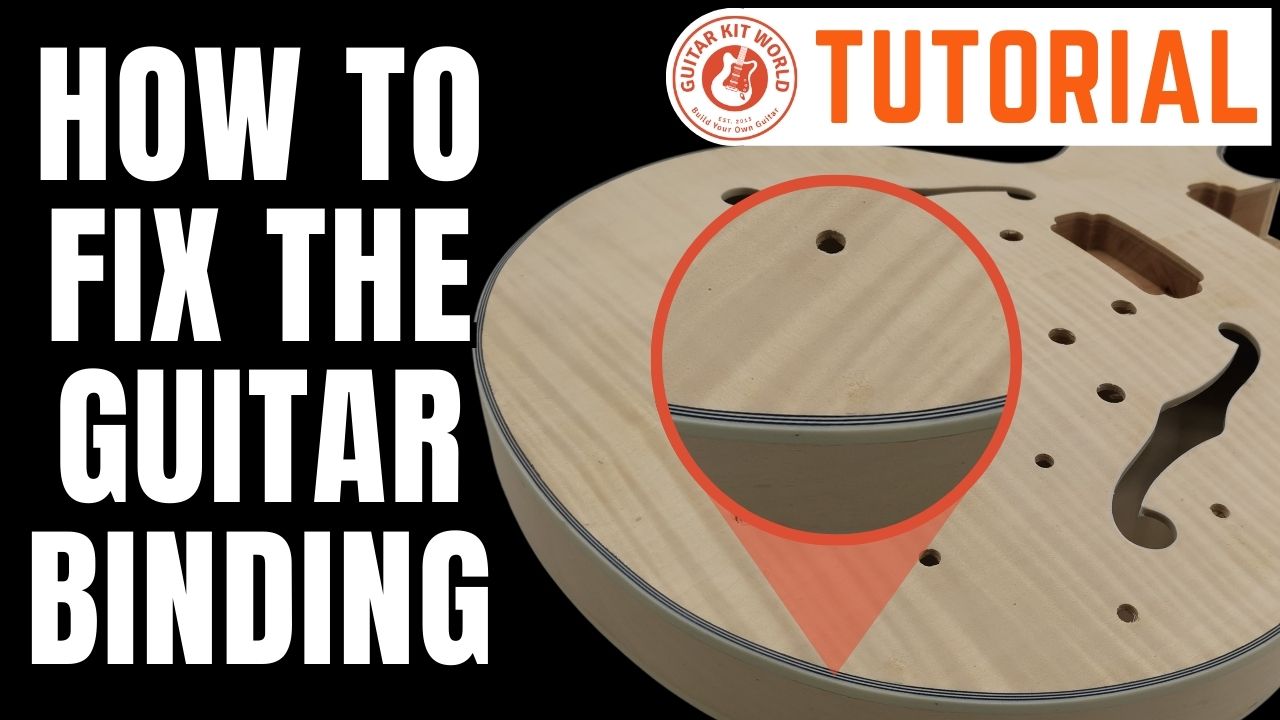

Guitar binding is a decorative strip that covers the edge of the guitar's body, helping to protect it from damage and improving its appearance. Over time, the binding can become loose, cracked or damaged. If this happens, it's important to take action to repair the binding, otherwise it could lead to more serious problems.
In this guide, we'll walk you through the process of fixing the binding on your guitar using a heat gun. This is an advanced repair technique, so it's important to proceed with caution and follow the steps carefully to ensure that your guitar is repaired correctly.
Make sure the heat gun is set to a low temperature setting, between 200 and 300 degrees Fahrenheit.
Ā
Step 2: Apply heat
Apply heat evenly and consistently to the binding, moving the heat gun along the length of the binding.Ā When fixing the binding of a guitar using a heat gun, it's important to keep the heat gun at a safe distance from the guitar to prevent damage. As a general rule, it's recommended to keep the heat gun about 6 inches to 8 inches away from the binding.Ā
Step 3: Use a plastic scraper
Use a plastic guitar binding tool/scraper to carefully press the binding back into place, taking care not to burn yourself or damage the guitar.Ā
Repeat this process until the binding is securely in place.
Step 4: Let it sit
Allow the guitar to cool down completely before playing it or making any other adjustments.
Note: This is an advanced repair technique and should be done with caution. If you are unsure about how to proceed, it's recommended to seek the assistance of a professional guitar repair technician.
