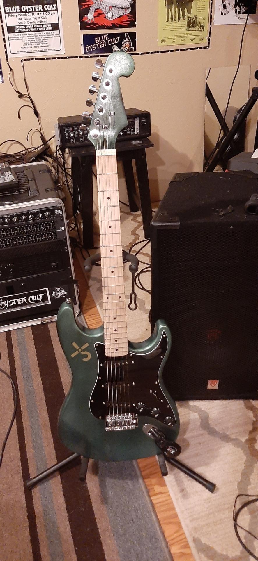

Customer-built ST-style guitar kit in dark green metallic finish — a completed DIY guitar kit build from Guitar Kit World

Customer-built ST-style guitar kit in dark green metallic finish with silver sparkle headstock — a completed DIY guitar kit build from Guitar Kit World — Built by a Guitar Kit World community member.
