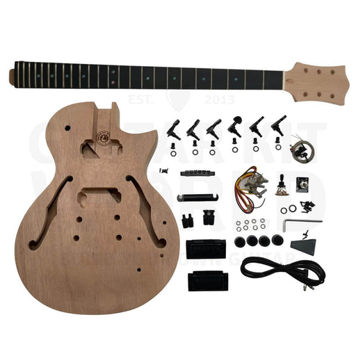

What to keep in mind if building your own baritone guitar
Building your own baritone guitar kit can be a good alternative to buying a ready made baritone guitar as they can be expensive, difficult to come by, and under normal circumstances are used less often than a standard electric guitar.
While some guitarists have opted to merely replace the neck on an otherwise standard electric guitar, this kind of approach needs to be considered carefully with regard to neck stability. Not to mention sourcing a replacement neck that matches the existing neck pocket and neck profile taking into account overall thickness and neck radius.
DIY baritone guitar kits
If building from a DIY kit, there really isn’t a lot of difference with regard to assembly. If you have experience building your own DIY guitar kit you won't need to change your process or use additional tools however, there are some practicalities to keep in mind:
- If replacing the stock pickups consider articulation as a priority. Pickups that have a reputation for sounding muddy and less articulate will only sound more so on a baritone guitar. The extended neck tends to initiate more bass and mid-range response, especially when taking into account the lower tunings and frequencies produced.
- Baritone guitars are a little heavier to move around when working due to additional reinforcement of the neck and the additional length adding more weight.
- While none of the points mentioned above, with the exception of the pickups are major considerations, it's also worth remembering that due to the increased scale length, fret spacing is also wider and may take some getting used to, especially if you do your own fret work.
